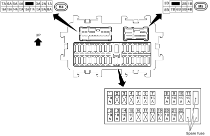

Review of my 2003 coupe service manual, shows that fuse location to be Fuse #22. My service manual shows an X on that fuse, meaning that it is not used. I can only speak for my year model and what I am seeing in the manual. I have not looked at the fuse block in my coupe to verify if there is a fuse in that spot. Is there a fuse in that spot on your vehicle? What year is your vehicle? Take a picture of your fuses in your box and post it.

I took a picture of my fuse box cover, I also verified that there is a fuse in each of the locations depicted. As you can see in my attachment, there is a difference between our covers .

Inquiry minds want to know, I joined nicoclub to get access to the service manuals. Attached you will see the Fuse Block layout for the 2006 and the 2003 Coupes for comparison. Both layouts show fuse position #22 with an X. Was Infiniti thinking AWD for the 2006? , One thing is for sure a fuse is not installed in this position from the factory. Is there a harness connection there? . In any case I believe this mystery is solved.
