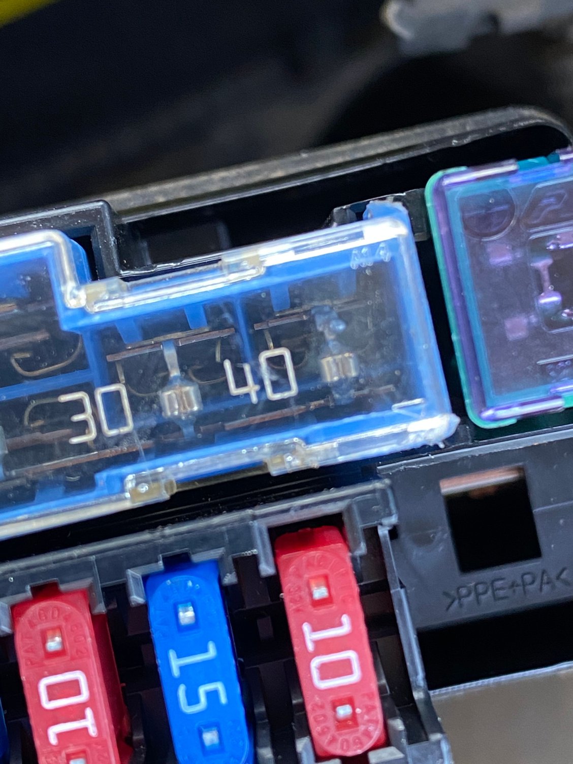

G35 Coupe K23
My fuse blew and now it formed a weird bubble on top.
I changed the whole L fuse and the other fuses work besides the 40amp one as it didn’t blow apart instead it formed a weird bubble shape on top and I don’t know how to approach this.
