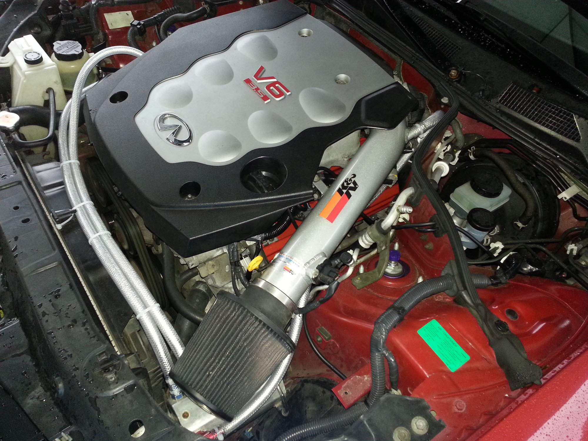

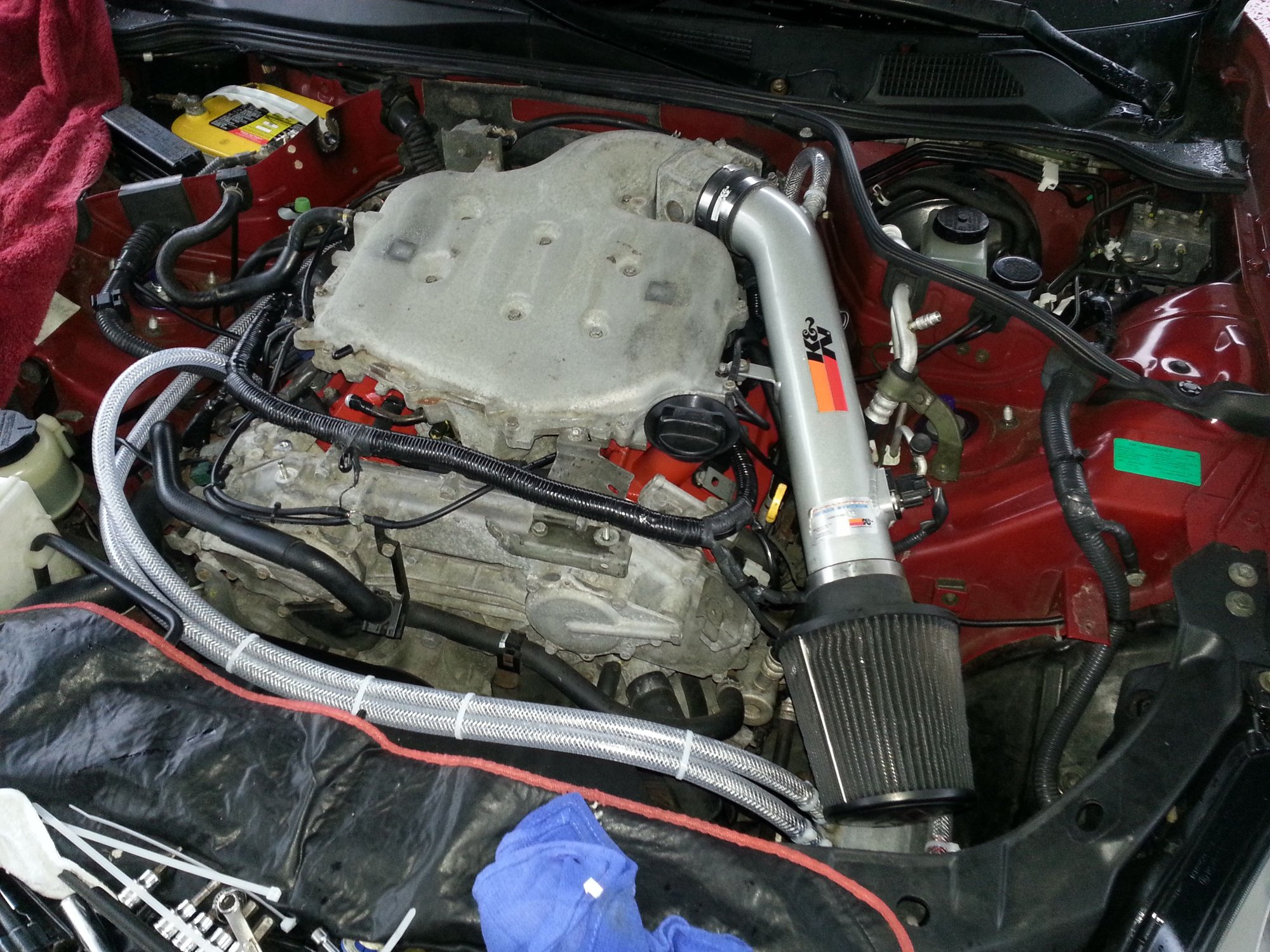

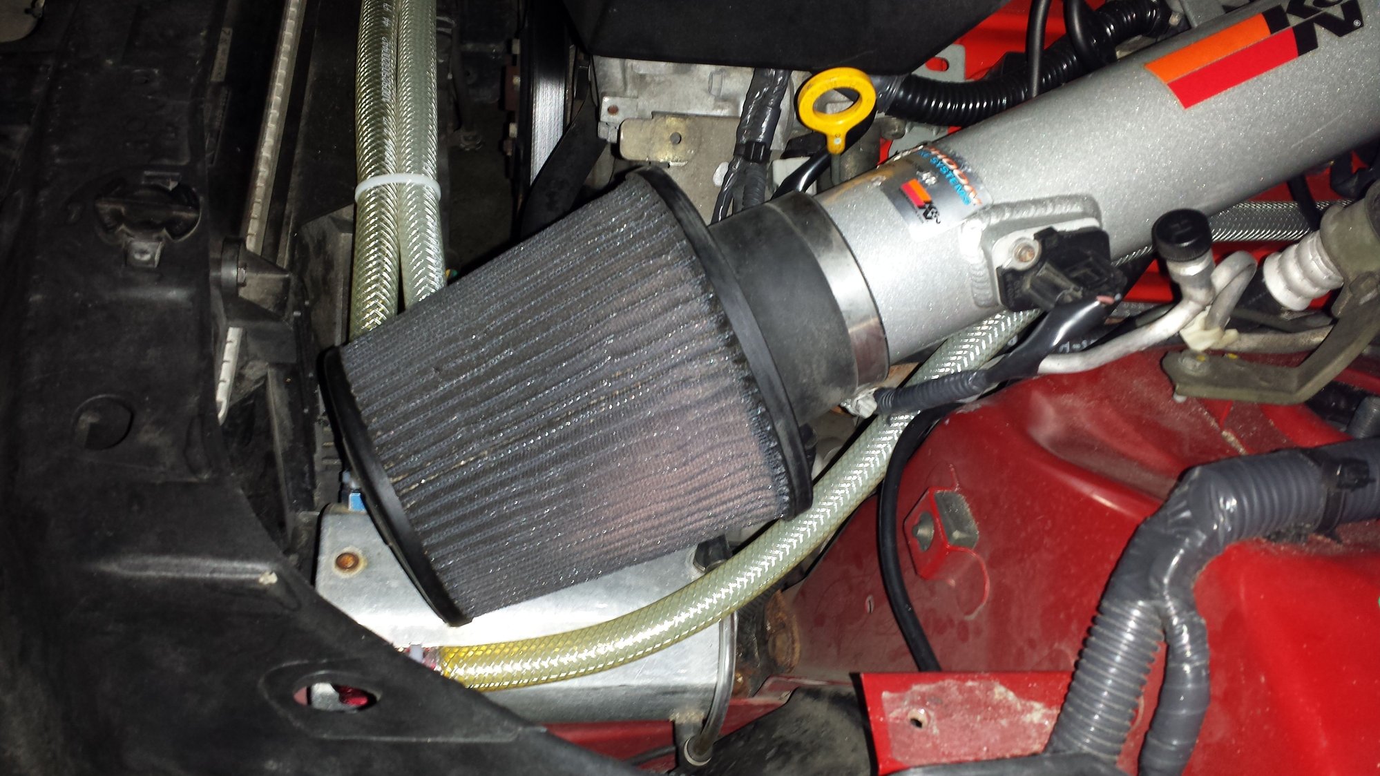

Here is mine. Old GReddy catch can. Driver and passenger valve cover ports into one side. Single hose out to intake. Closed system.
I need to do some work on it however. I emptied it out a few weeks ago and took a lot of nasty oil condensate out. I need to create a divider between the inlet ports and the outlet port. I'm seeing that condensate being pulled straight thru the can and into the intake. May also play with a restrictor on the line out to the intake.

There ya go

I agree. Baffled catch can is essential for a closed system. Goal is to keep oil out of the intake manifold. In the long run, your valvetrain stays clean and so does your intake tract for long term performance. I do advise swapping the PCV One time if installing to eliminate any problems that may come down the road.

I put a new pcv in at the time I built this system. I do need to install some baffles somehow though. Or at least some stainless steel wool as a strainer for the while till I get it baffled.
I noticed a lot of oil vapor residue on the inside of the plenum when I installed my spacer last week. I think I may buy some more new hose and reroute the can. Maybe move it to the other side of the engine bay.

so why did u not run the outlet to the manifold port?
