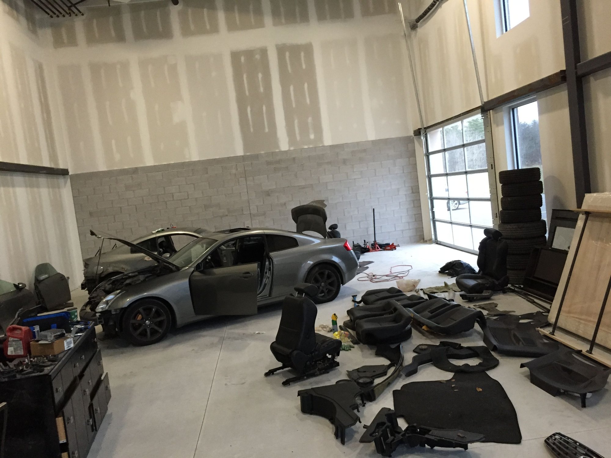

Sweet garage/shop space you have there! Do you own that or is that something a buddy is letting you borrow after hours for your project?

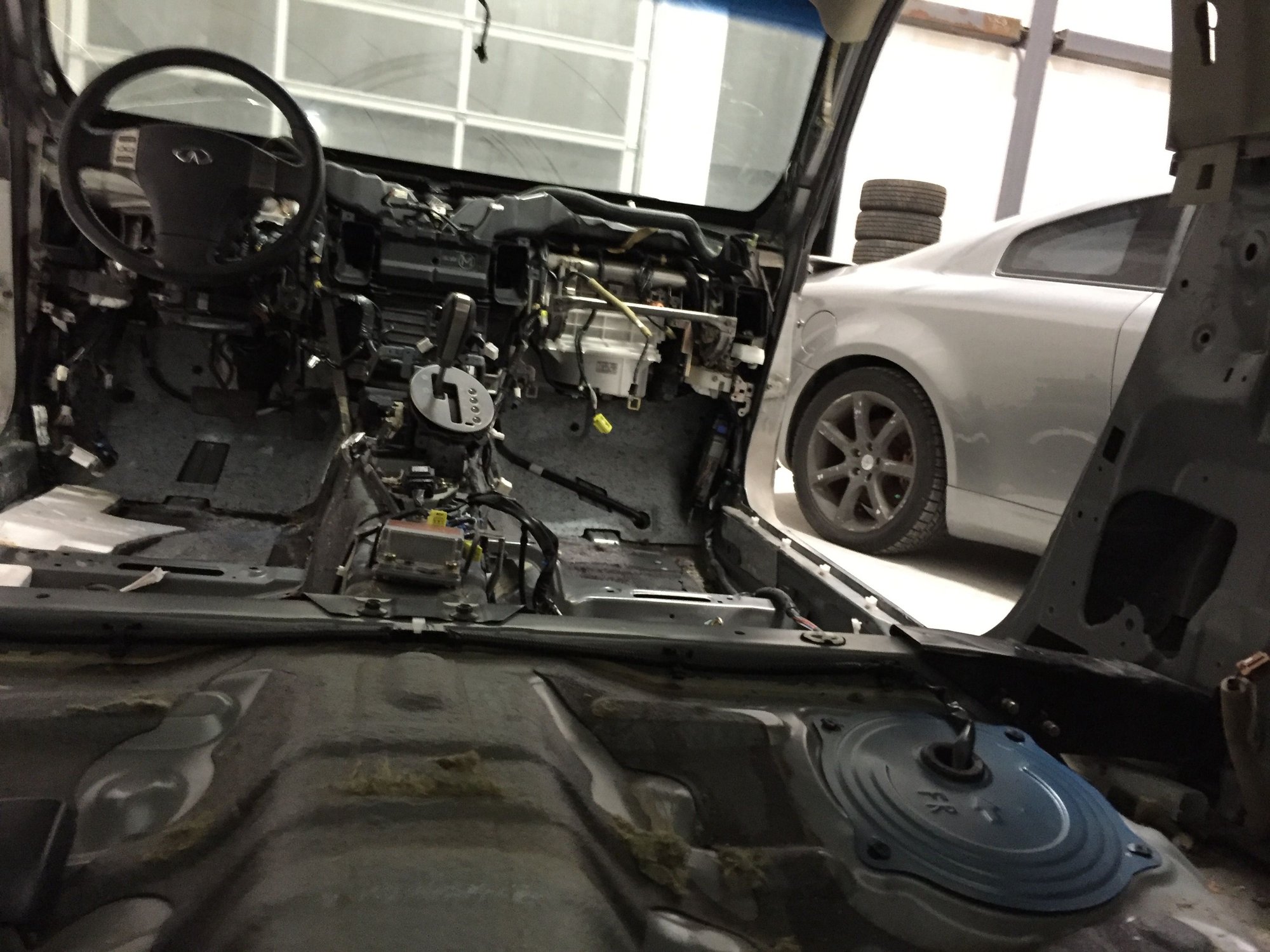

Just built a brand new industrial warehouse for investors, now have it for lease so figured I would take advantage of the space while I can, that is why I picked up these G's!
Unfortunately when I received the donor car all we could do was scan for codes (none came up) and when we turned over the engine it ran but only for a few second and shut off. Everything was disconnected from the front end because this car was a write-off from an accident on the side then someone bought it for the entire front clip then I bought it for the engine. The guy who took the front clip told me it was running fine before he took the front clip, my shop looked it over and said there shouldn't be an issues the engine shutting off may have been because of everything disconnected/ (safety feature)? No codes was a good sign. I am no mechanic so I figure they are making the right judgement call but I am guessing if this engine has problems it will be no where near as bad as the other car (timing chain is off and bouncing around in the engine is what I was told? You can hear a lot of clunking if car is turned over).
