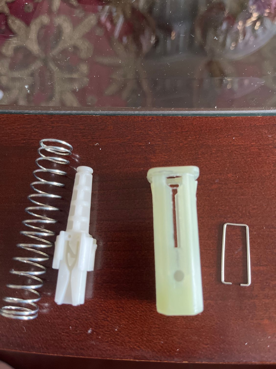

No replacement part needed - easy fix
After removing the spring assembly, I found a metal clip/latch on the bottom that was unlatched. After latching it back into place, the spring assembly worked perfectly. Apparently this latch holds the spring in its closed position and releases it into its open position. So if this problem happens to you, be sure to check this latch before buying a replacement part.
PS: I am not mechanically inclined and this was super easy and took all of 3 minutes. All you need is two small/thin flat heads to release the spring assembly.

G37 coupe Journey
Could you tell me where the latch should be placed ?
I have the exact problem. Could you tell me where the latch should be placed ?
thanks
