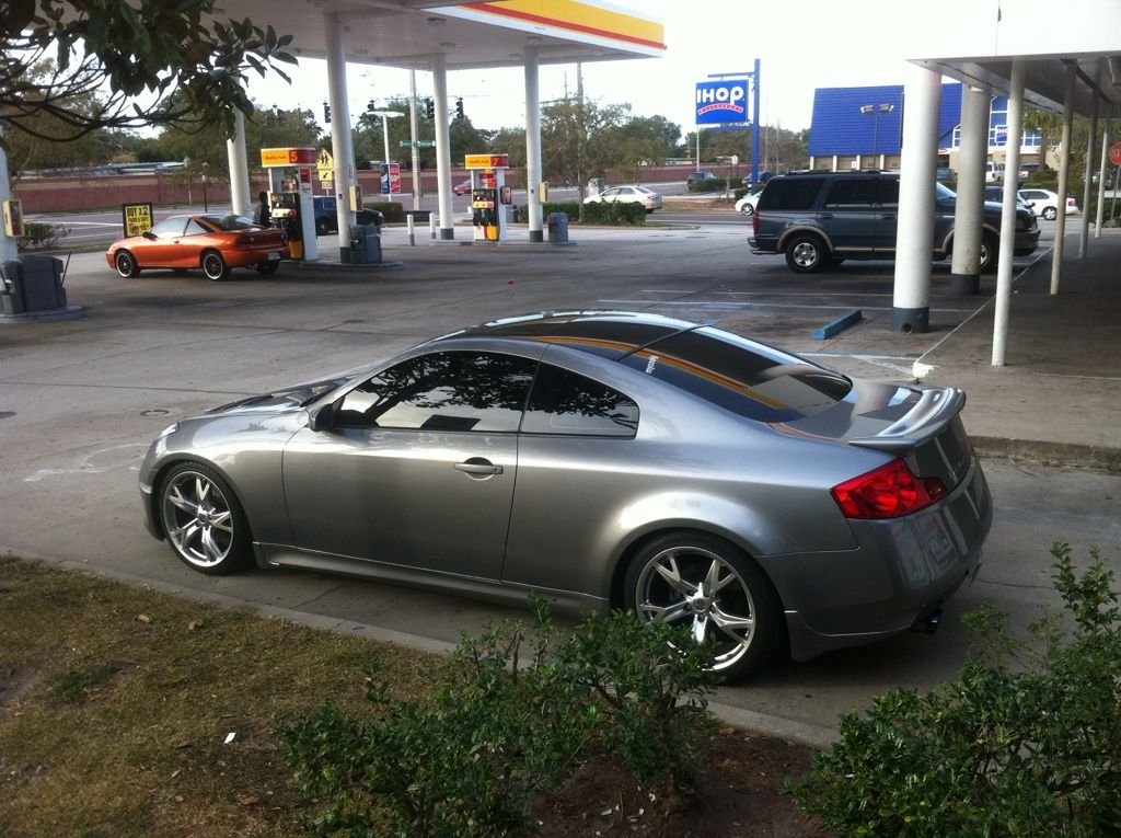

I saw this coupe on a thread and I was wondering what wheels these were?
These really look nice on a G.

These are the O.E.M Rays wheels that come off of the Nissan 370z.

370z sport/anniversary wheels.

You'll need to run spacers up front...+47 offset if I remember correctly

Is this a picture of your car with them ?
After researching them just now there are 2 sizes 9" wide front 10" wide rear.
What size spacer to clear caliper up front I guess.
I also wonder about tire size.
Funny with all the wheels I have thought about I spy a set of nissan oem's that I like.

they dont "need" spacers but most add them since the offset is higher compared to the rear. They clear oem akebono on the 370z so brake clearance isnt an issue.

It really isn't about comparison to the rear, for a G to fit that high of an offset it will need spacers or rub the strut...offset doesn't determine clearance either.
How can it rub the strut if the spindle is in front of it? Rub the spindle maybe.

Definitely had the rear in mind as I typed front...spindle is correct lol
