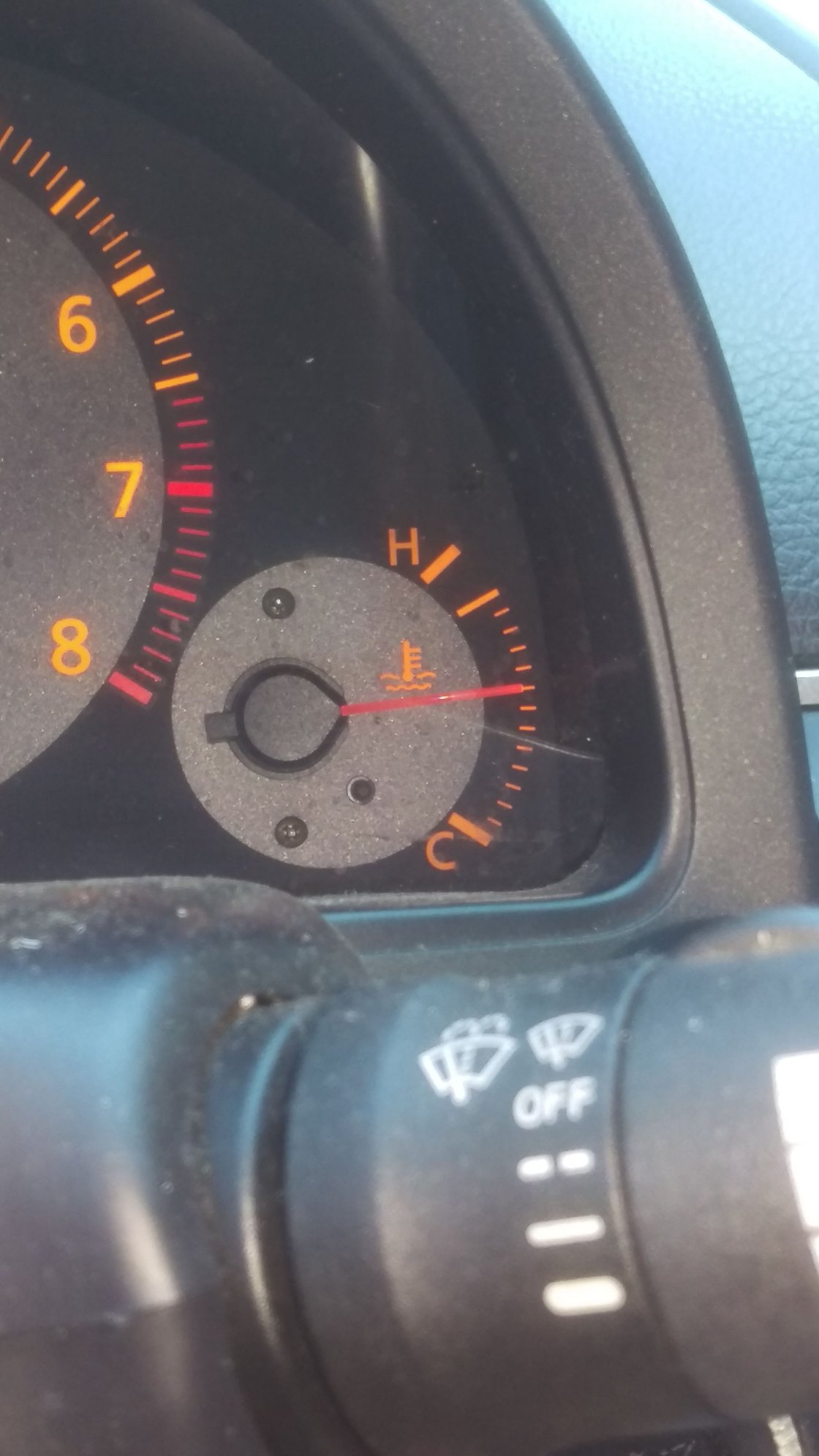

I have an 04 g coupe 5at with 153k that I have owned for 4 years now and never had any problems besides general maintenance. Yesterday on my way to work i was doing about 65mph down the highway and hit a piece of 2x4 wood in the road. Everything was good i got to work, went to leave work 8 hours later and i drove about 20 miles back into town and my cooling fan was running super loud. I thought to myself surely it hasnt always been this loud so i went to bed and got up today for work and started driving about 5 miles into driving at 40mph i came to a stop and heard it running super loud again, got to a redlight about 15 minutes later and sat there for a minute and the temp gauge went above normal but not into the red where i should really be worried, it went roughly 3 marks above the dead center of the temp gauge. Also, idk if this will help but the air condition was cranked almost all the way up when this happened. I still have heat and i tried to recreate the overheating by just sitting at idle but couldnt get it to budge.
I checked all of my fluids and everything is full, im stumped on what it could be?

Both of my fans are spinning at full speed with ac on and off but it only overheated once with ac on full blast and it wasn't really over heating just running a bit hot at idle in the shade at 86°f. I turned the air off and revved the engine a few times and it dropped right back down to a little below the normal Mark. Hasn't moved back up and it's been sitting idling for 20 minutes now.
