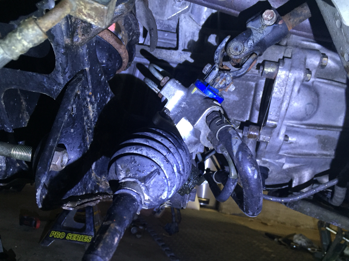

Old Feb 8, 2017 | 01:32 PM
Urbanengineer's Avatar
Joined: Jun 2013
Posts: 11,174
Likes: 1,045
From: OH-IO
This is the part in question (above the blue seal), the U-Joint.Steering Shuddering-photo559.jpg

This is the part in question (above the blue seal), the U-Joint.Attachment 177643
Make sure nothing is bent and everything is properly aligned.
Old Feb 12, 2017 | 08:52 PM
Joined: Jun 2013
Posts: 11,174
Likes: 1,045
From: OH-IO
^Agreed! Thanks for the share guys.
