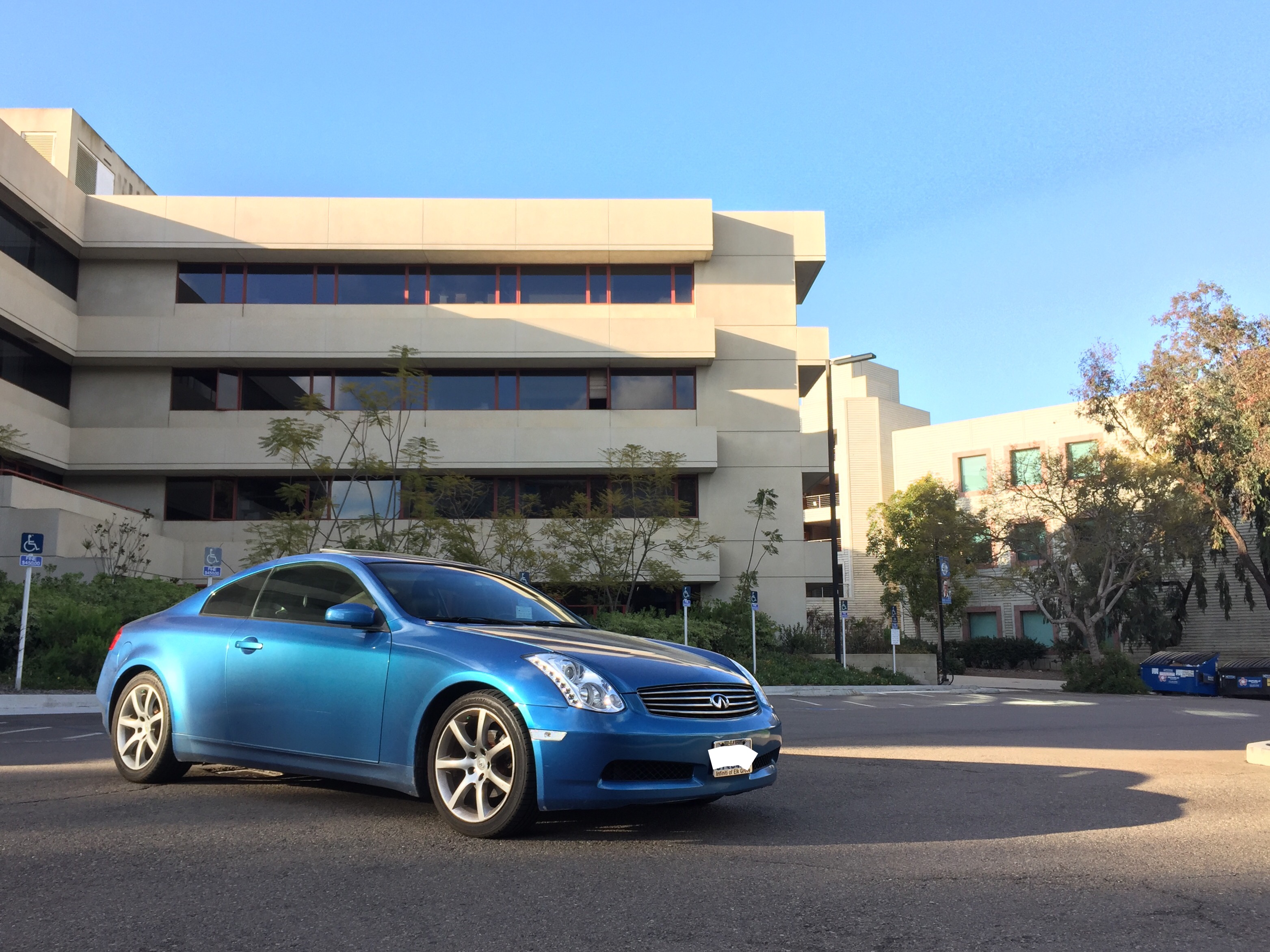

Hey everyone,
I've had my 2003 G35 Coupe for about 6 months now, and I kind of want to start doing some small mods just to add a little bit of extra flavor to her. I was thinking of either installing a spoiler, side skirts, or a Stillen Z-tube intake kit for the sound. What would y'all recommend I start with first? Any advice is appreciated. I just started getting into this kind of stuff pretty recently, so I do take difficulty of installation into account.

If you want sound, get an exhaust.
IMHO, skip the cone intake since 1. It sounds like crap. You may have heard someone on some forum talk about how amazing their intake sounds, but the truth is it's an annoying sucking sound. 2. They don't necessarily make power. In fact, you may lose power where you normally like having it.
Open up your exhaust with a nice cat-back system. If you don't want your car to be too loud, then go for Stillen, Nismo, or Borla. If you want loud, there are plenty off options for that. If you don't want to spend a lot of money, you can look for a used exhaust system in the classifieds.
If you want looks, IMHO, skip the side skirts and get a front lip. Add side skirts to the front lip but side skirts alone are not going to look good. If you have black plastic somewhere and you don't like it, paint it.
If you want looks, you should seriously consider dropping your car with lowering springs and new struts. There is no single cheap mod more dramatic than a drop with lowering springs, but you will want new struts and a camber and toe adjustment kit with that. Bodywork can make a huge difference but your car will still look dumb if it is kitted but not dropped.

Drop it, tint it, add a trunk lip spoiler and a chin spoiler. Bingo! It's very easy to make a G look good!

Wow! Phoking tj, that's a sweet looking coupe! Before you start spending $$ on modifications to the beautiful coupe I want you to read the First Mod sticky at the top of the coupe page along with a few others! Since I've been here the best mod has always been Motordynes 5/16" spacer! That's a mod you can actually feel in the seat of your pants the minute you nail the throttle. Lowering isn't a cheap mod, the best way to get an adjustable suspension so you can get the perfect profile is with "Coilovers!" BC coilovers have been the most popular ones to install for a long time! Lowering must also include adjustable suspension parts to bring your alignment back to OE specs, SPL kit and a few others are available thru our Marketplace under vendor suspension! Then you'll need to find a alignment shop that has the ability to correct altered suspensions. You're looking at $2K just to get your coupe lowered and drive it so you're not buying new tires every 10K miles...or less! I've given you enough information to ponder for now, enjoy that beautiful coupe and the ride!
