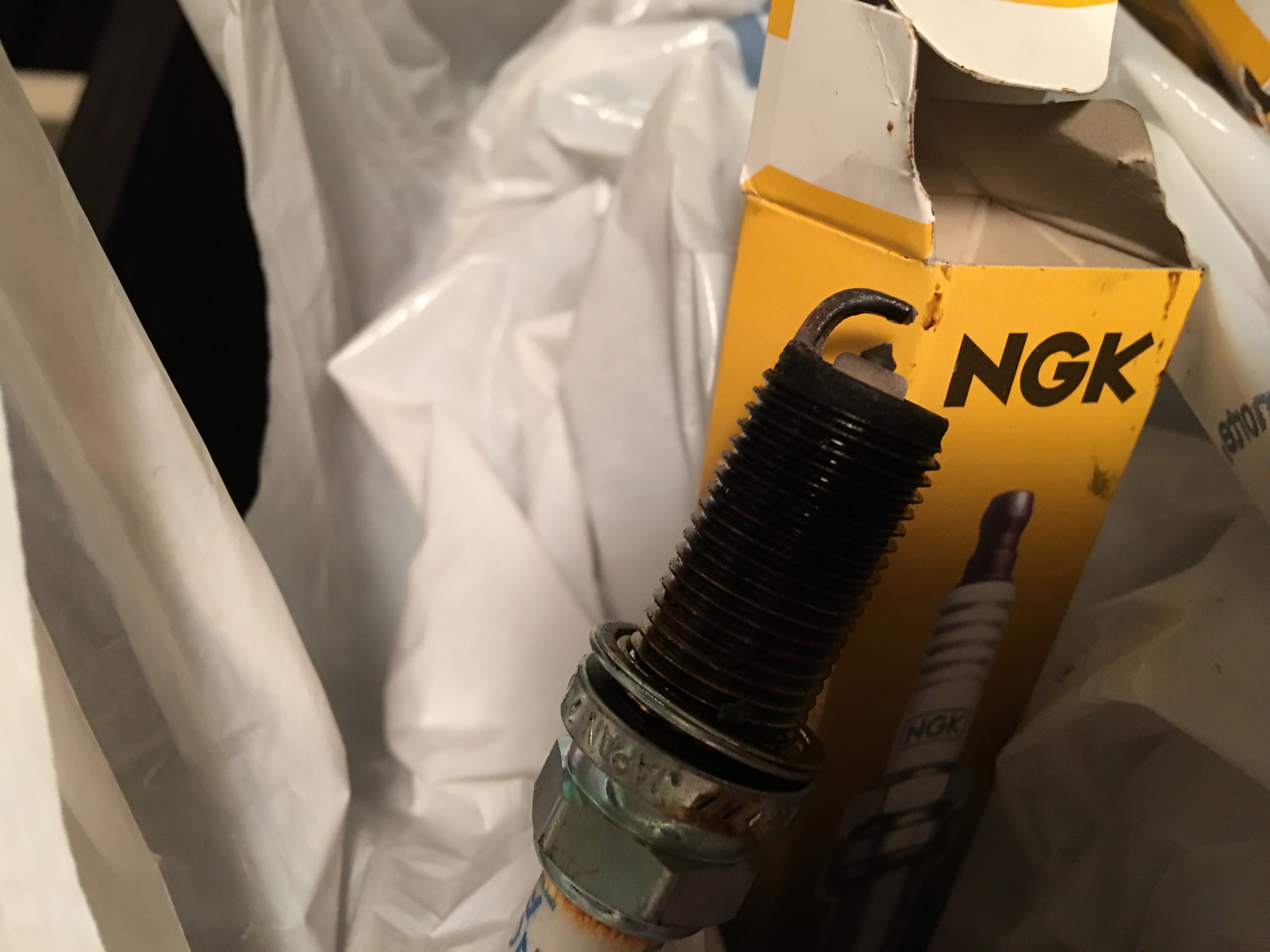

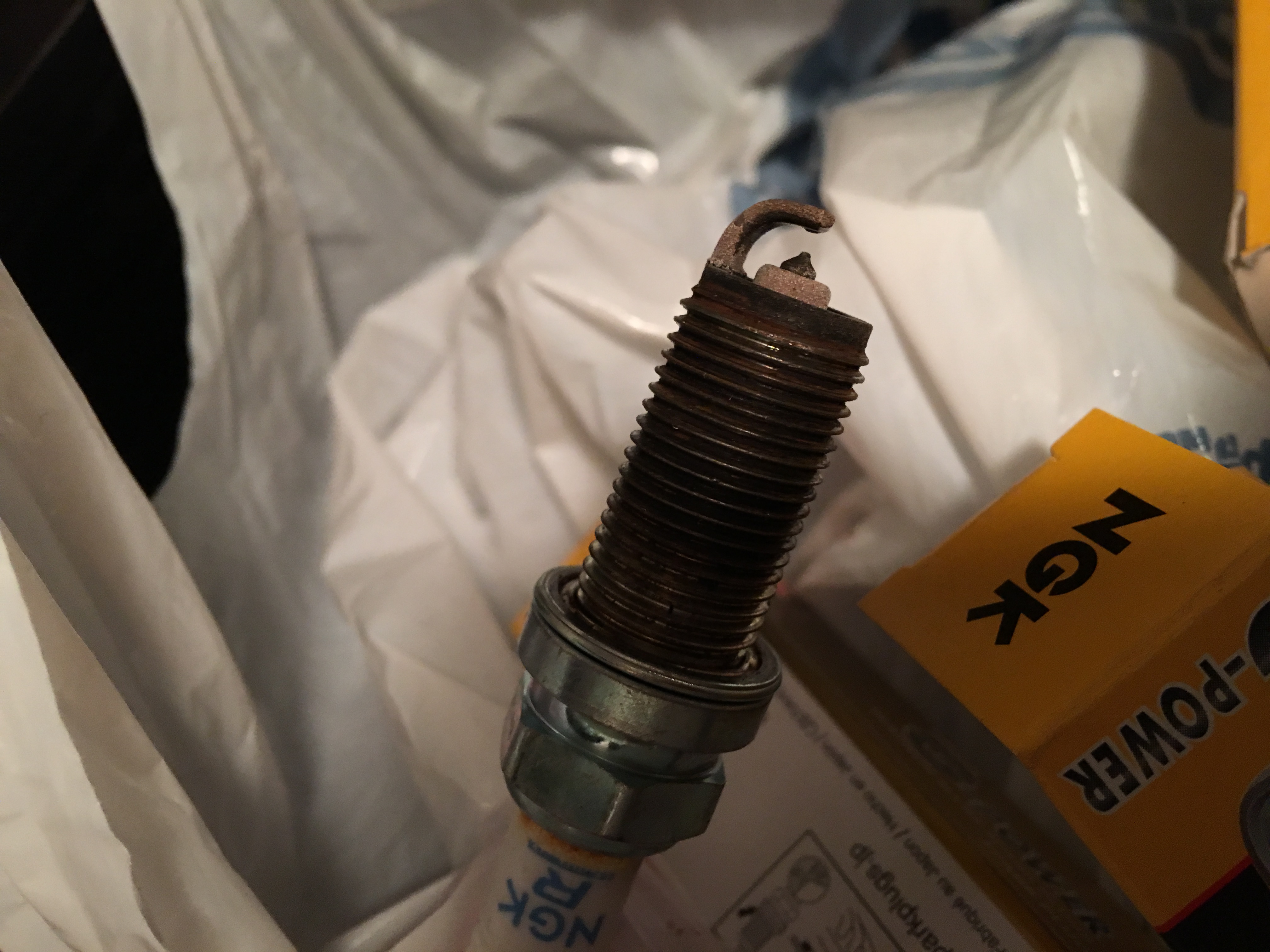

Before changing my spark plugs, I had very bad hesitation. I'd floor the gas and it would take quite sometime for it all to register. The loss of power/hesitation has now been solved, or so I think. Slightly tapping the gas makes the car fly.
I'll attach a picture of my old plugs to show how bad they were... Now to my situation. I changed my spark plugs due to having HORRIBLE gas milage. I'd be getting around 120 miles (190 kms) on a FULL tank of 91... The harder I drove, the less. Keep in mind, I would never floor it. I'd keep my RPM's under 3,000, but still horrible mileage.
Now, after changing the plugs, I filled up and have driven about 75 miles (120 kms) on this tank and I'm about 3-4 ticks away from half, so looks like the new plugs helped a bit, but I really don't think I'll even hit close to 215 miles (350 kms) on this tank...
