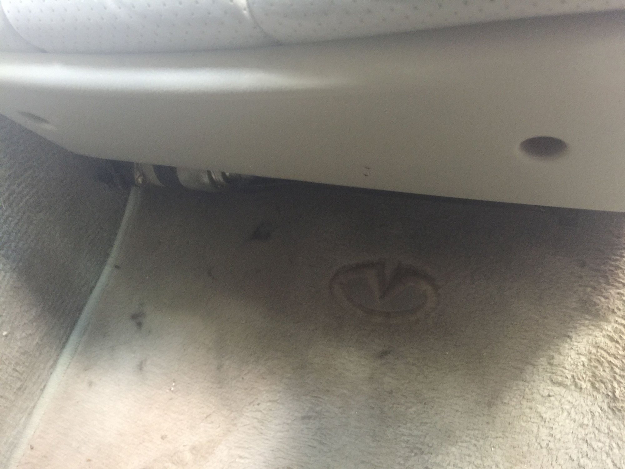

So in this first picture, you can see the seat is situated all the way up, there is no way i can slide it back

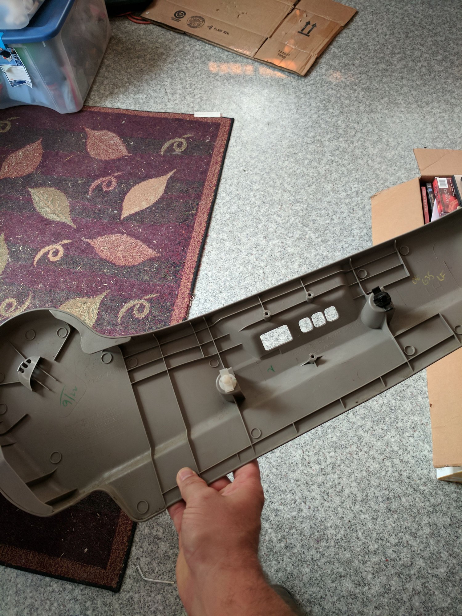

The second photo shows the plastic trimming in on the driver seat

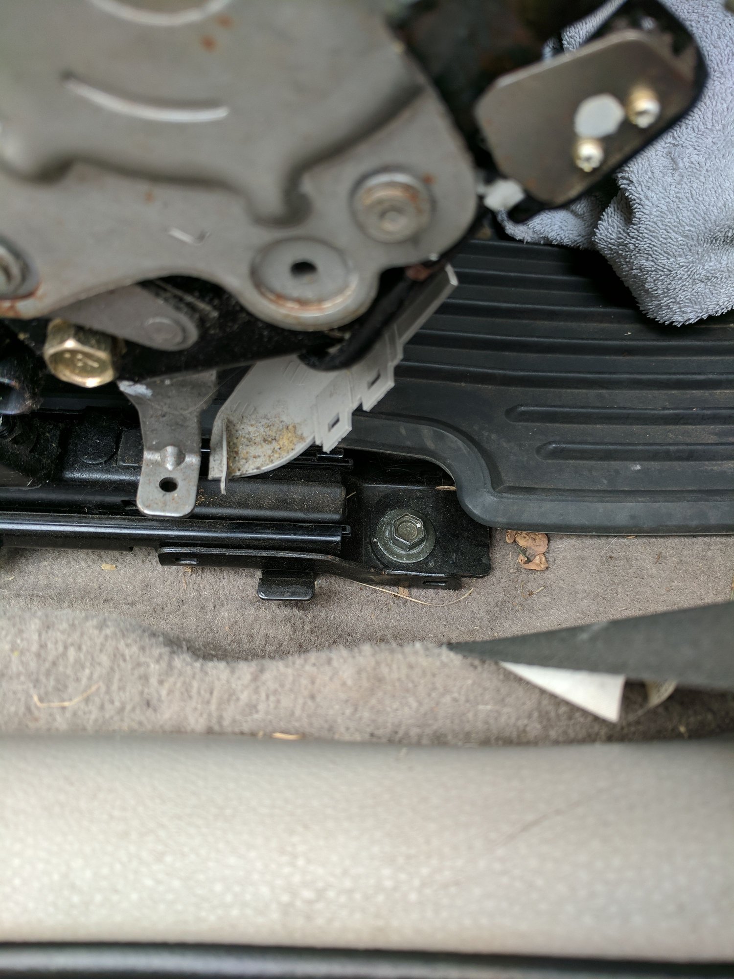

as you can see here, the bolt to the front is completely encased by the seat, since i cannot move the seat back this puts me in a jam
just showing the front bolts and how its slid all the way forward

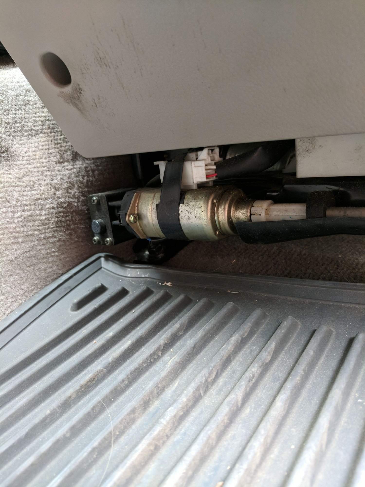

I'm pretty sure the drive motor you're looking for is the one mounted under the front right side of the seat. I can see mine when looking from the front, connector is accessible (motor too) by removing the plastic trim.

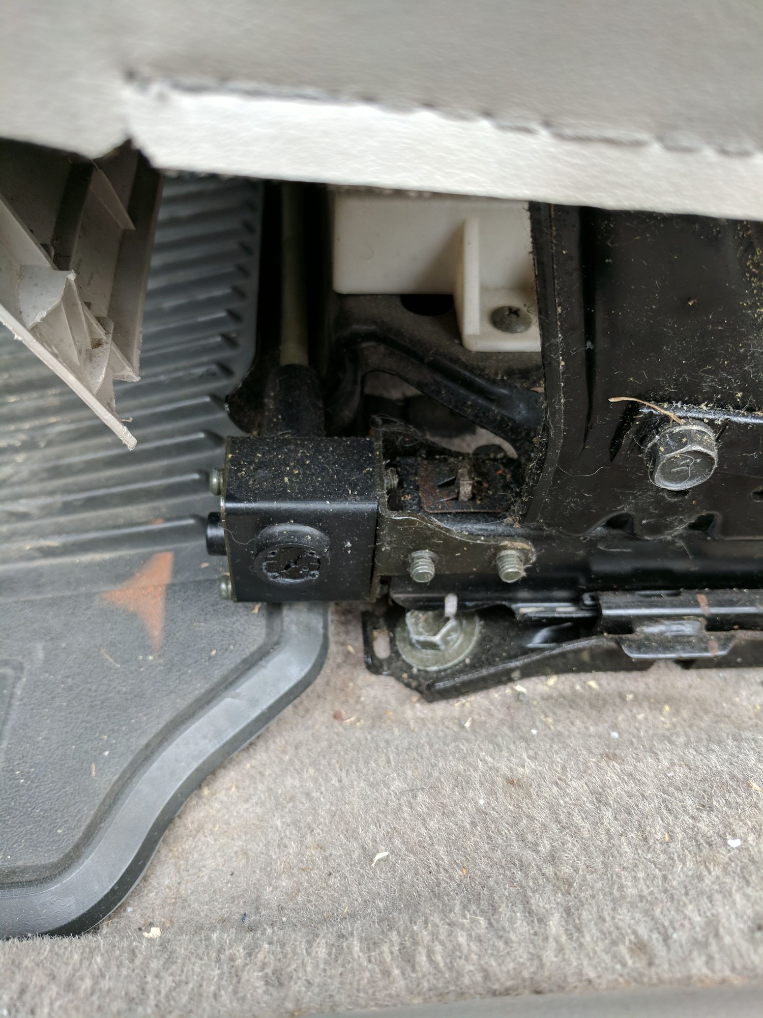

Also, here are a couple other views so you can see where the bolts are is you want to continue down that path.
Here is a shot of the backside of that plastic trim on the side.
Hope this helps.

Yeah, if you remove the motor I think it's a 10mm to move the worm drive and you need to alternate sides, gotta do them independantly.
EDIT: Someone made a youtube video here, that way you can see what it takes.
