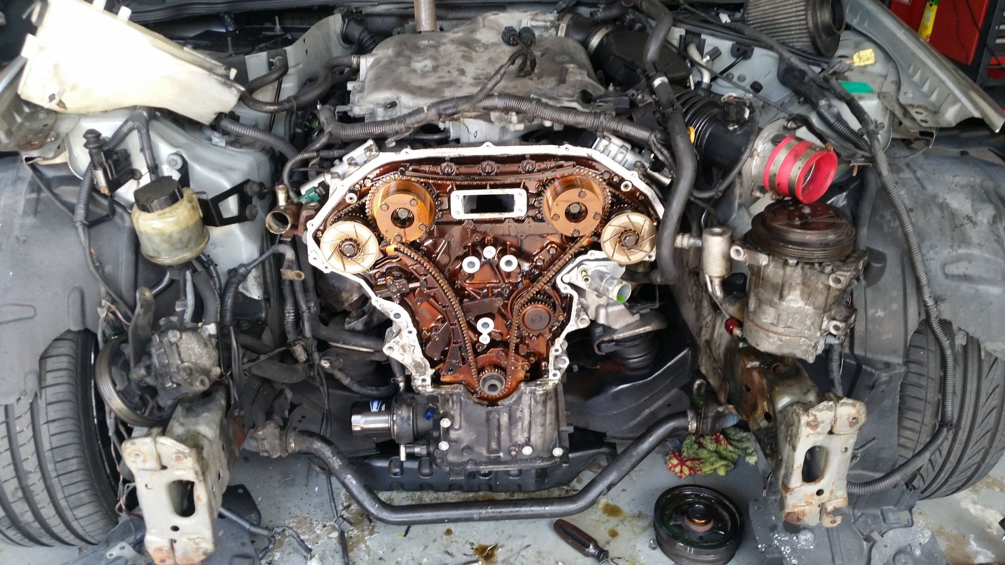

Hey, that's a pretty neat game of Legos you got there. Of course I have a hard time believing you were the head-engineer on that buuld (especially cuz you haven't grasped the concept that an internal combustion engine is an internal combustion engine), but I'll give you the benefit of the doubt, as it's not that hard, it's just a lot of work.
Anyway, back to the VQ, did you want me to come fix your car for you or...? I'll have it up and ready in a jiff'

Again, I've fixed everything myself on this car including taking apart the whole front of the engine to replace the rear timing cover gaskets, which was throwing the horrid p0021 code and was infact causing my low oil pressure... and also replaced the timing chain while I was in there..
If you want to know what the inside of your timing cover looks like since I'm sure all you've done is change ur air filter, then here's a pick of mine...
Cam sensors were a joke to replace, all extremely easy, problem was I replaced with shitty china ones, not knowing this car is super sensitive apparently.
Replacing my fuel pump... also easy, only cuz at 157k miles, it was going to need one eventually.
The car always had spark, always had fuel pressure, and after replacing everything..no codes were thrown... so I was thinking something specific to VQ engines was going on and thats y I started this thread.
