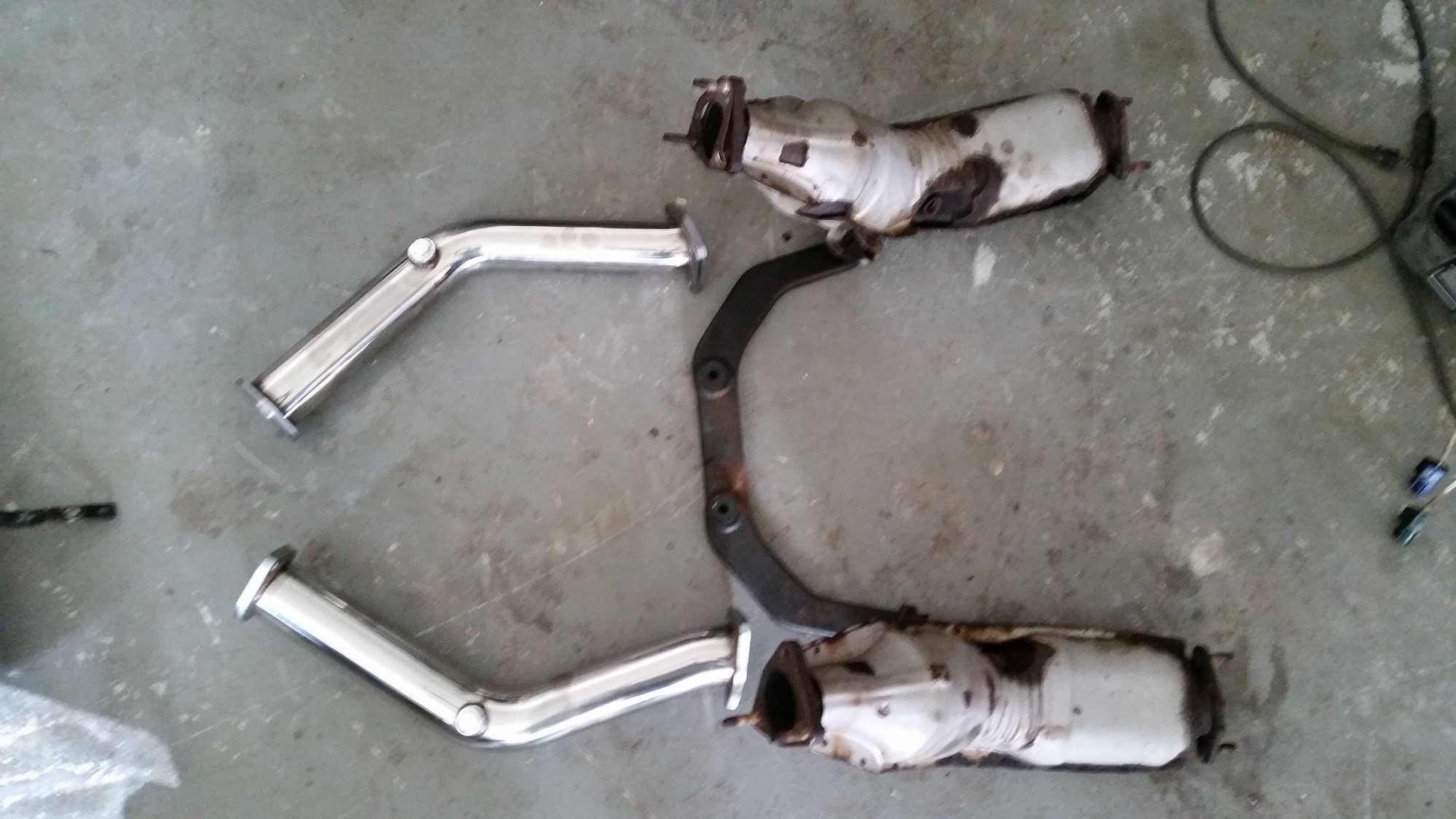

Out with the old, and in with the new... I must say, this has been the easiest cats removal I've ever done. Now I just have to install the delete pipes and change the cam sensors to the oem ones.
I might cut up the old cats and take a look inside.
Hopefully I'll be loving the car again in a few.

From my experience, by the time it gets bad enough to be affecting performance you can just LOOK in the ends of the cat with a flashlight and see the melted spots.
