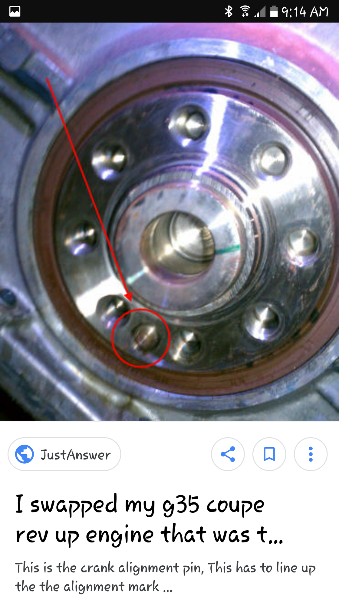

I'm leaning towards misalignment of the flywheel honestly but if it were me I'd toss in an OEM cam phase sensor just to rule it out and also ensure it won't fail for another 100k or so. Did you ask your mechanic specifically if he got the alignment pin to match the flywheel perfectly? You probably haven't gotten the rpm's up very high on it anyways due to the clutch break-in time so you wouldn't even realize that it's missing the entire upper rpm band.

They need to remove the clutch and reinstall the flywheel correctly. There's a bunch of threads of people with the same sensor problems after installing a clutch, the cause is an incorrectly aligned flywheel.
My crankshaft didn't have a pin sticking out, so I had to look to make sure the flywheel was installed correctly. Some engines have the pin sticking out, so it's impossible to mess up.

Yes OP I too own a 2006 6MT and I can verify that my pin was NOT sticking out either so it would be completely possible to have it installed wrong, just have to visually check your work and look through that hole to verify you did install the flywheel correctly.

Thank you everyone for responding. I did as most of you recommended and decided to drop the trans and take a look at the flywheel that was put on. To my surprise the pin was there and it was aligned on the dowel pin in the crankshaft. Blew my mind and I wasn't too sure what else to do since that's the only thing that changed between no symptoms to now symptoms. Luckily I still had the old burnt dual mass flywheel and decided to compare the 2 on a flat surface. I found out that the teeth the crank sensor reads were different 2 ways in the aftermarket single mass flywheel.
