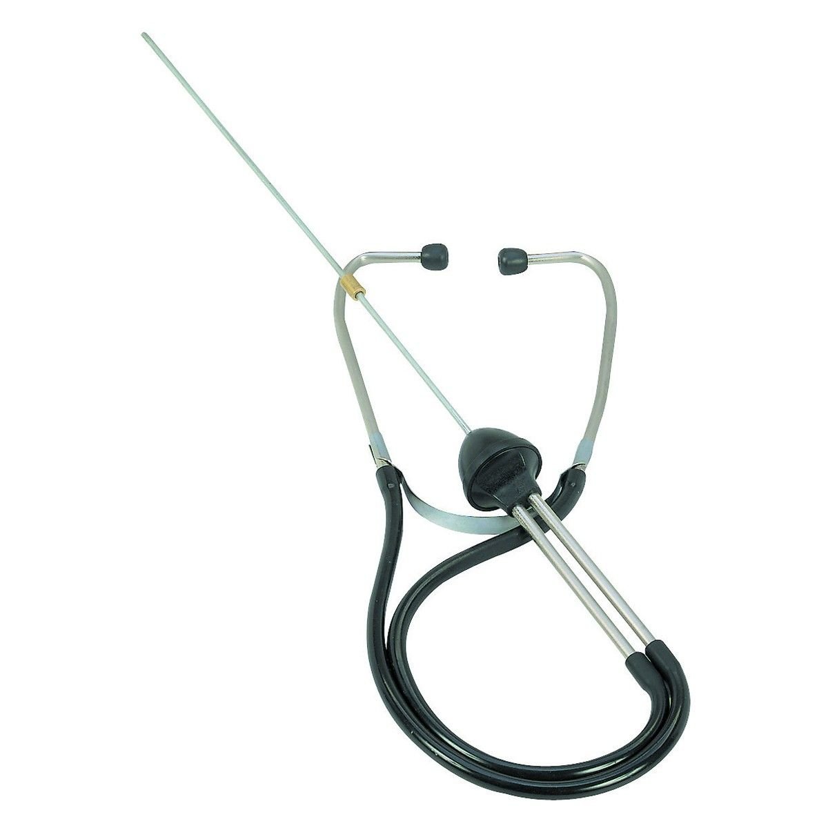

A stethoscope could be a huge help. It has a long rod that you touch to parts and it amplifies the noise. Bought one from HF for like 10 bucks to test which idler pulley was bad.

More like 4 bucks

A mechanics stethoscope should easily help diagnose this. Even just pressing a screwdriver against things could do it since it's so loud.
