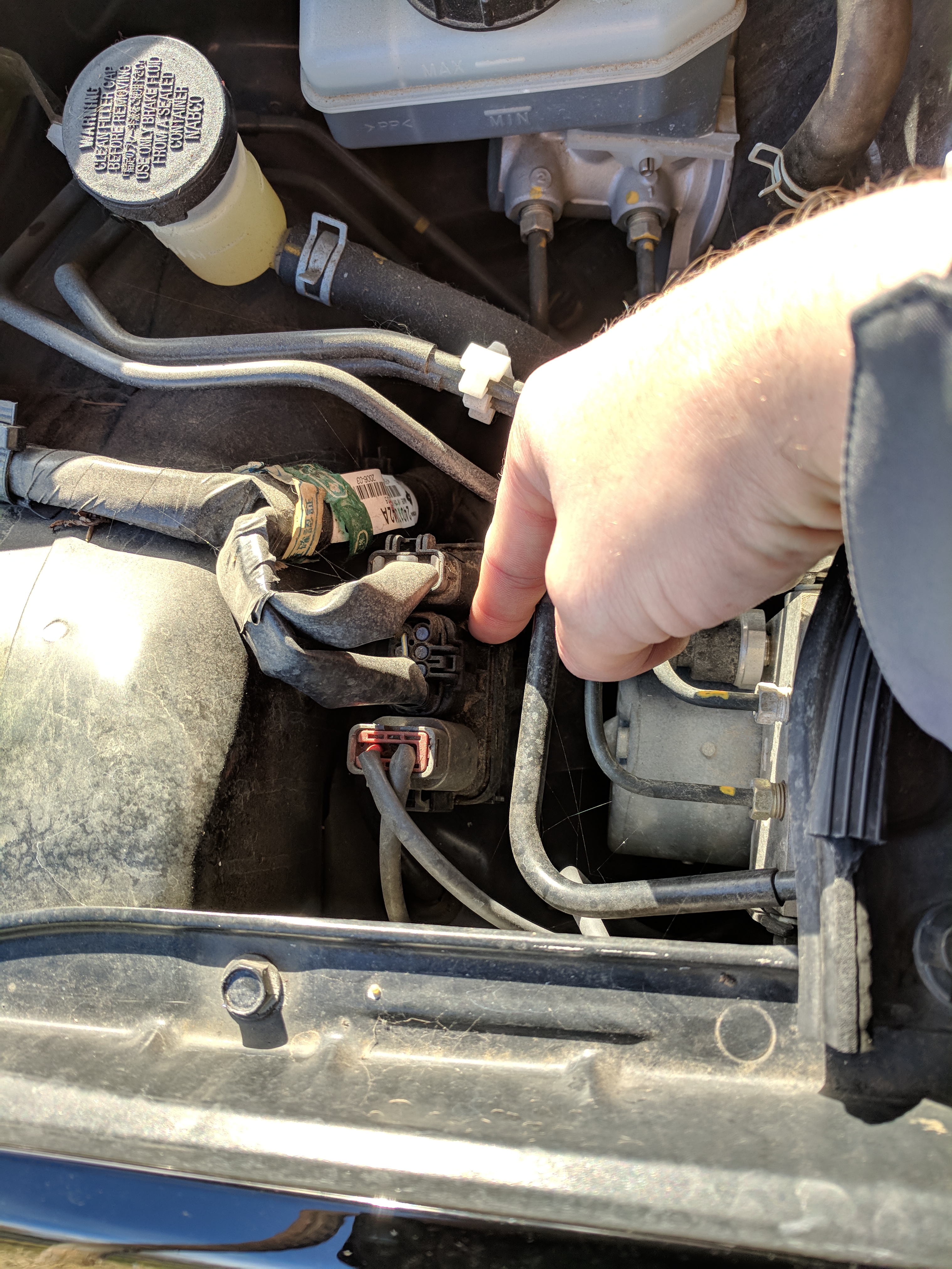

Ok I'm at my PC this morning, the ABS relay sits right in front of the actuator valve block, driver side near the firewall. Lemme dig around I have a picture I took for another user a while back.

Here it is.
Attached Thumbnails how to replace the abs replay? 05 G35 Coupe-img_20171220_110911.jpg

I know where its at, I just font know how to swap out the actual relay. I already removed the connections to the relay, now I just need to know how to swap it out for a new one, I couldn't find anything on the factory service manual unfortunately.

The relay is literally that whole black thing I'm touching in the photo, unplug those harnesses and take it out, put in the new and plug the harnessed back it. You should probably unplug the battery first.

I followed your instructions and I'm trying to take out the relay by pulling up but its not budging. whats keeping the relay in place? a clip? I wish there was video out there so it could be easier but I could't find anything

Ohh **** sorry I didn't understand what you were asking, on the side close to the tire there is a little retainer you have to pull back on with a flatblade screwdriver while you lift straight up iirc. I got a picture here of that side with my phone, don't be afraid to bend the bracket a little towards the ABS body to get a little more room.

Thank you! that worked (:

Yeah as soon as I realized what you were talking about I remembered the last one I did, protip, wear a leather glove on the hand that's pulling the relay up that piece of metal it's hooked up to is INSANELY sharp and I sliced myself bad enough that I could have gotten stitches if I went to the hospital.
