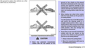

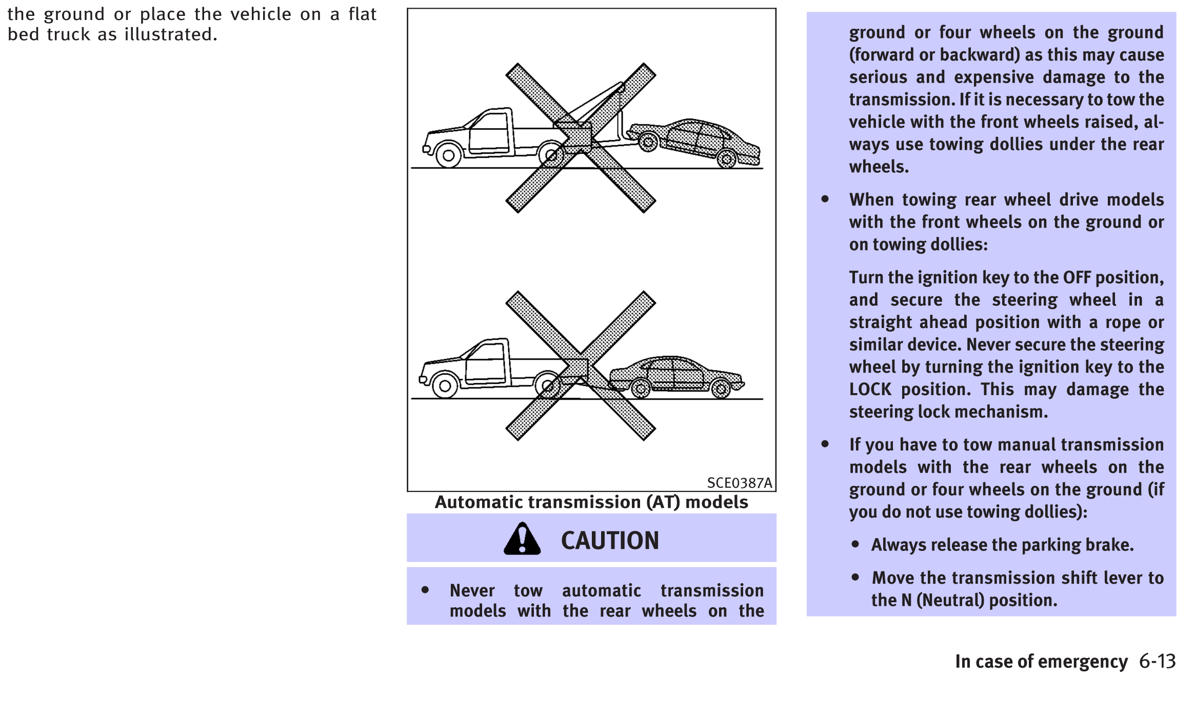

Nooooooooooooooo! Owner's manual says never never never.
Attached Thumbnails Can the G35 AT 2006  be flat towed behind an RV?-2006-owner-s-manual-towing.jpg

The reason for not towing the AUTOMATIC EQUIPPED G35 is the transmission does not self-oil from rear output shaft rotation. Some vehicles DO oil the transmission when only the rear shaft is spinning but the G35 does not, therefor you will have unlubricated moving parts inside the transmission that WILL experience early wear.
You should be able to google search a list of vehicles that can safely be towed behind a 5th wheel. You always have the option of removing the driveshaft from the differential (just use a strap and tie it off to the side) though if you are absolutely determined to do it.
