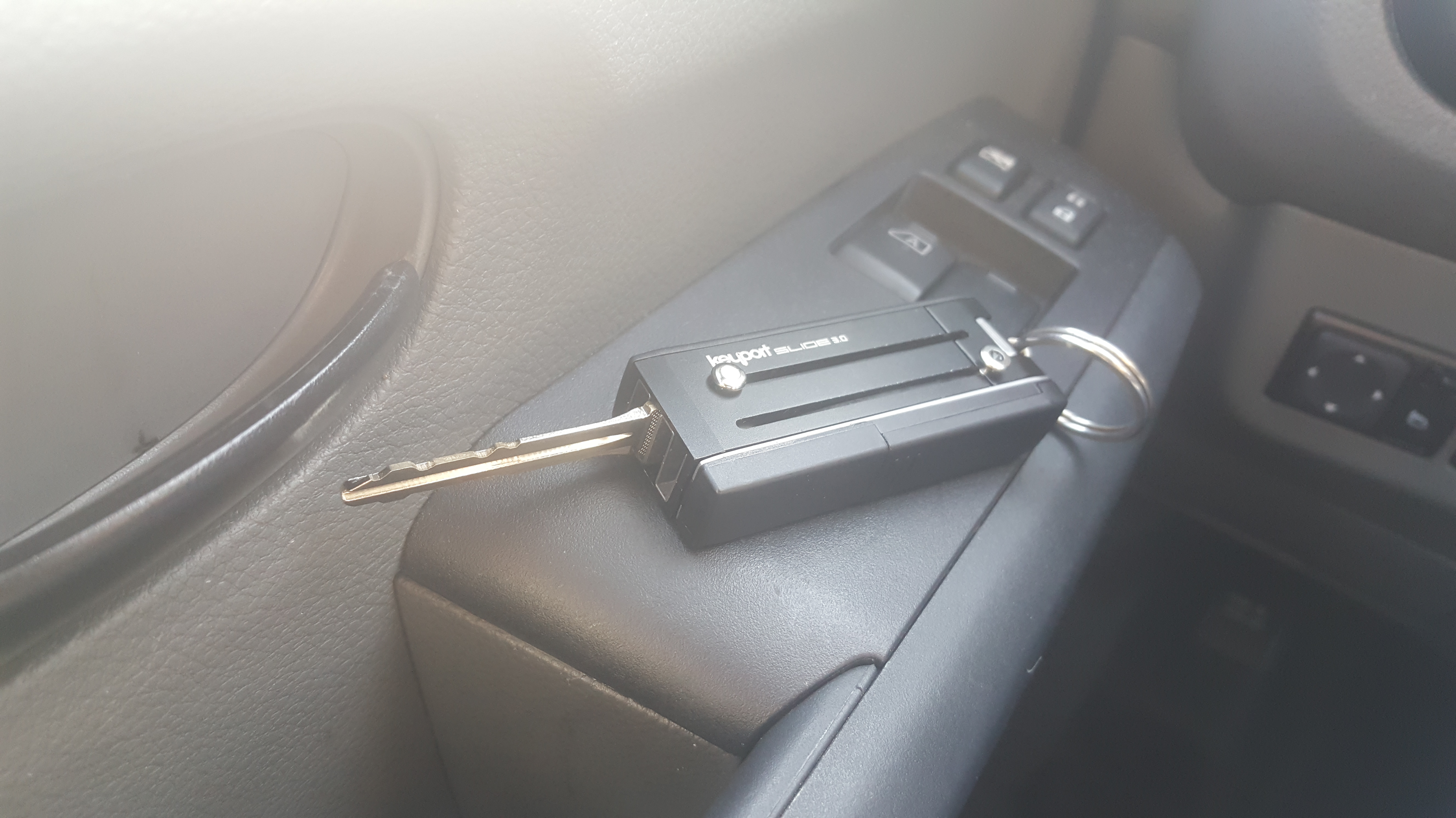

Just got this in the mail this week. Its called the Keyport Slide 3.0
Its pretty sweet. Theres different inserts you can install in the housing along with your car key.
For example there is a pen, flashlight, multi tool and knife. Only thing this is missing is it does not
incorporate the remote fob.
https://imgur.com/a/73cPCgb
