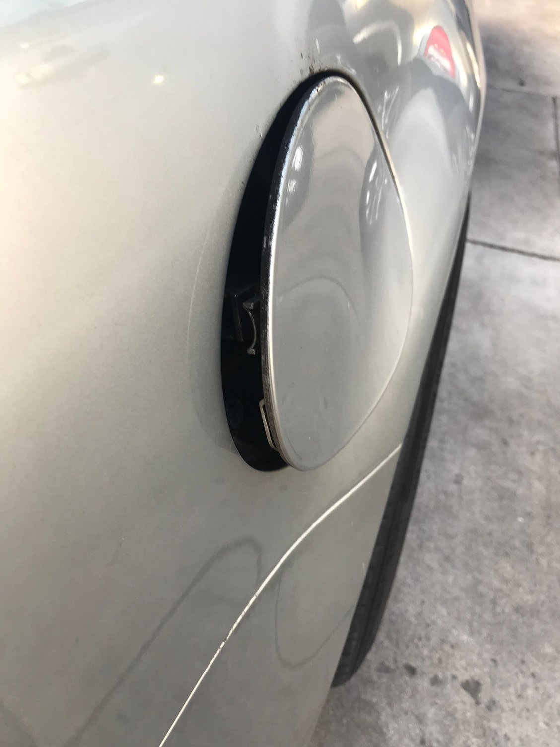

Hi everyone im new to the vq world and this really bothers me can someone please help gas tank won’t stay close

That black button is the spring that holds it shut and open. The hole cut out is the lock that keeps it shut while you have the doors locked.
Try pressing the black button to actuate it. If it won't actuate then remove it inside the passenger side trunk behind the liner and try and fix it or replace the part.

yeah I realized the black part is the spring, it pops it open but there’s nothing to keep the gas tank closed. I went behind inside the trunk and played with the locking mechanism. I pushed it in and pulled it out while looking and it does nothing

It does nothing? Or is it broken off. Common thing to break.

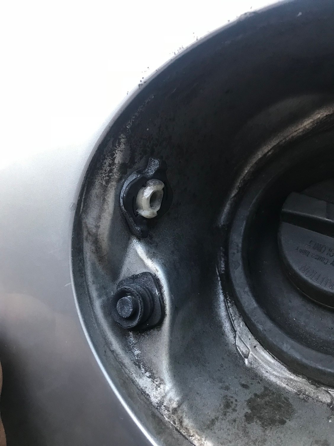

I don't have a photo but I drilled into the plastic and screwed in a screw to fix mine. Lock works now.

may I see a picture of what you done ?

Whats stopping the door from fully closing when u try to push it in?

From his post I gather it's closing but won't stay shut.

I'll send a video link later when I get home and have time. But see if the unlock (twice) or the lock button moves the gas lock actuator. It's job is NOT to hold the door closed all the time though, perhaps your gas hinge just needs some lube action.

nothing is stopping it from closing it, it just won’t stay flush with the body it will just pop back out

Then lube it up at the hinge.

Hey guys, thanks for helping. I went to the junk yard and looked at other coupes and I noticed I was missing a bracket and my fuel door itself was broken installed another one and it’s flush
