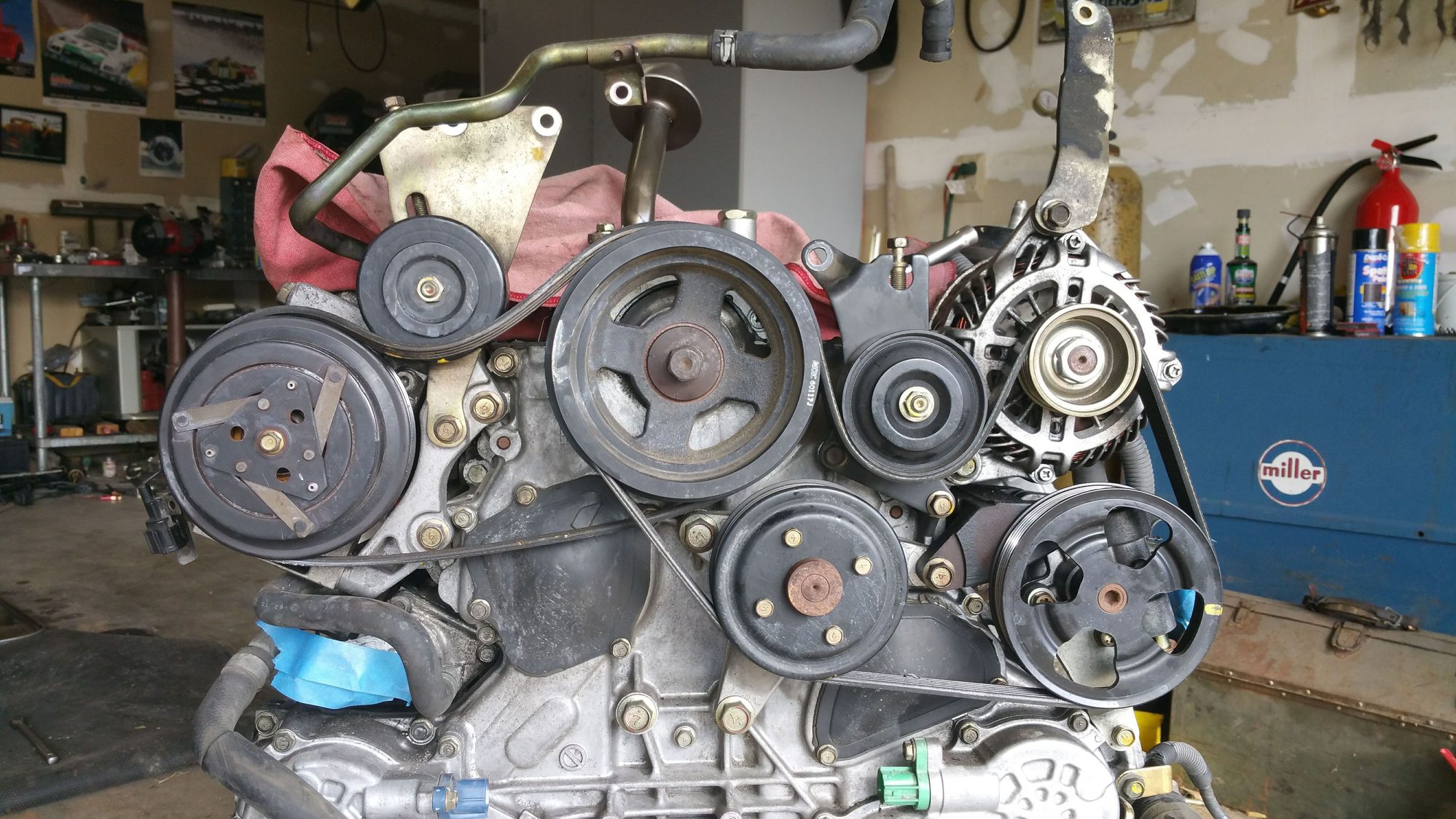

Picked up a wrecked 06 Automatic for it's motor

But I noticed it has a key fob and ignition without a key, and doors with just a button to open it. Was this an auto only option? Has this ever been swapped over to a manual 2006 car?

Is the picture you posted from the donor car or from your car? It's a rev-up motor and wouldn't have been in an 06 5AT.

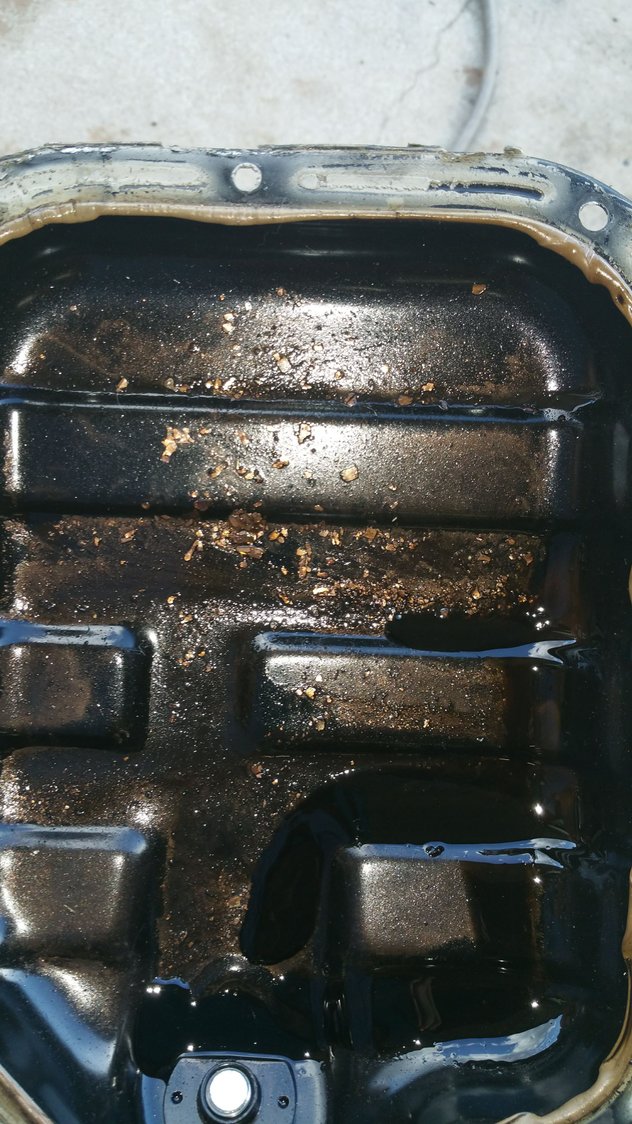

That's the motor from our 06 MT car. It needs the crank polished and new rod and crank bearings to be running. Shop didn't check oil properly and left oil level to low, damaged the bottom end.
