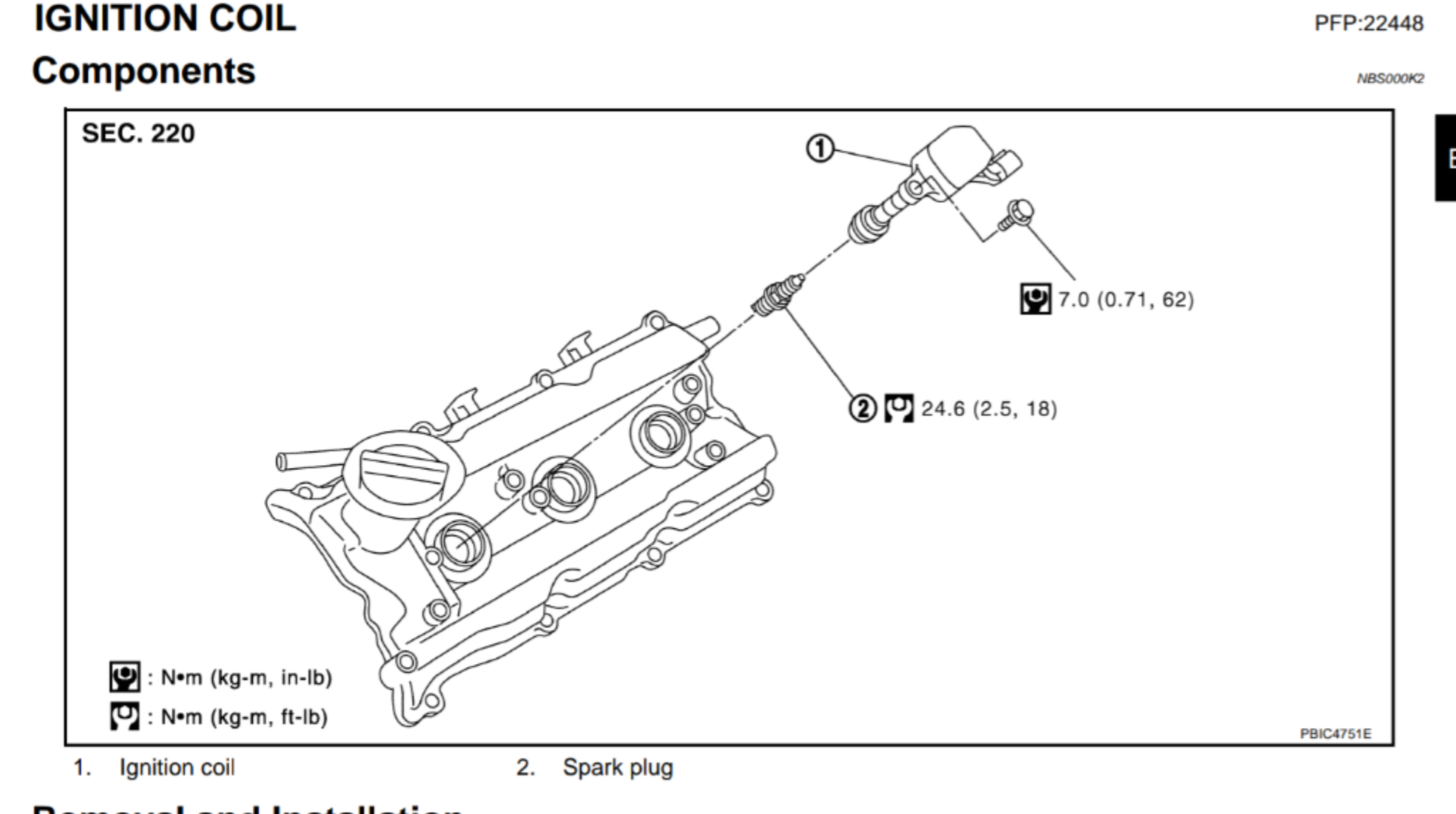

62 INCH/lbs right? Fortunately it's a small thread and very easy to get out with a bolt extractor.
I read 95 in/lb for the coil pack bolts, got that from numerous threads online and a FSM screenshot from ByThaBayPlayer 3 part video. Based on that I torqued the bolt to 8 ft/lb. Maybe torque wrench failure??? Anyways, I used a nut driver to tighten the rest by hand.

Here's a screenshot of the FSM.
