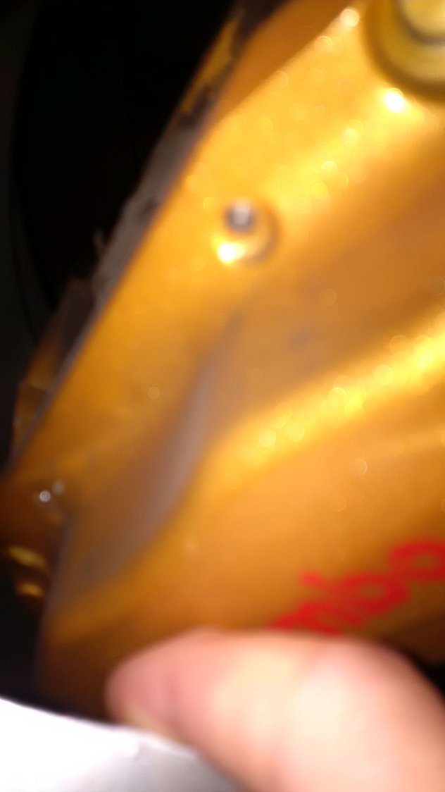

Haha no, they're definitely not plastic covers. There is 2 pins that hold the pads in, changing them or taking them out I should say is a breeze. Here are some close ups.

Yep pretty sure those are EVO 8/9 calipers.
I'd love to see more pics about how they made them fit, would open up more options for good front calipers at a reasonable price.
There's got to be a custom spacer or bracket on the hub, can you post a picture of that too please.

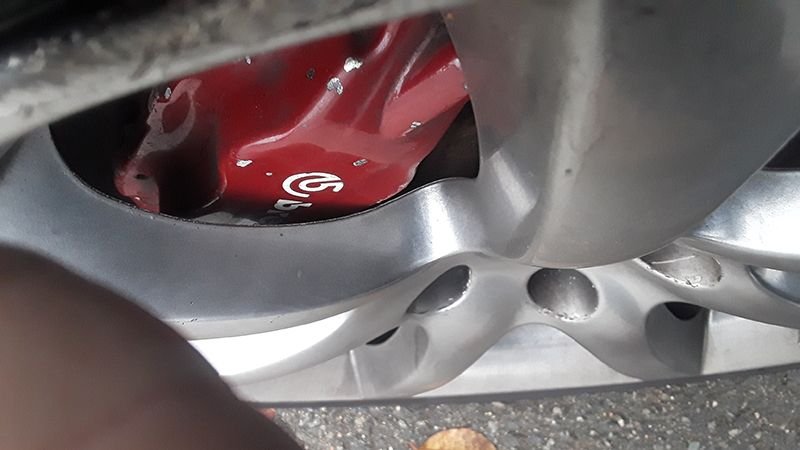

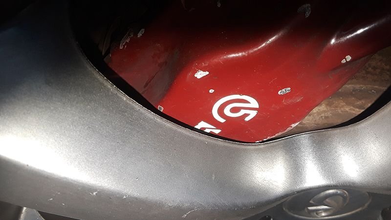

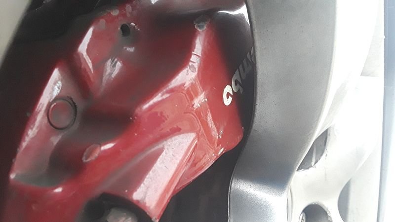

So I didn't put the new pads on, actually went on a small trip out of state for the weekend, but I did take a few pics f the caliper and wheel clearance (which is NOT much). You tell me if this is normal...
Old Oct 28, 2019 | 05:21 PM
  #25
cleric670's Avatar
BANNED!!!
Joined: May 2017
Posts: 14,837
Likes: 2,497
From: Washington State
Coupe 6MT Premium RAS
It's tight but as long as it's not rubbing it's fine. With wheel spacers or aftermarket wheels with more offset it would be a non-issue.

Well that is definitely not stock which explains why the 3 sets of pads are wrong. I have the original Brembo on an 03, with no spacers and the gap between brake and wheel is nowhere near as tight, I can fit the first quarter of my finger through the gap. As cleric said it's either from an Evo or it could be just an aftermarket Brembo big brake kit. I'd look for a model number on the caliper itself.
