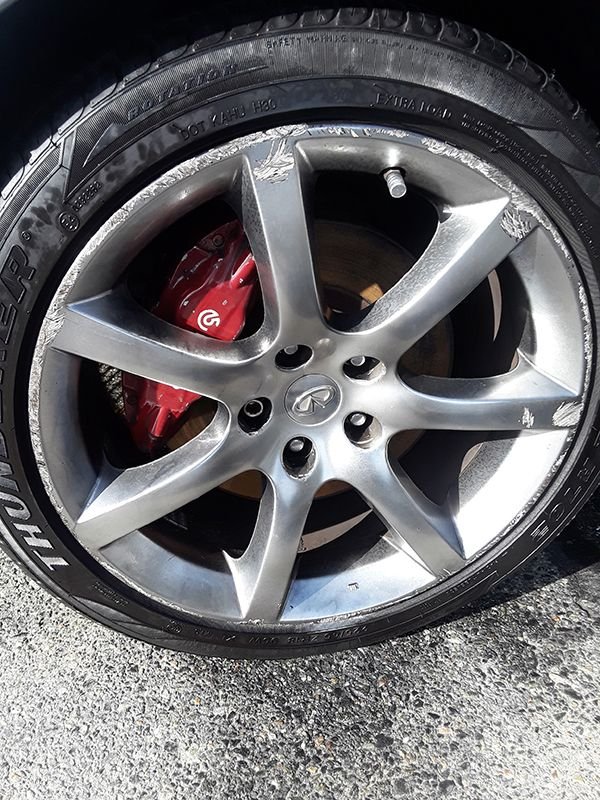

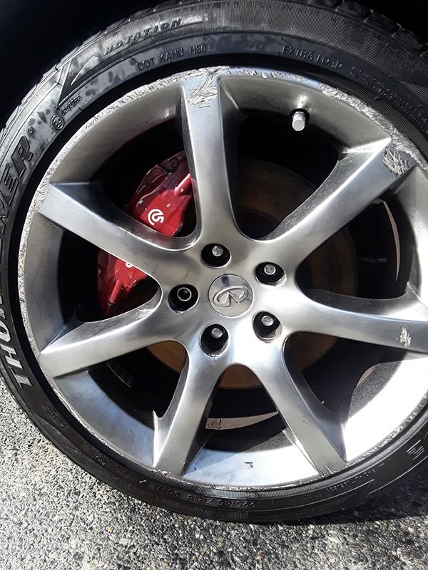

Here is a pick of the calipers with the wheels on. I didn't have as much time as I thought I would the other day. The brake pad pictured is the ones I keep getting sent but they are the wrong size (too small) and the shape of the pads on my G are a little different. At the top of the pads near where the holes are for the pins there is a small divot. Also my pads are about 3/4" bigger.

Hard to tell from the pic but almost certain those are NOT the OEM Brembo calipers. Shape is completely wrong. Need a better picture with the wheel removed.

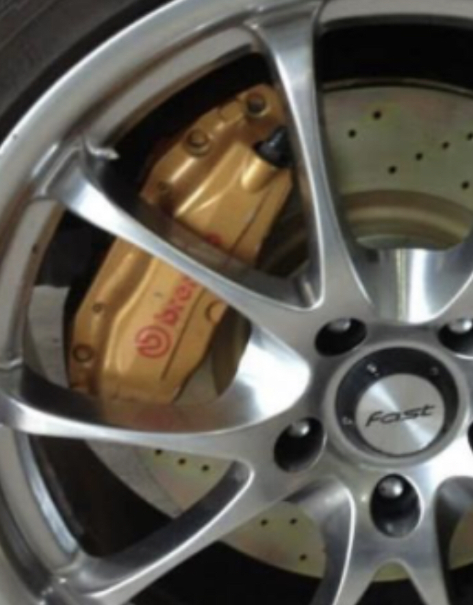

Agreed ^. It's not the Akebonos either. Weird... please get more pics.
Pic of factory Brembo added.

Those look almost exactly like the brembo calipers on a friends Lancer EVO. I think someone did a brembo swap on your vehicle but from some OTHER brembo equipped vehicle.
You're going to need to remove them and look for a serial number and take some really good pictures to figure out what you're dealing with and probably quite a bit of research to figure out exactly what pads you need. I'm not aware of any brembo swaps to the G35 that used other manufacturers equipment like that.
You likely have some other custom hardware on the front to hold that caliper.
