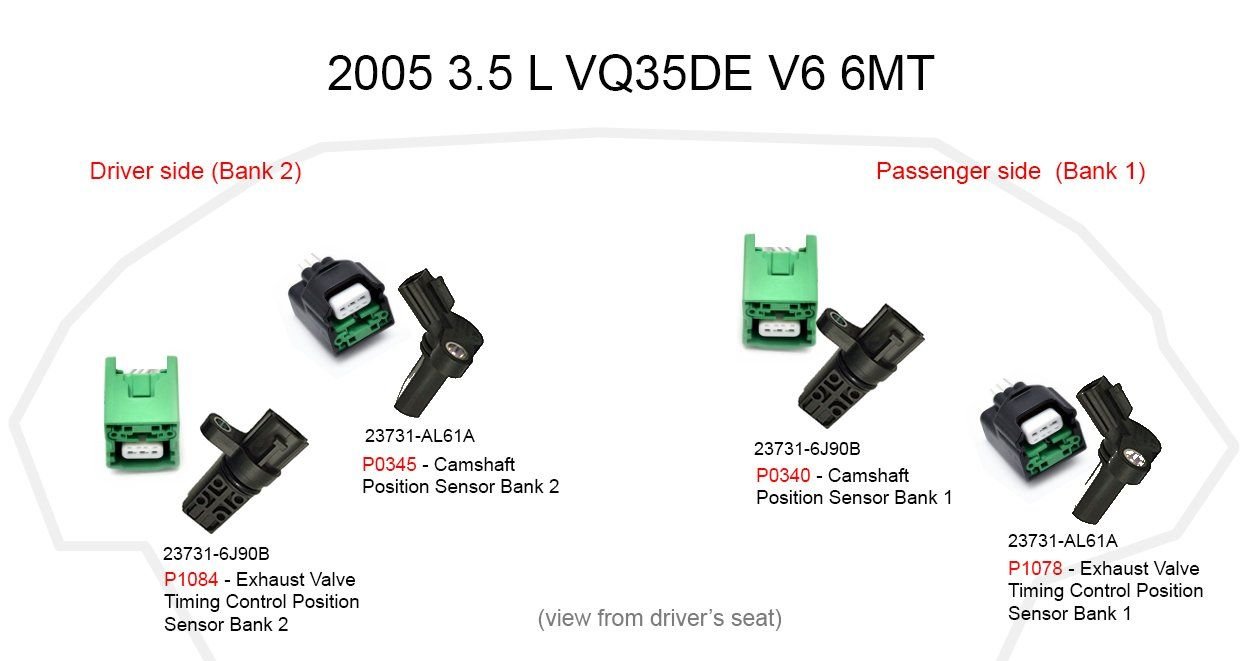

For P1078, I have replaced camshaft position sensor bank 2 and (driver side below throttle body/intake) and camshaft position sensor bank 1 (passenger side). I believe that the one I need to replace is on the passenger side and is accessible from below. The conflicting information I found mentioned replacing the vvt solenoid for this issue.

P1078 - Bank 1 exhaust timing control high/low voltage. This is almost ALWAYS the cam sensor, but if you get a lot of oil into the harness it can send a bad reading as well so you should use contact cleaner and spray out the harness, let it dry, see if it works again. If the sensor is bad replace with a Hitachi or Genuine Nissan Parts, don't use aftermarket (Hitachi is the OEM supplier for those parts so safe to use).
You have the rev-up engine in your 2006 6MT so you have FOUR cam sensors. The VTC solenoid is for the INTAKE cams not the exhaust cams, no need to replace those. The exhaust cams use a magnetic retarder. You probably replaced the wrong sensor, look at the shape of the sensor head, two are straight and two are angled.

Camshaft Sensor and Exhaust Sensor the same part?

I want to confirm: I am able to use the same part (Cam Shaft Position Sensor 23731-AL61A) for the Exhaust Valve Timing Control Position Sensor?

That's actually the old part number, it's had a couple revisions since then and I think the latest revision is
Nissan part number 23731-AL61D I think this is the one where they switched to a metal cap on the end, doesn't matter either way.
The OEM manufacturer for that part is Hitachi, part number CPS0005
