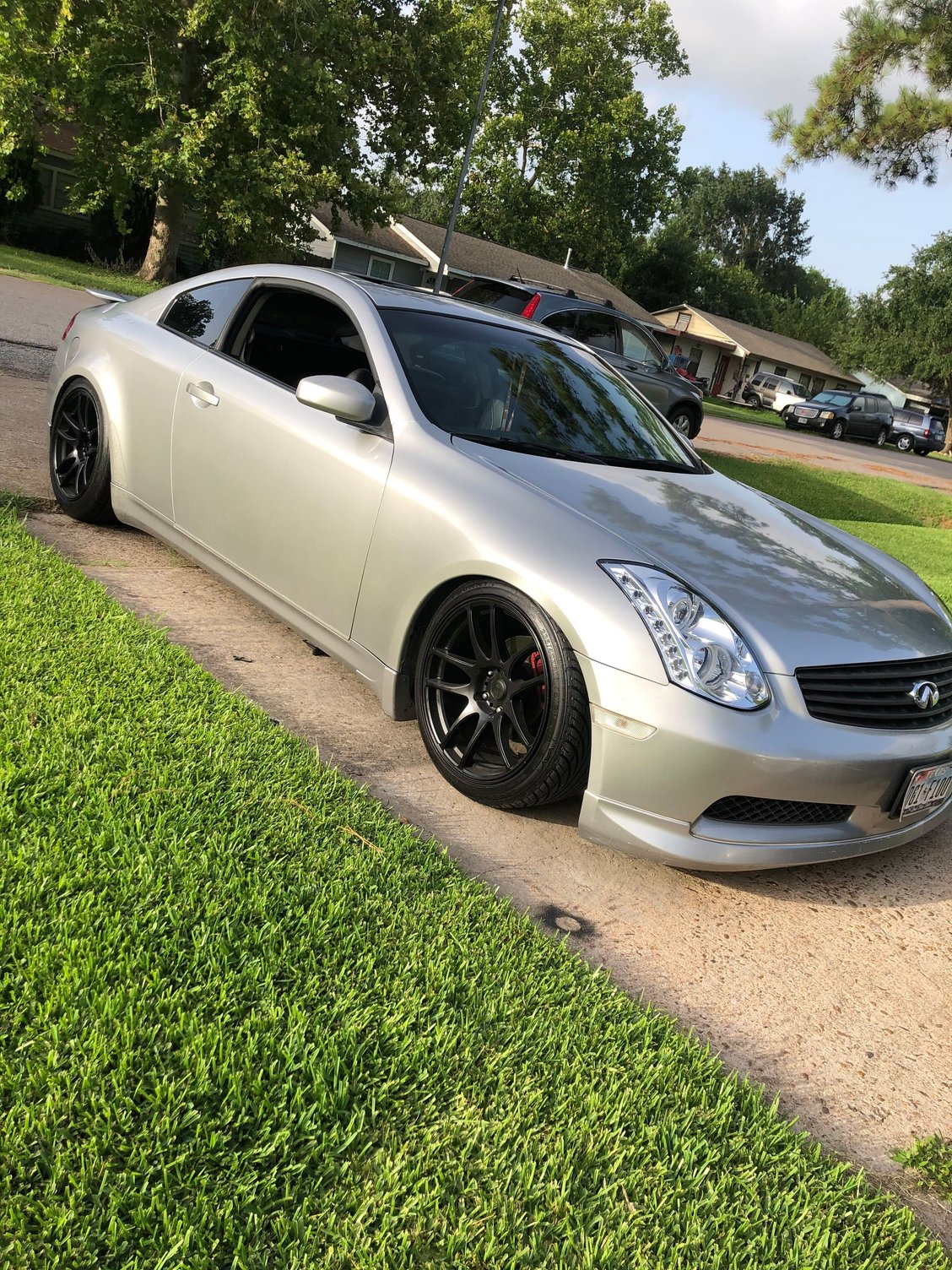

Help!!! 2004 g35 coupe on truehart coilovers Plan on running 19x11 +15 with 235/35/19 up front and 245/40/19 in the rear. Will I need any fender work or camber kit to run this setup?

19x11 +15 all around*

I know that 18x10.5 +15 is confirmed to work, see below:
https://g35driver.com/forums/media-s...c-coating.html
From the pics there, the extra half inch of rim width/one inch of rim height shouldn't be a game-stopper, but it will limit how low you can go. Stock tire size in rear is 245/40/19 on the 19x8.5 Rays, so I would seriously consider upsizing your width a bit; that is QUITE a bit of stretch you're planning for, the tire size is two inches narrower than the rim.
The front is what worries me, I currently have 18x9.5 +25 on my fronts, and I'm fairly certain my (currently rears) 18x9.5 +15 will fit fine (gonna get that square eventually!). 19x11 +15 is a lot of extra rim considering how far the front has to turn. Someone's most likely made it work, but I'd check out FitmentIndustries, they have a huge selection of any model with the exact specs of what's on the car with any notes (rolled fenders, cut fenders, etc).
Good luck!

imo that sounds like a roll and camber is needed, but depends how low you are/planning to go.
should use willtheyfit.com and you can use that reference to measure and get a visual of how they may come out.
