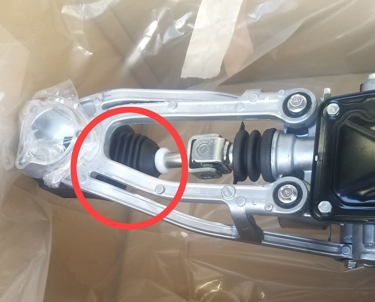

Does anyone know what this is called?
I tried searching for dust boot, shift boot, external dust cover, but I can't seem to find it. I only have a little piece of rubber left of mine, the whole shift assembly is wide open under the chassis and I would like to replace it with a new one while I'm under the car changing the transmission fluid and getting my car back together.

Looks like you're looking for "BOOT CONTROL ROD" 32859-CD000
Once you have a part number, check https://nissanparts.cc for best pricing.

Awesome, thanks. They used to have something like that on ebay where there were a bunch of diagrams and you could find the part number that way but I couldn't find it. But thank you that website does help me find part numbers.
