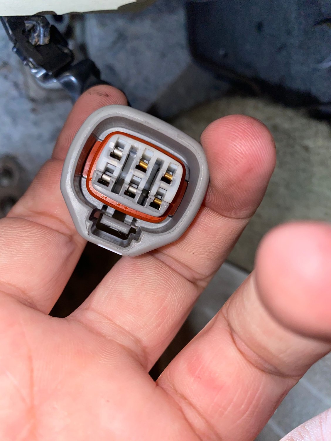

I replaced my throttle body and accelerator pedal position and it still goes in limp mode when I try to move it. If I clear the codes and start it back up it runs fine but if I apply any throttle, it goes right back to limp mode. I’ve tried doing the reset process multiple times and no dice. When I go to keep my foot on the gas after pressing it 5 times quickly the slip and VDC lights come on after about 3 seconds and the SES light never starts blinking. I’m aware it’s super time sensitive but I’ve done this a couple times before and it hasn’t taken near as many tries. I’m honestly stuck at this point unfortunately. I checked the wiring harness to the pedal sensor and it looks fine as well. Any advice would be appreciated. PS. Still throwing codes P2127 & P2138. Also the idle relearn and closed throttle position relearn process worked fine just not the open position

Those two codes means the ECM is not getting the proper data from the pedal, if you have already tried a new pedal switch then the next likely culprit is damaged wiring between the pedal and the ECM. Here is a snippet from the FSM.
You can test the pedal switch with a 3x AA battery holder to supply your 5vdc (close enough with the 4.5vdc from three AA batteries in series) and run the pedal through it's range while using a DMM to check voltage output on both switches (they are inverse of one another, one is like 0.4vdc - 5vdc the other is 5vdc - 0.4vdc when you go from idle position to wide open throttle.).
thanks for the reply man I’m not very good when it comes to electrical work. Do you have anything I might be able to reference? If not it’s no biggie. Also would all that make sense with the car being able to rev higher while in neutral? Does it use less power due to it not being in drive? Once again thanks for the reply.
