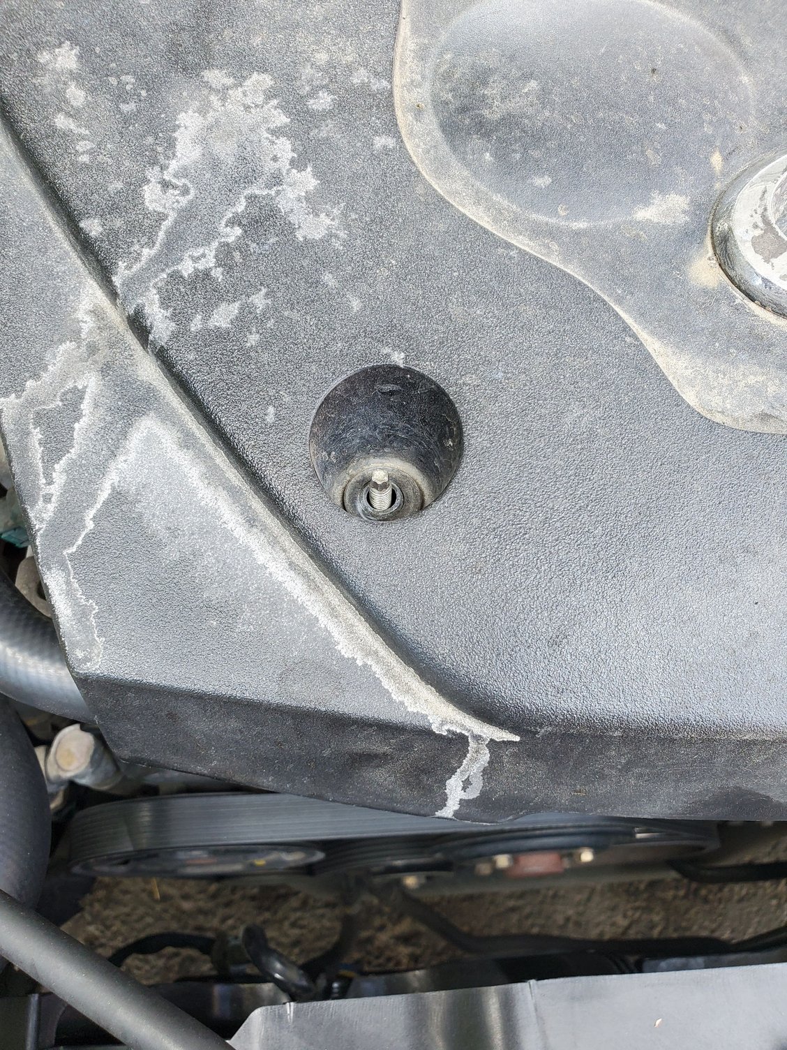

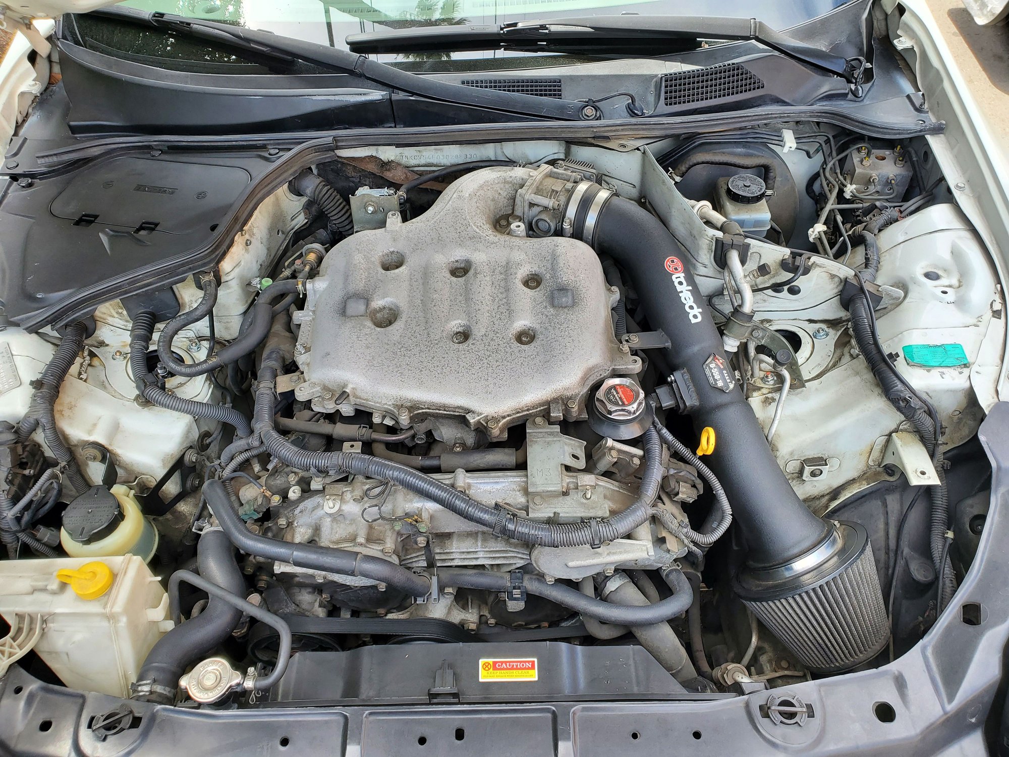

So i bought a engine cover, i personally love the look and i notice that the bottom has 2 screws sticking out which is perfect , but the top 2 don't, any idea what i can put in the top 2 holes to hold the engine cover in place? Also I read for the bottom 2 i need 10mm but I want to confirm with other g drivers, thanks!

I'll go take a pic of the correct ones, I put mine back into my plenum after I permanently removed the cover.
Pretty sure it's a 6mm thread (10mm socket head) and it's about 1" long. You can find a suitable replacement down at Home Depot or anywhere else that carries metric fasteners.
The front just needs a nut with the same thread pitch as the back bolts, again it should be a 6mm thread, can't remember the pitch off hand it's like 6x1mm or something like that.

Thanks a million !
