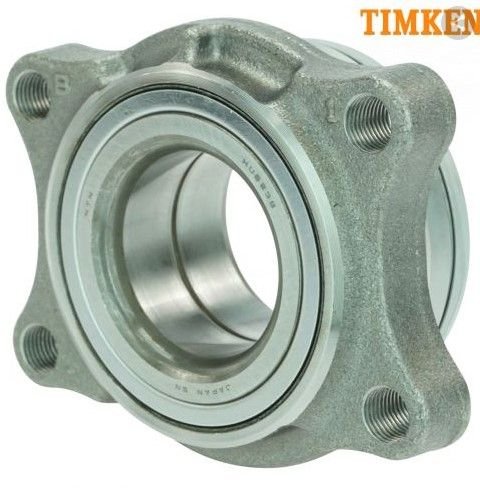

Bearing compared to hub ASSEMBLY.
If you want to do it yourself and want to buy a cheap bearing press I've been using this one for years.
Amazon Amazon
Goes well with this die set.
Amazon Amazon
This bearing splitter is a little overkill but I've broken smaller ones in the past and I personally think this is the perfect size to own since it will do everything from small cars to HD trucks.
Amazon Amazon
If you don't actually plan on using this thing at least once per year and have somewhere to store it then you definitely better off spending the extra $100 and just buying the hub assembly.

The picture cleric posted is the REAR bearing. Again, the front is only sold as an assembly, unless maybe AWD.
On the assembly picture, you can see the raised tone ring used by the abs sensor. It's kind of rubbery, so don't scratch it.
