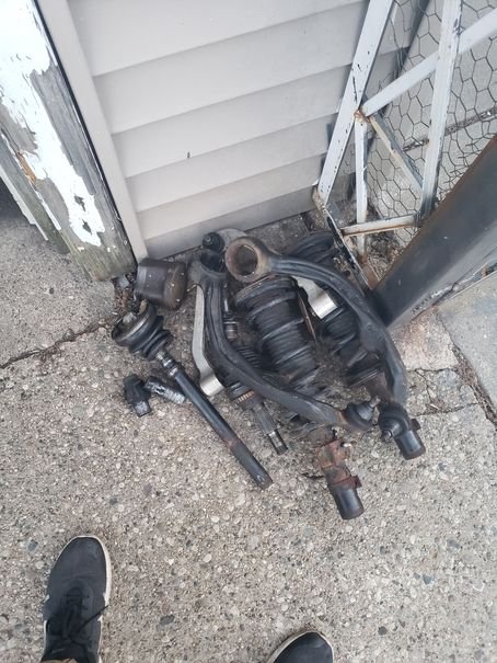

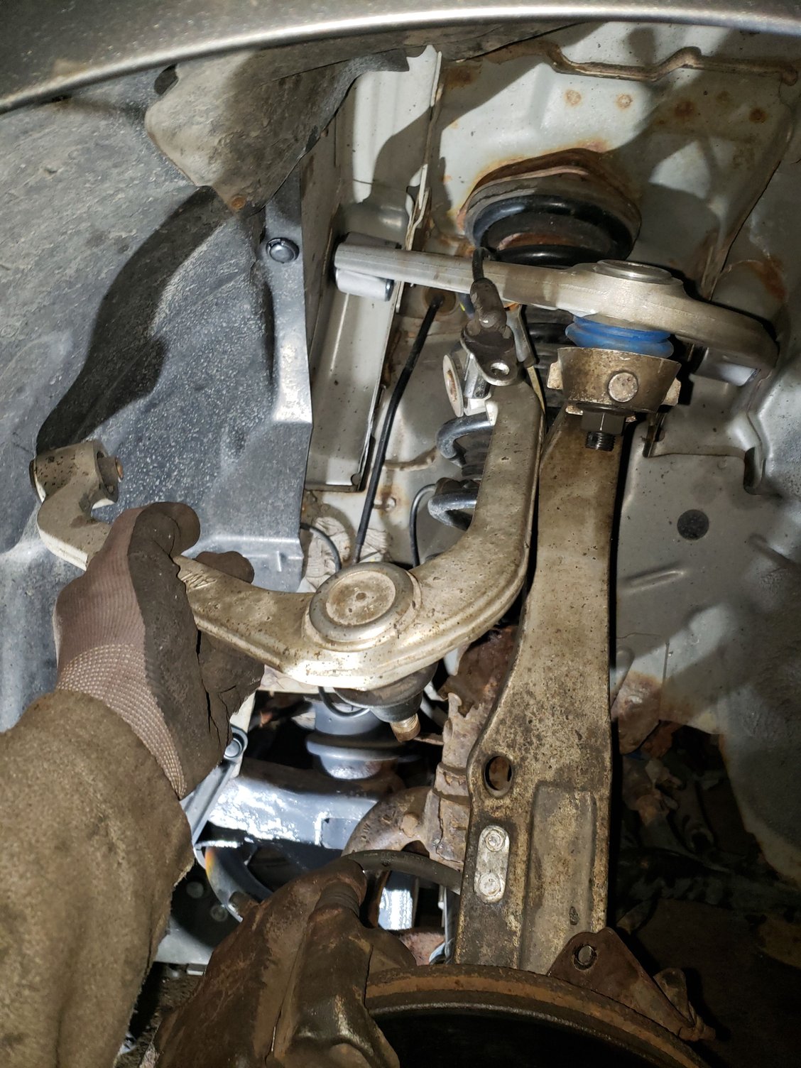

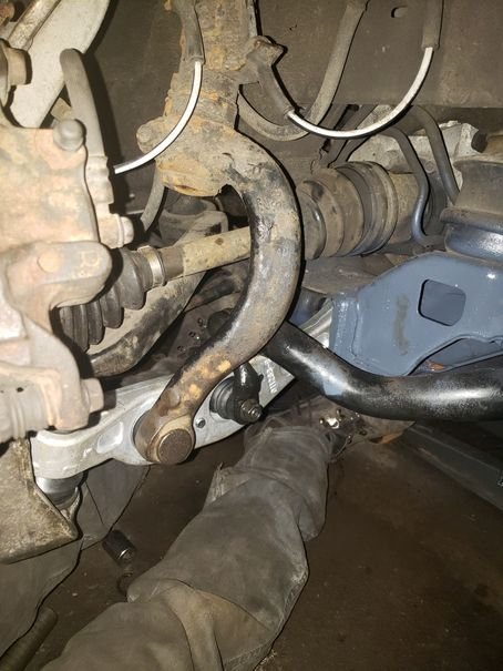

Hey guys, I'm having this extremely annoying issue with my 04 G35X. Every time I go over a mild bump I hear a clunking noise coming from the driver side. I've replace almost every single part of the front end suspension on both sides but I cannot for the life of me get this noise to go away.

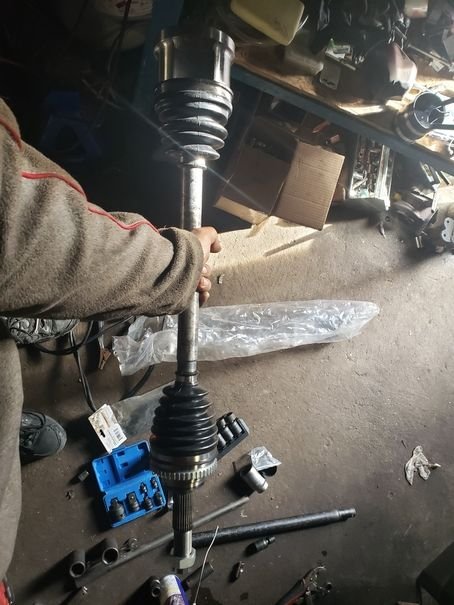

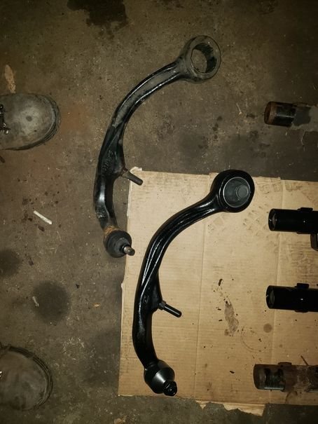

I'll post some images of some of the things I've replaced (didn't take pictures of everything). I replaced the upper control arms, lower control arms, every single bushing (including the sway bar bushings), lower control arm ball joint, stabilizer link connecting rods, stabilizer bar links, even replaced the axle on the driver side (boot was torn). I'm totally lost at this point. The only two parts I haven't replaced are the tie rods & compression rods. I was going to order both compression rods but would that even cause a clunking noise? I checked the struts/strut mounts on both sides and they both look good. I figured I would ask before I buy the compression rods. This is driving me crazy. I almost want to just finish replacing every single part at this point smh... Any other potential culprits that I am missing?

It turns out it was the compression rod balljoint that was shot. I swapped both struts and rode her around the block and she was still clunking away. Swapped both rods (by far the hardest part to swap out of the entire front suspension) after that and the noise completely went away. She rides so good now, the steering is much more stiff and responsive than before. Was kinda annoyed at first but worth it in the end.
New & old strut assemblies
New & old compression rods.
Old suspension junk.
