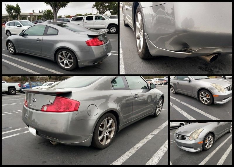

Hey there, I'm the original owner if this '04 G35 MT, no accidents, always reliable and fun to drive. At 90K miles, needs a new engine. Didn't know about the oil consumption problem, and now have rod knock tick-tick-ticking. How successful is installing a new engine? Is something I can expect a seasoned mechanic to do well, or would this just be the beginning of owning a glitchy car that always needs something? I'd love to hear from someone who went through the pros and cons of this expensive decision. Sadly, I don't think it's of any value in it's current condition (would anyone want it?), but if spending $4k brought this great car back to life, I'd be thrilled to have it back. In the meantime, I'm driving it as little as possible, as gently as possible, and checking the oil incessantly. (yah, too little, too late) A recent change is a new noise that sounds like a duck call. Pretty sure there aint a duck in there, so this is probably real bad news... Any input appreciated; your success with this, troubles, unforeseen expenses, how to handle the guilt of letting 'er go, etc. Thanks!!

Thanks for the engine source referral. Valuable stuff as I don't want to be replacing my POS engine with another POS, so the source certainly matters.
I was quoted 20 hours labor at $110 per hour. Now, if this is the entire picture (~$1.8-2k engine + $~2.2k labor = fun car for several more years), then I'm all in. But I'll bet there's more to it.
