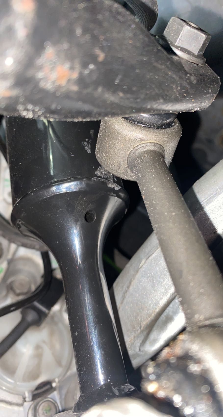

Alright so my 03 G had some shot end links and i know it was rubbing against my struts and compression rod , new links still rub against my front struts and i’m on BC coilovers not even slammed all the way. Any ideas as to why there’s no clearance and still rubs? doesn’t have much drive ability issues though

Are you sure it's a stock sway bar?

Also, does it only rub on one side like the sway bar might be shifted one side or the other?

sway bar should be stock and looks stock, wasn’t aware of aftermarket parts on that end and as for the length it’s even on both sides but does rub on one side since coilovers installed (i’ve checked they are installed properly), but before it did rub on both compression rods now only point of contact is that right coilovers strut. It’s a set of Moog sway links oem style grease fitting is where it is making contact with 1inch of clearance otherwise

Check to see that the nut is torqued to spec. It looks like there is not threads sticking out beyond the nut. Normally there should be 3 to 4 threads sticking out beyond the nut.
