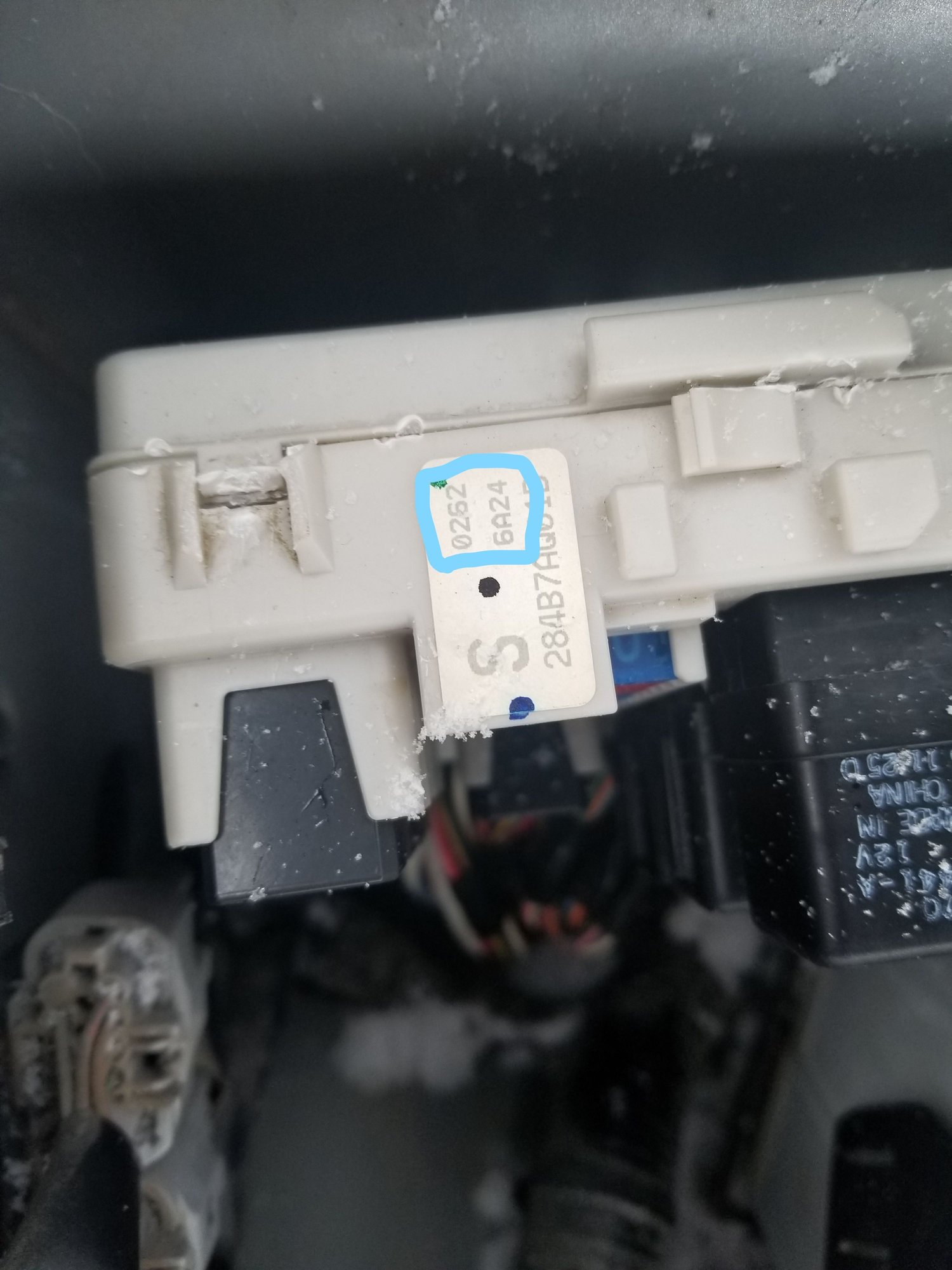

Hello all, some time ago a few members of this forum helped me identify some issues associated with my 06 coupe's IPDM. I've since been looking for a good replacement and haven't been able to match the circled numbers. are they important? what do they mean? I've found plenty with a matching part number but none with the same 2 numbers above. Any help is appreciated, thank you.

Fortunately the IPDM has a very broad range of cross compatibility. Basically anything 2003-2006 (G35 or 350Z, not sure about M35/FX35 but I suspect they're the same) will work. It's not like the BCM and ECM which are VERY specifically matched to chassis/year.

Oh thank you very much, I'll put in an order for mine then.
