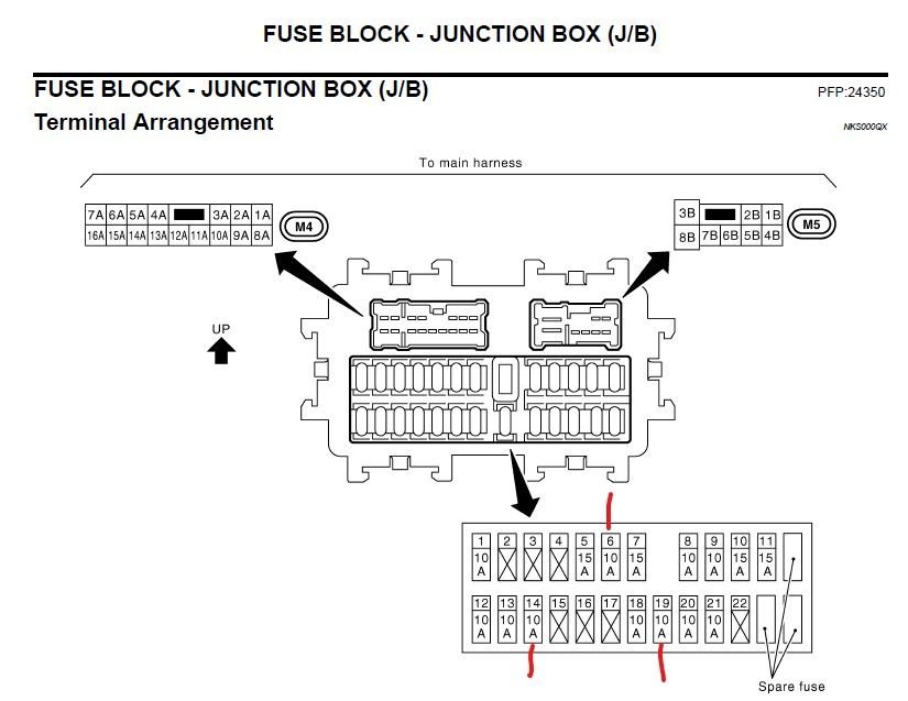

There are three 10amp fuses in Fuse Block-J/B (cabin fuse box) that supply power to the instrument cluster. Fuses 6, 14, and 19.
I would start there and see if one of them popped.

There is also an accessory relay on the BACK of the Fuse Block-J/B, (two total relays on your car), one controls power to fuse 6 and a bunch of other stuff, the other relay is for your AC fan. You can swap the relays to test them, if the AC blower fan runs with both the relays then you know the relay is good.
