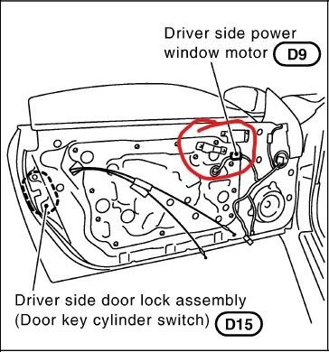

Take off the door panel, unplug the window motor harness and test for voltage, should be +12vdc or -12vdc when you push/pull on the window switch.
If there's voltage it's a bad motor, if there's no voltage it's an electrical issue.

Which wires should i be testing?

This wire, test across the blue and green wires. That's the power for up/down.

tested all the wires all are 0v should i do the same on pass side?
Ok soooo i stuck to my gut feeling that it was the connector on the body side not being lined up.... and ding ding ding. I pushed from up under the dash and used a little force to push the door harness into the body harness and then locked it and boom windows *work*. Pass side goes up and down fine but driver side motor is messed up still lol you can hear it trying to move but oh well i got a 2nd door i can grab one from. Appreciate all the help buddy.

More than likely it's just the window motor failing. Usually they start lifting VERY weak before they completely fail. If you take off the inner metal cover for the door you can reach under the window and help lift it into place using one hand while you use the up button on the door switch.
