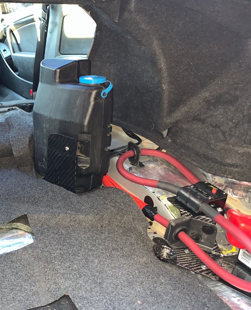

Where did you relocate the battery to? And did you go lithium inside the cabin?

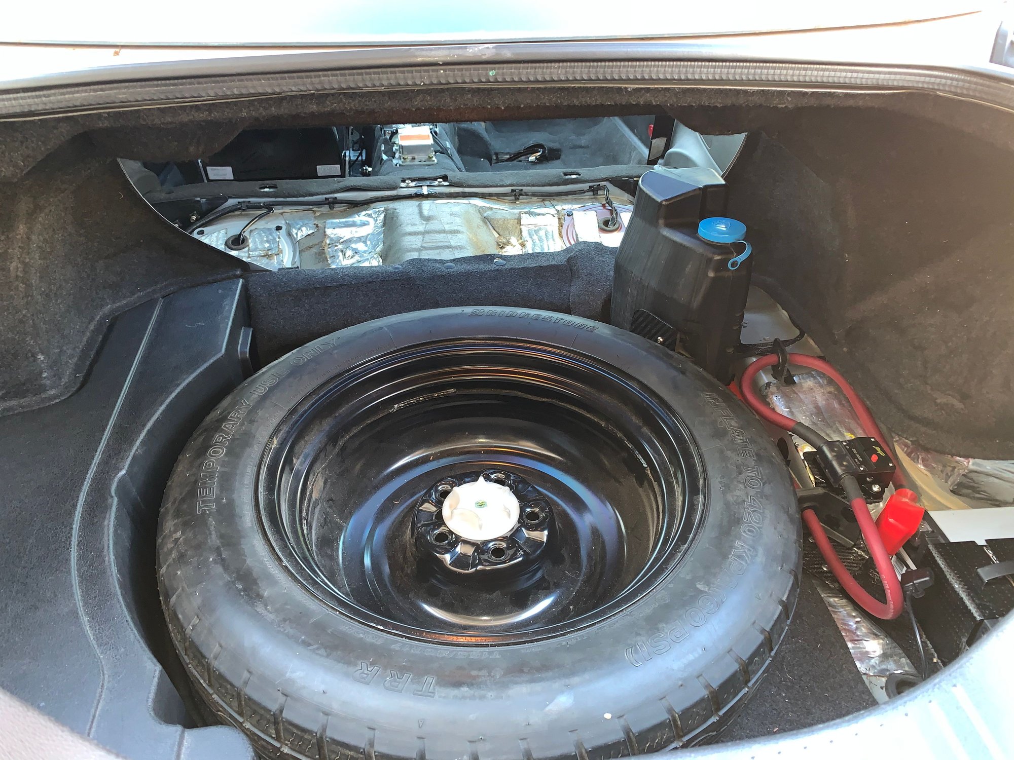

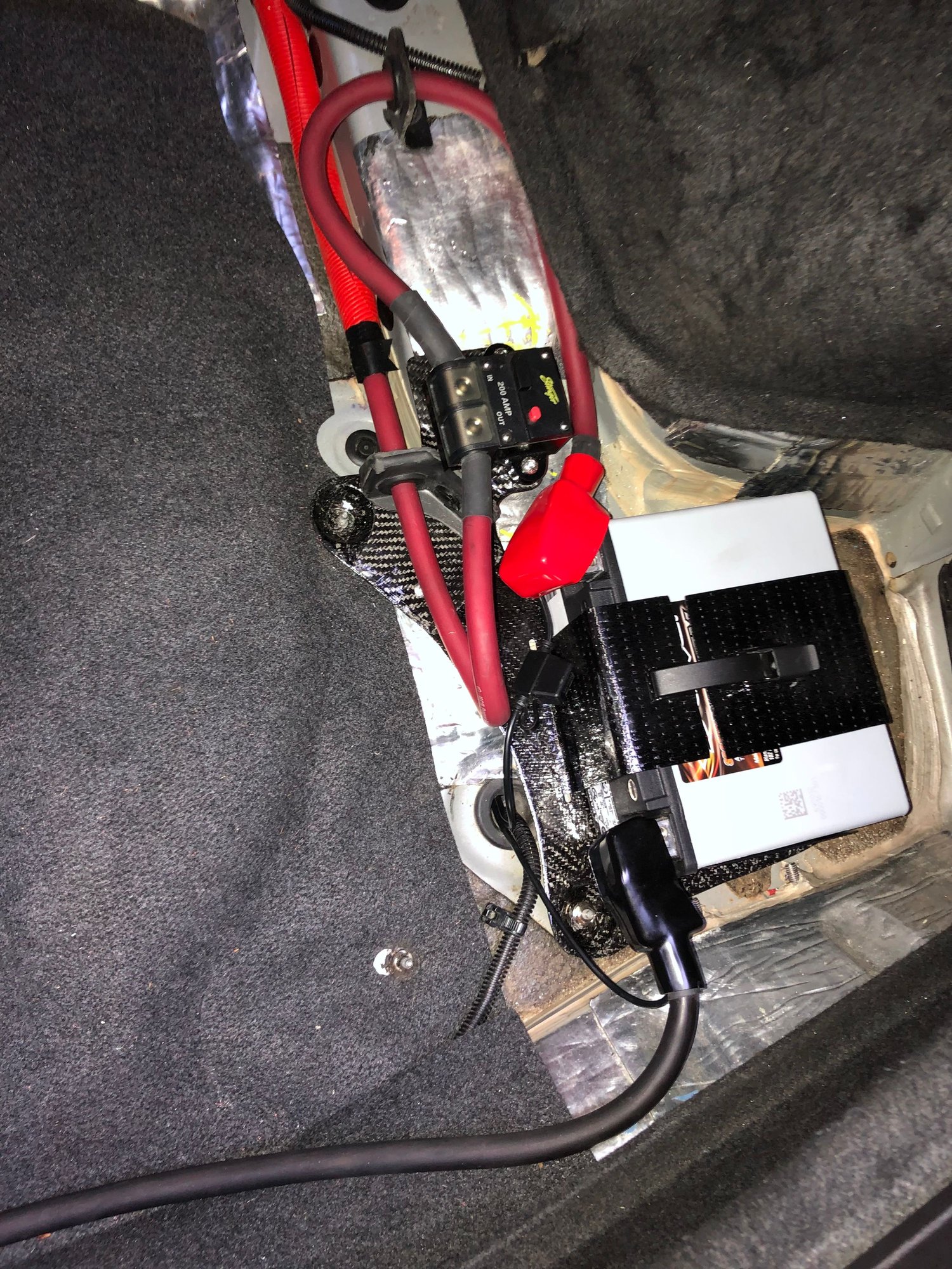

No lithium, at least for now. The cost vs benefit is hard to justify. A quality lithium battery from a company like Earth-X or Super-B (really the only two I would trust as I spoke to a few engineers at a couple of different companies as part of research for a work project) are around $900, while my Deka (ETX20L if memory serves) is ~$150 and the weight difference is around 2kg or 4lbs between the two. So yea, just not worth it.
Relocated to the trunk where the tools used to be along with a windshield washer fluid reservoir from a Nissan Titan:
More than enough space, even the spare tire still fits:

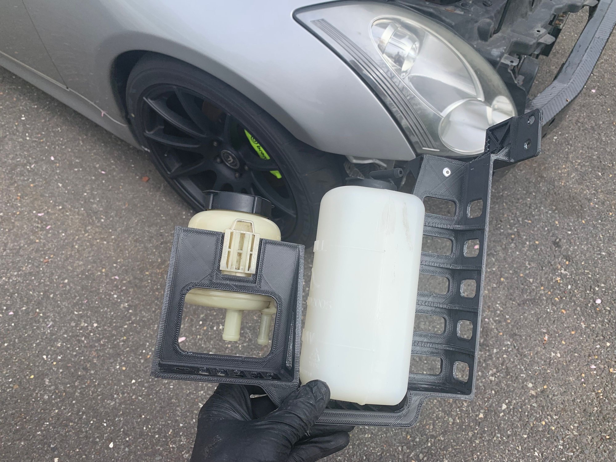

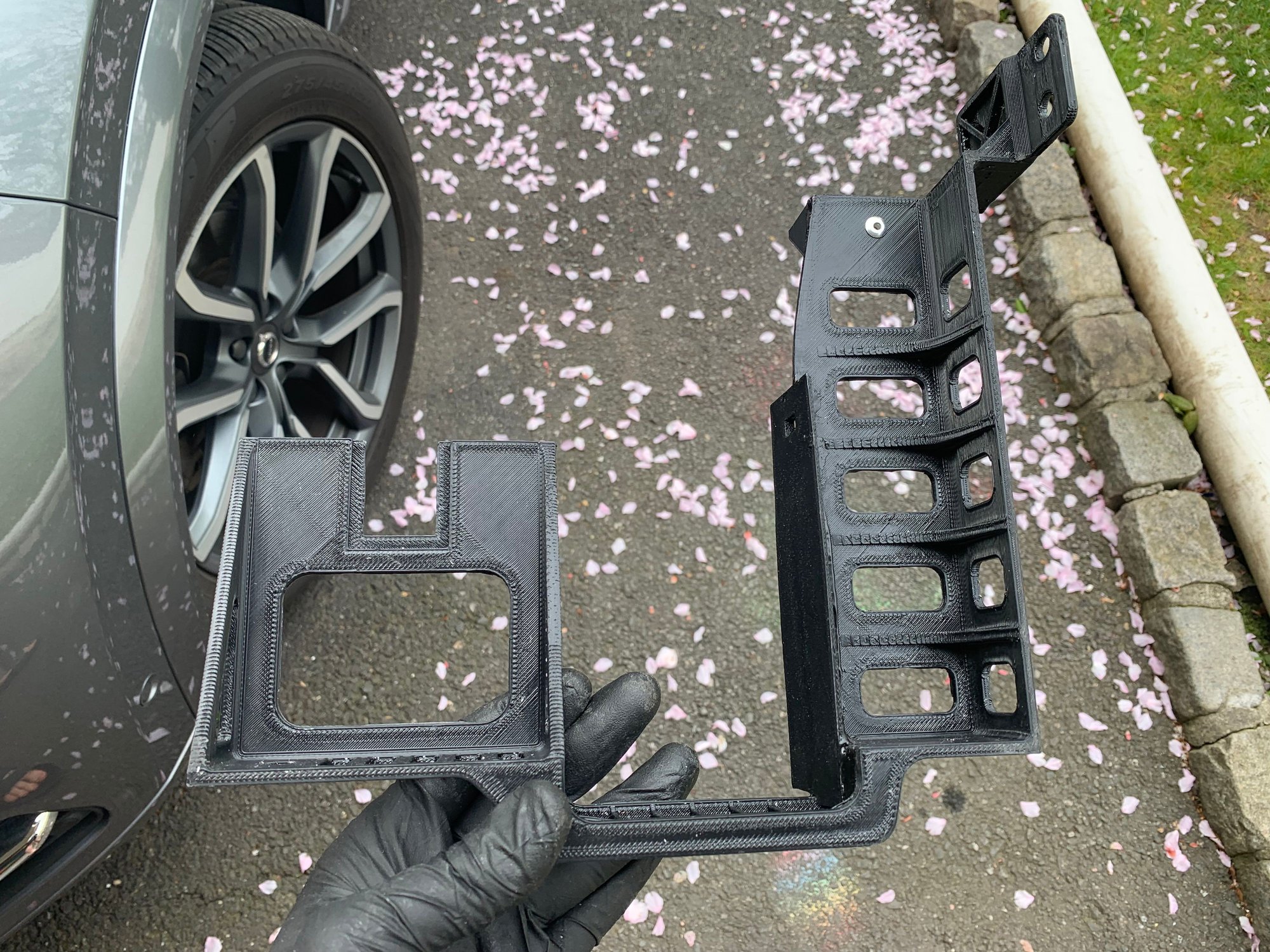

Progress!

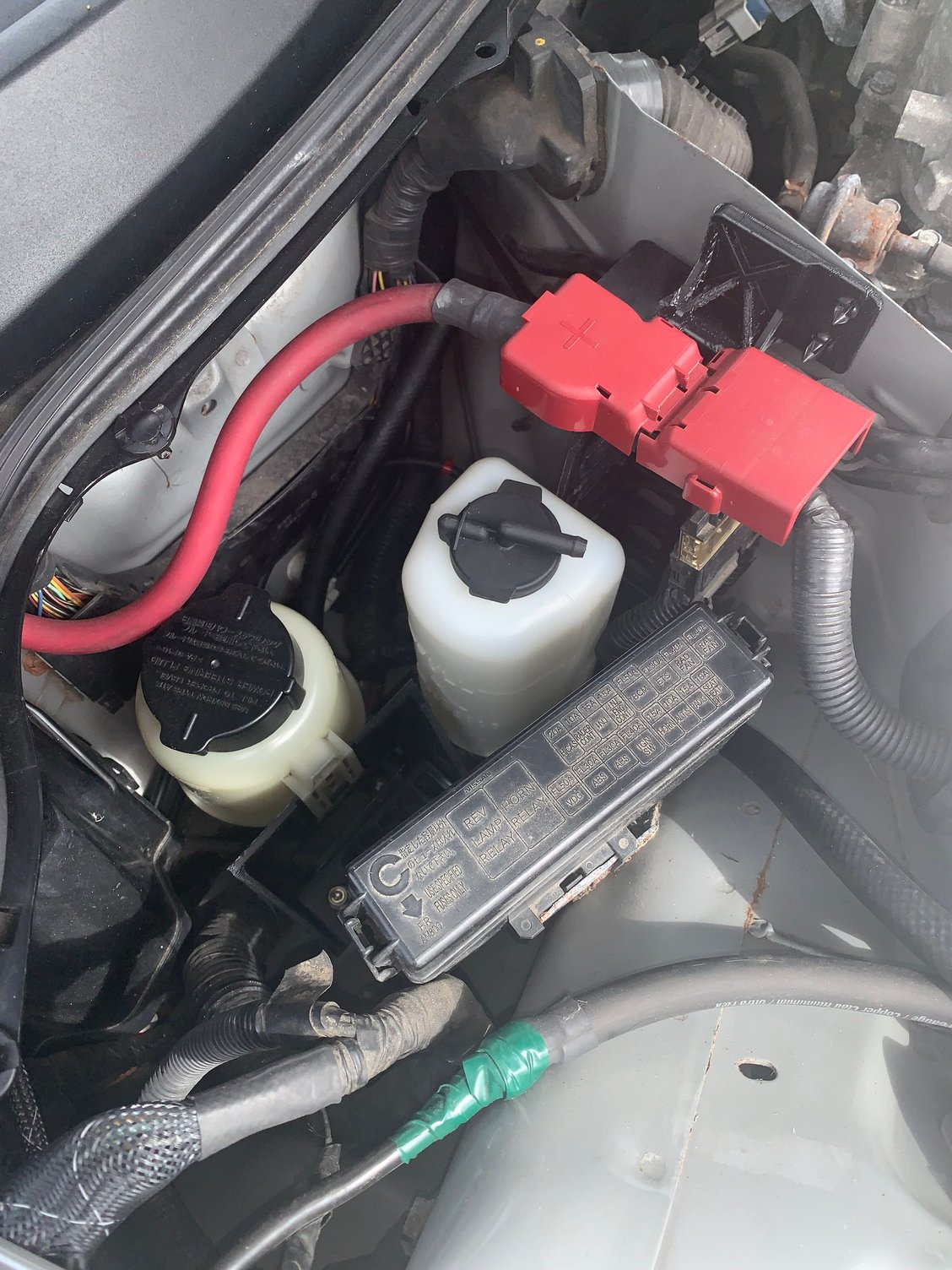

PS reservoir and coolant overflow relocation bracket is done and looks and fits great printed in ABS. Just need to finish up the hoses. Not sure why Nissan decided to use a 5/8 and 3/8 hose on the PS reservoir when the same flowrate goes through both, but ok...is what it is.
I now have all the space I need under the hood on the passenger side to make the vent work.

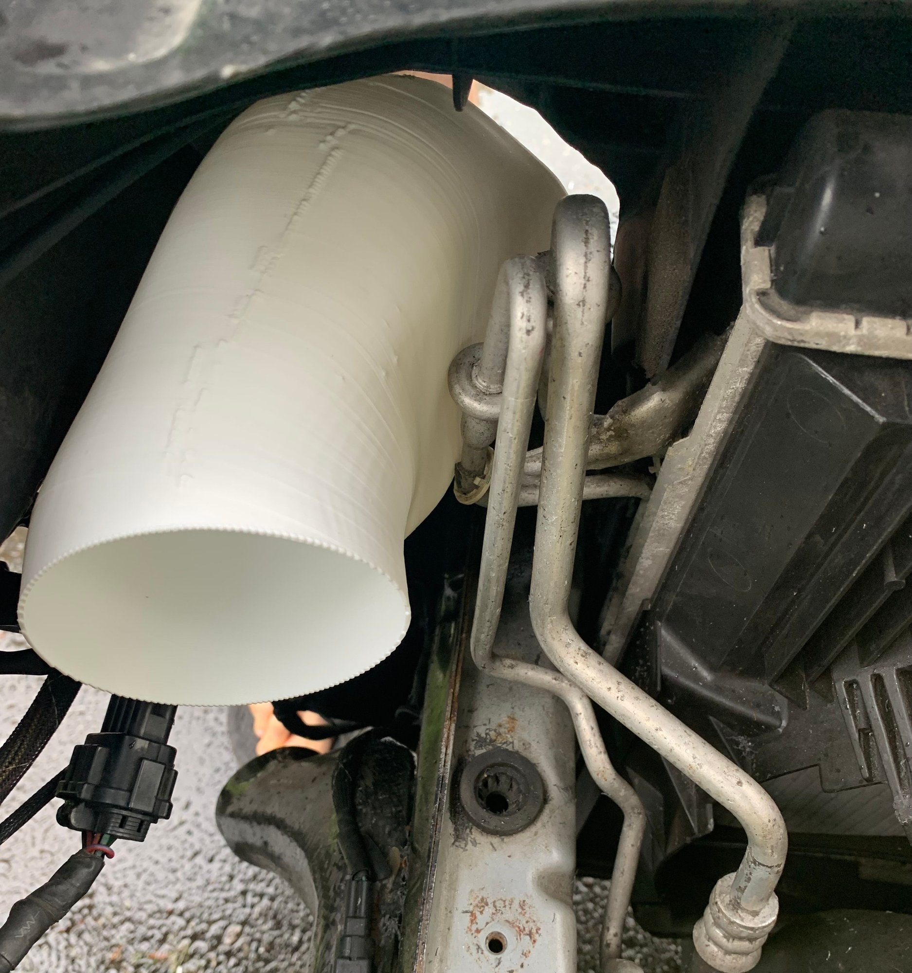

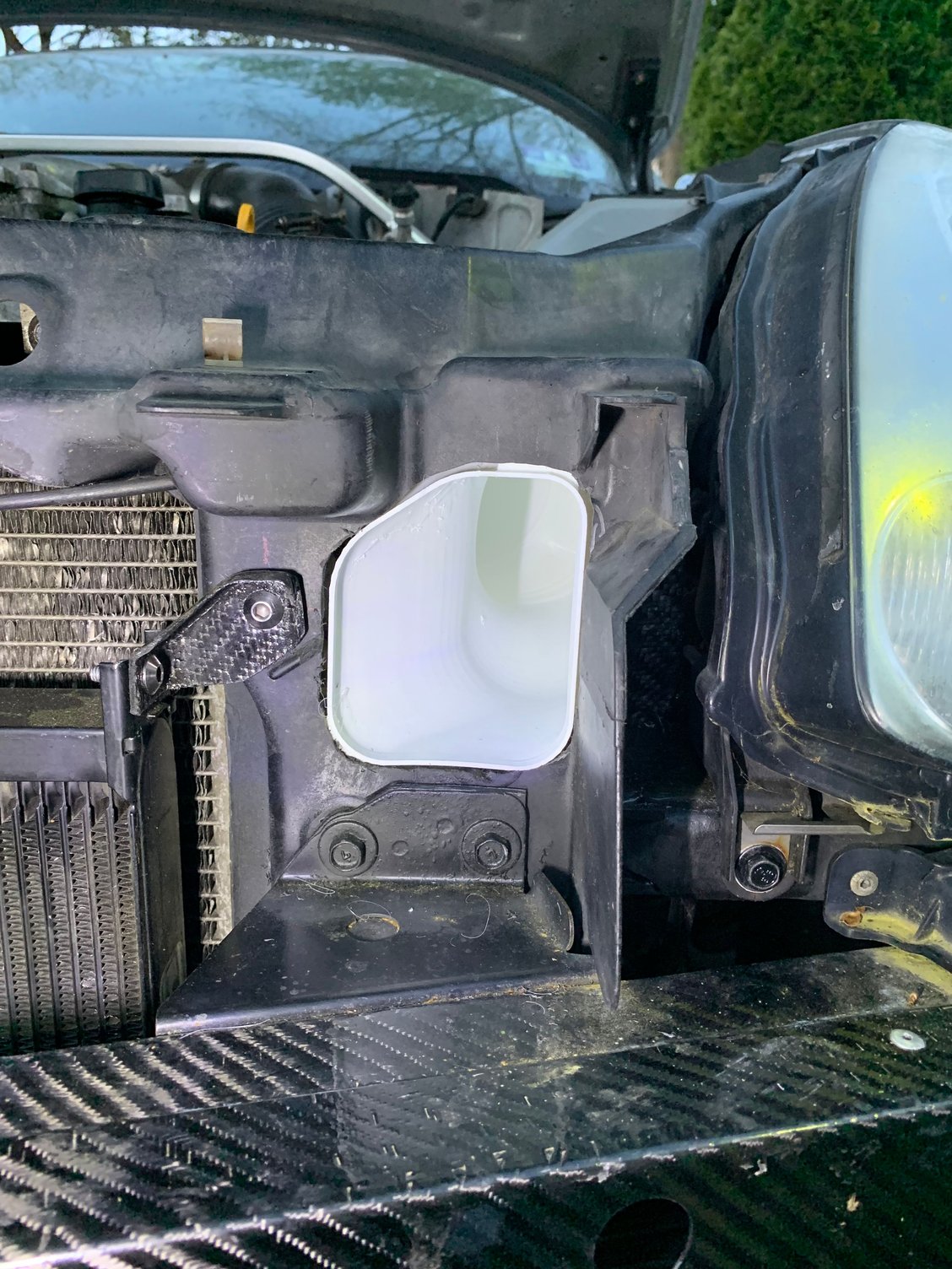

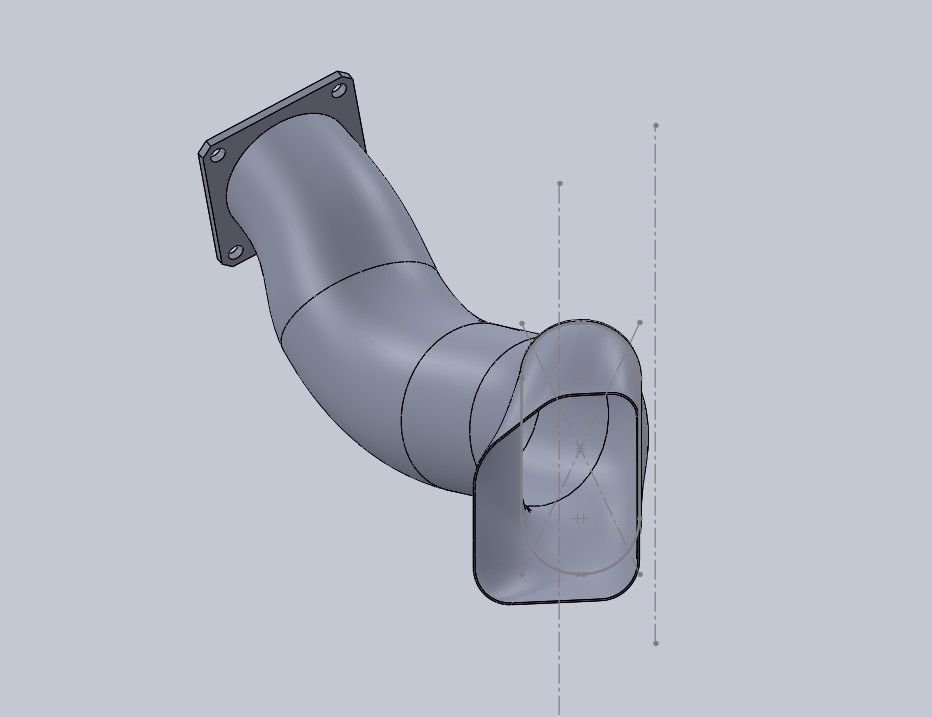

driver side progress in developing under hood space for these vents:
new intake path in development. This honestly would be a lot easier with a 3D scanner so I can scan the available space and work within it, but I can't find a 3d scanner I like that's not more than $2 or $3K. It's hard to justify the cost for now with the limited use I would get out of it. So iterative design->print->redesign->print->redesign process it is for now.
Current design:
Almost there with the fit:

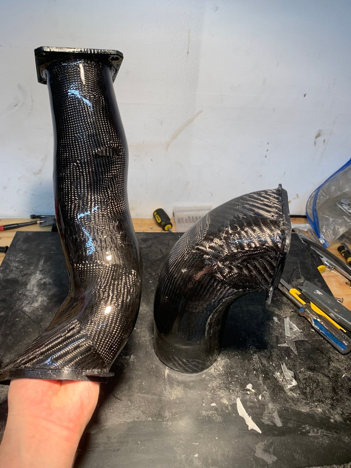

Also came up with a great idea for building this:
I will print it with a very thin wall of ABS (prob only about 1mm) and then wrap it in carbon fiber braided sleeve, which is available all the way up to 6" diameter. This way I'll be able to make a very strong and lightweight new intake tube.
If anyone has some suggestions for not absurdly priced 3d scanners I'm all ears.

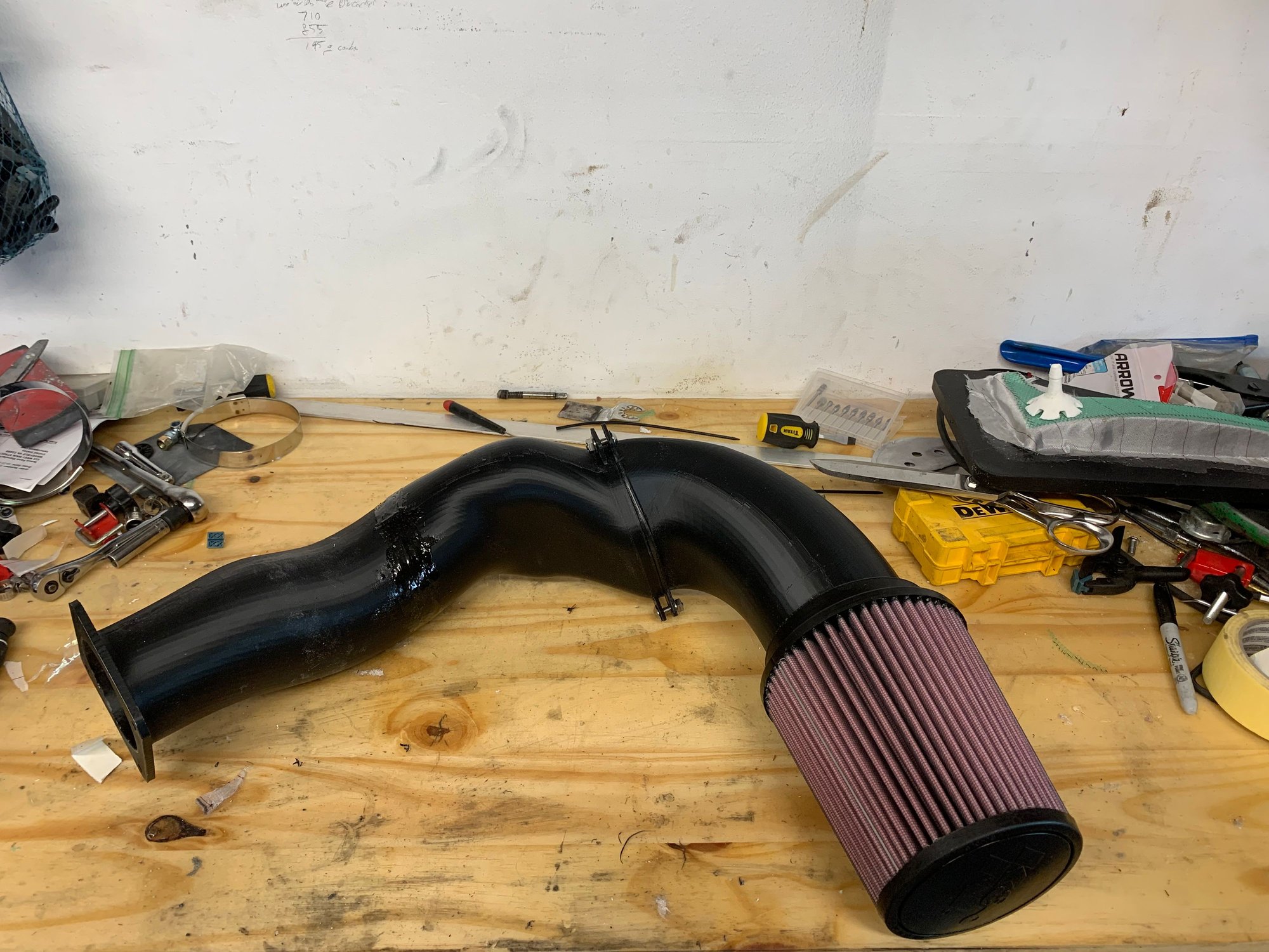

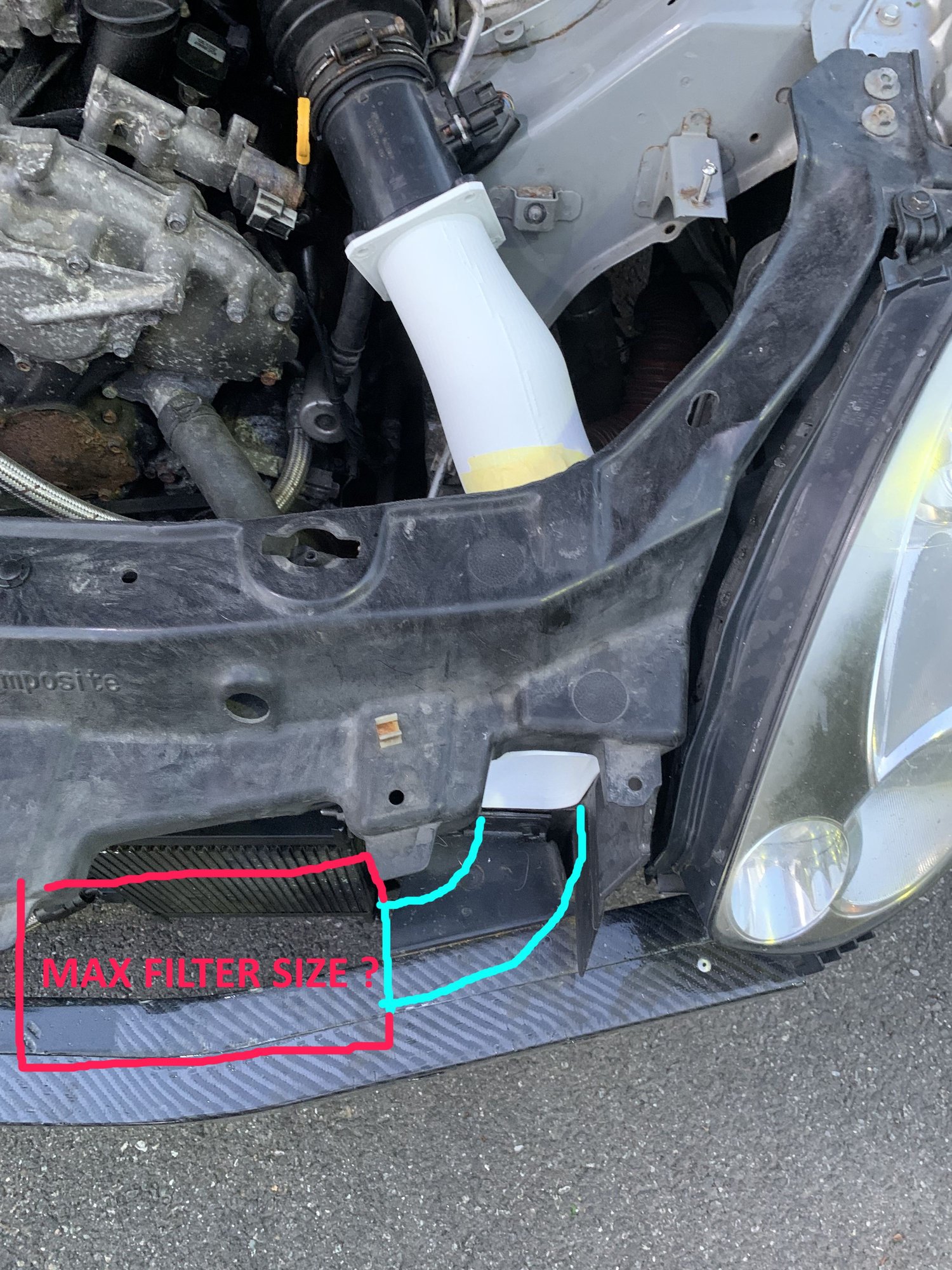

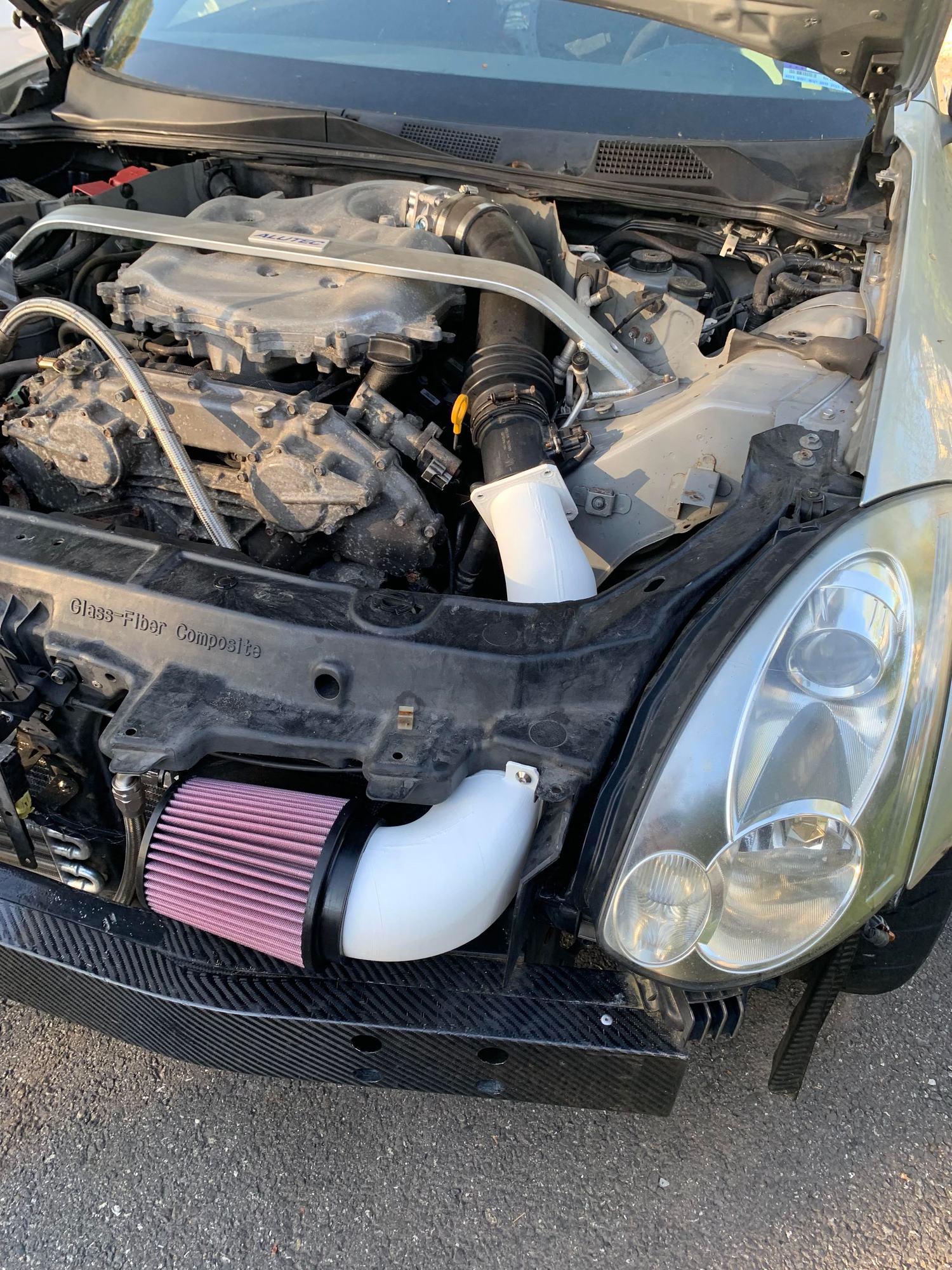

I now have a perfectly fitted prototype for a new intake tube, took a couple of tries, but fits great!
Now just need to come up with a bend and buy a well sized air filter, super easy:
Does anyone know what's about the maximum diameter air filter I can fit behind the grill? Has anyone done this before?
Old May 10, 2022 | 01:56 PM
  #21
Urbanengineer's Avatar
Joined: Jun 2013
Posts: 11,174
Likes: 1,045
From: OH-IO
I think you are in uncharted territory, and it depends on your bumper cover there. As long as it’s stock size I wouldn’t worry too much. Are you going to do a 350Z ram air bumper cutout? It’s like a little fancy hole in the front on one side lol.
Not sure, might just leave it as is and try to stick the largest filter I can right behind the grill for now. June is coming up soon and so is my first track day, if I pick up more projects I'll start running out of time and I still have a new LSD sitting in a box I need to install.

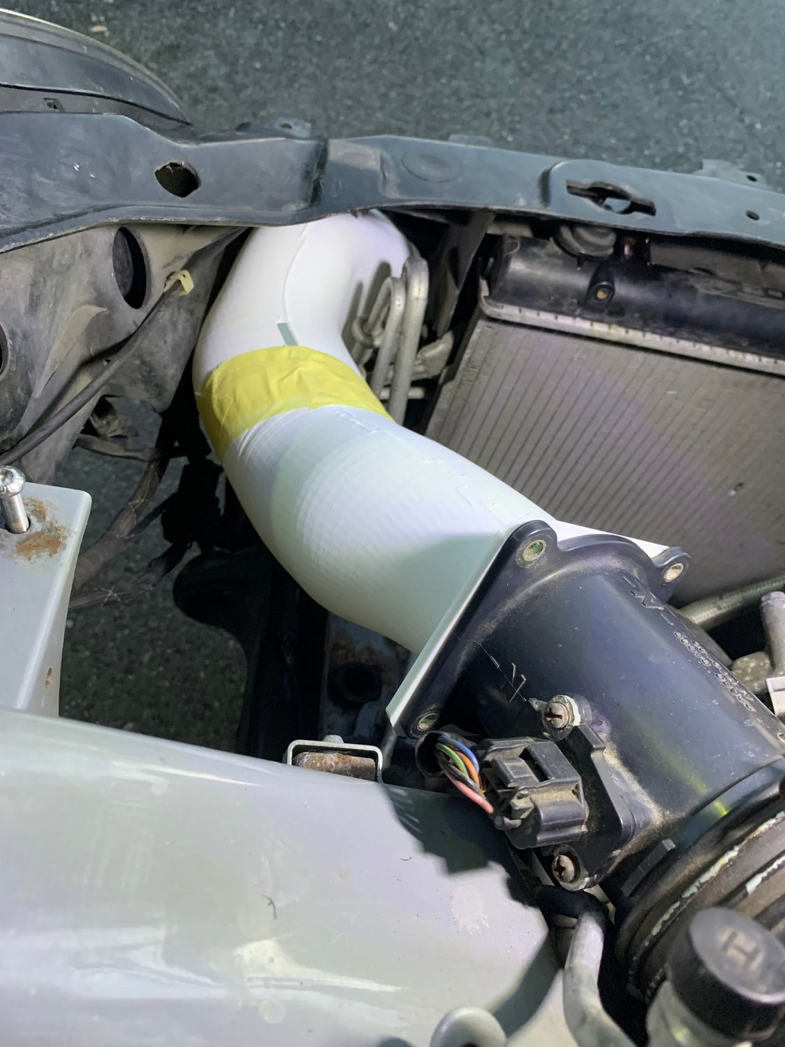

Almost there. The 3d printed prototype intake tubes fit nearly perfectly. Unfortunately this version doesn't allow the bumper to go on all the way....a few millimeters too tight. Need to adjust the drawing and re-print...but i'm almost there and will order the carbon fiber sleeve tonight so I can print these in ABS and get them finished in carbon asap.

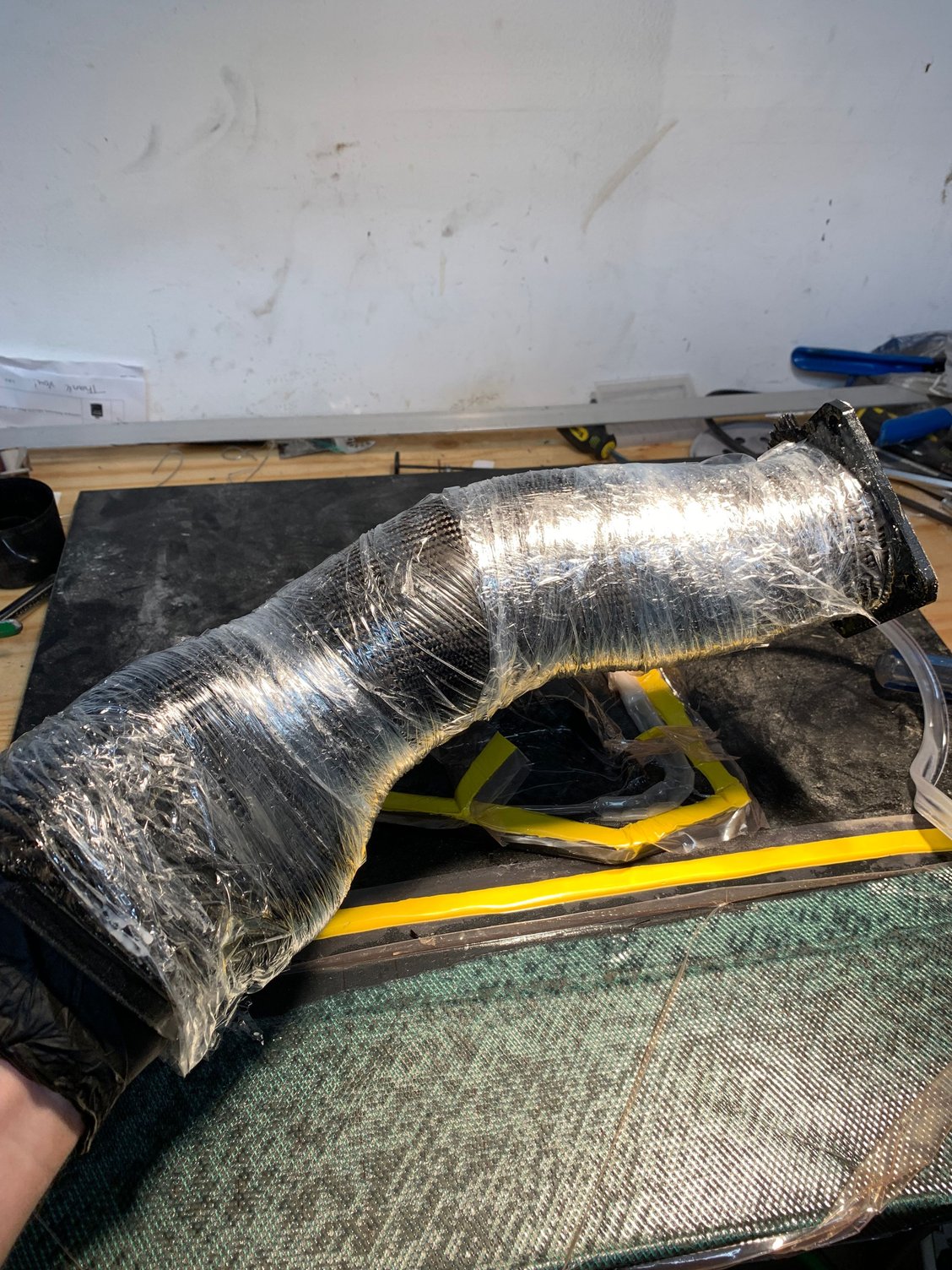

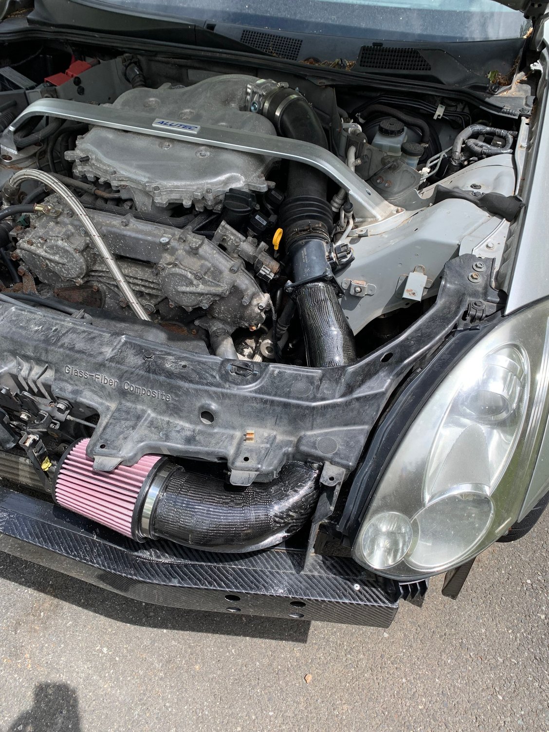

another step forward:

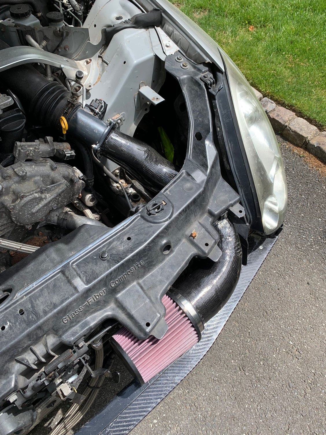

I printed the entire intake in ABS. I had no choice but to print the main tube in 2 pieces, so I used some structural epoxy to glue it together. :

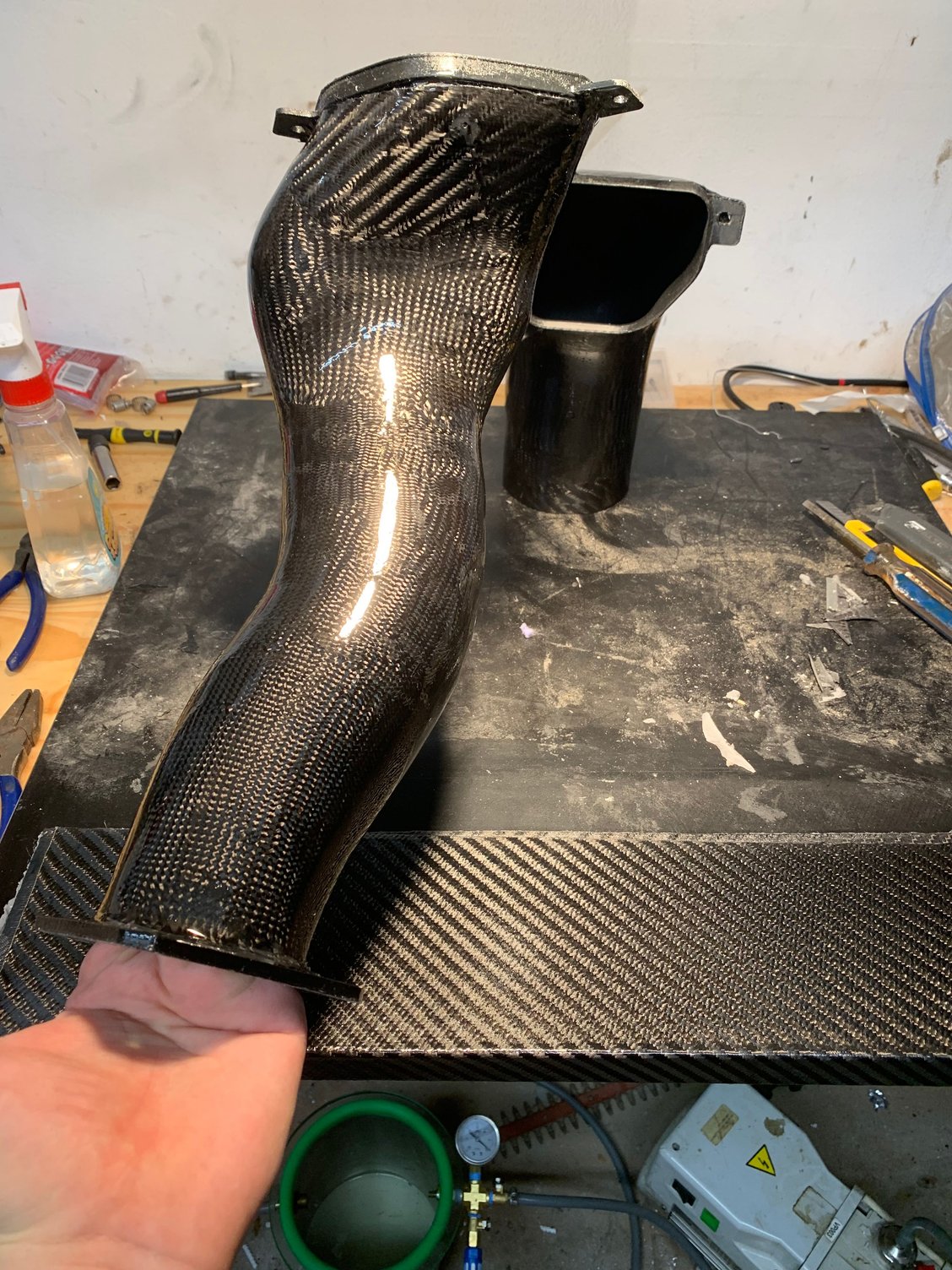

then I wrapped it in carbon by hand and applied resin with a brush. This time I didn't use infusion, because I want to keep this simple and fast, so I used some plastic wrap to keep the carbon tight-ish. In the future if I re-do this I have some ideas about how to make this entire part using a carbon infusion process.
Then I did a bit of sanding and applied a layer of clear coat. Install hopefully tomorrow once everything dries.
It's not super pretty compared to a lot of the other carbon work i've done, but it should be enough to give me the space I need under the hood for the vents

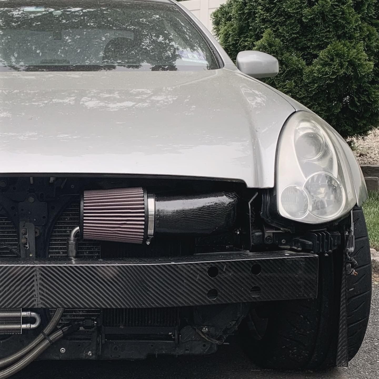

One step closer and looks good enough. Didn't think that this project will force me to make and install my own DIY cold air intake, but here I am
