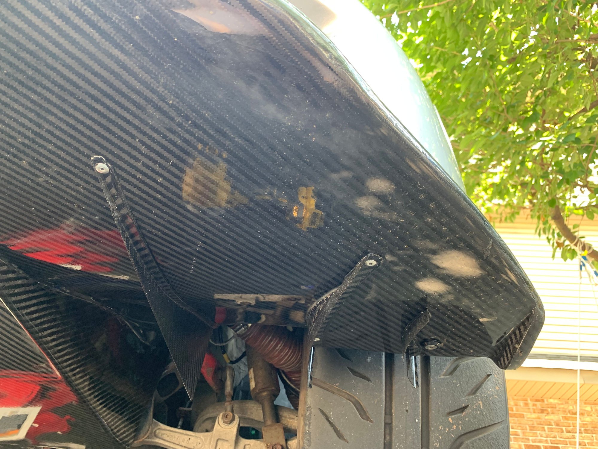

Last thing I've done before I put the car in storage was update and re-clear my front splitter...

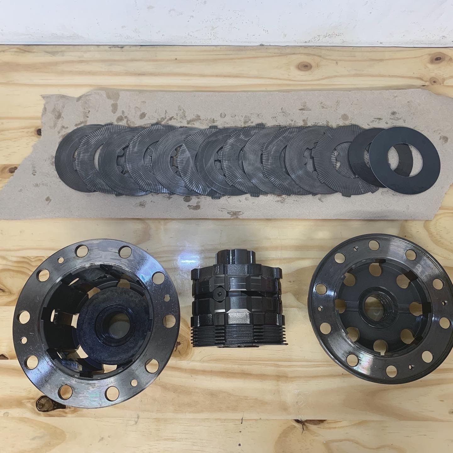

re-stack and install a Tomei LSD
