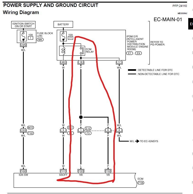

That's why I was thinking fusible link, one of those 15 amp fuses on the fusible link powers the ECM. It's full time powered even with the car turned off. However there's a few power sources that ALL have to turn on for the ECM to be talking on the diagnostic port.
Look on the back of the ECM, red wire white stripe. That's the full time power from the battery.
White wire/blue stripe is power from the key when the ignition is turned to ON.
Pink wire and blue wire are the power supply circuits from the IPDM ECM relay, powered when the key is ON.
Thank you, the red wire has power, however I cannot tell which white wire with a blue stripe to check or should they all have power? And is that the same with the pink and blue wire?

I had a better look, it looks like the white wire with a blue stripe is getting power. But the pink and blue ones are not, supposing I was looking at the correct ones. I also tried to swap around the relays to be safe but it didn't do anything

Check fuse 77 in the IPDM, the pink and blue wires is the power from the ECM relay to the ECM.
The fuse is good, I swapped it just to be safe and checked for power, it is getting it. But there is no power to wire 18, the pink one, I checked both on the inside of the panel and on the outside of the connector. I also checked the relay, it has power when the battery is connected but when turned to on there is no change. Is there anything else it needs before it can send power out or should it just have power?

The line side of the relay for both the coil and the contact will have power (part coming from the fuse).
The load side of the coil is actually a ground wire essentially, the ECM closes the ground which then energizes the coil (spiral thing on the relay picture) it's just an electromagnet that pulls the contact (the not connected bar on the relay picture) down to make contact across the line and load points.
I would try a new ECM relay.
