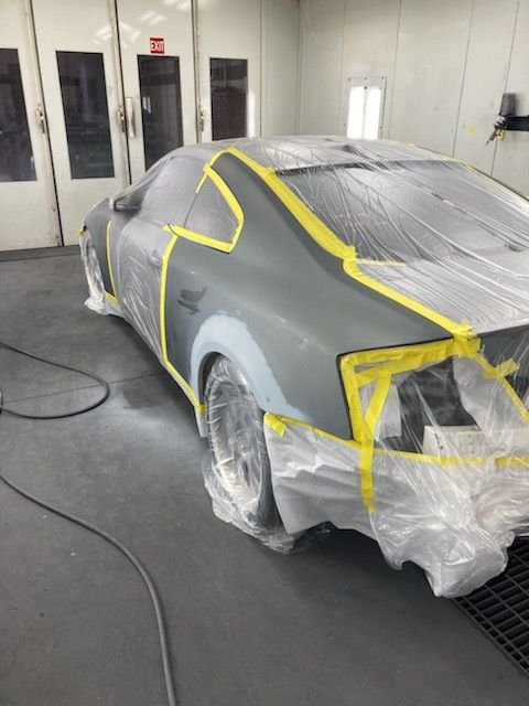

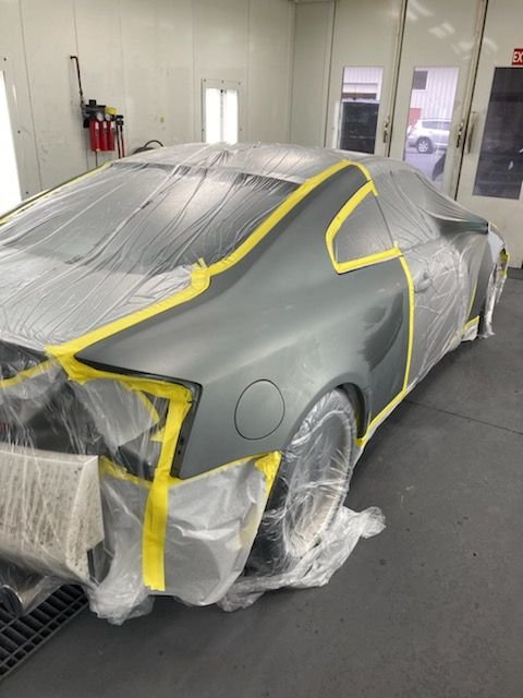

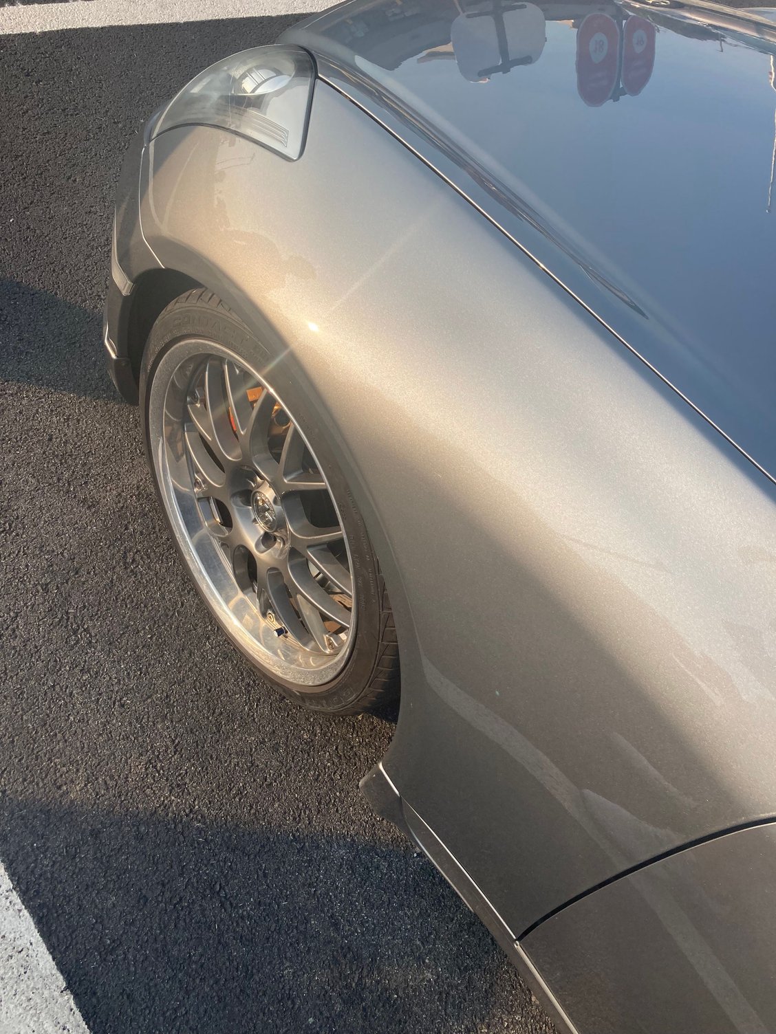

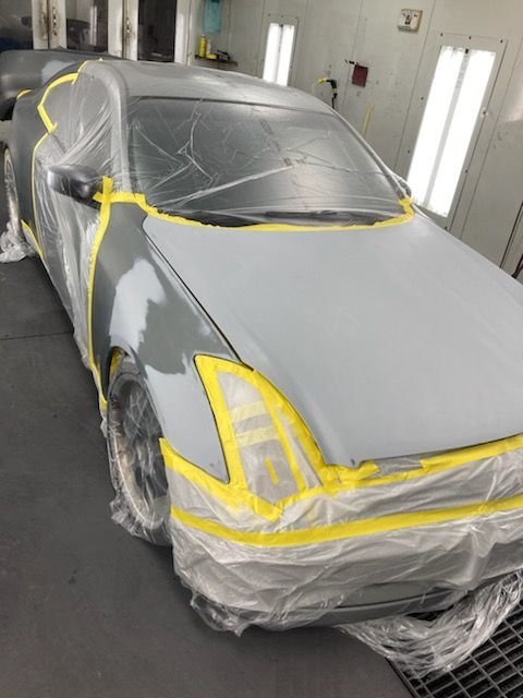

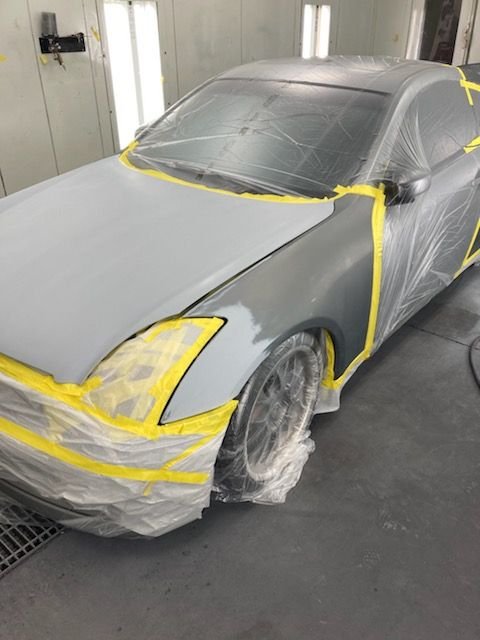

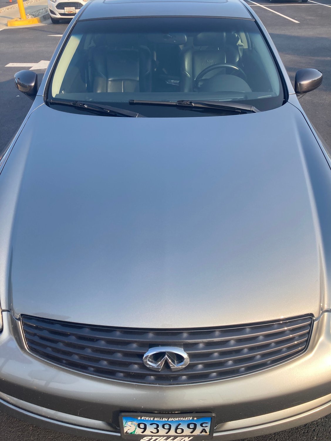

So, quick update on the work.
Everything turned out great. Actually too great…
The new paint looks so good that I asked my buddy if we could just do the rest of the car as well…
So, dropping her back off on Sunday to get the rest done while I’m away next week. Will be a great present to come back to and I can justify that it is better to drop a few thousand than 100k on a new one 😁
I’ll take some pics shortly, but overall it looks amazing,
Cleric - I will probably end up doing the clear bra just because you only get a chance to do this right once, I did the clear bra full front on my black FX50S and couldnt be happier. Keeps the car clean, eliminates swirls on the black paint and of course absorbs all of the road punishment. It wasn’t cheap, but I can’t say it wasn’t worth it.

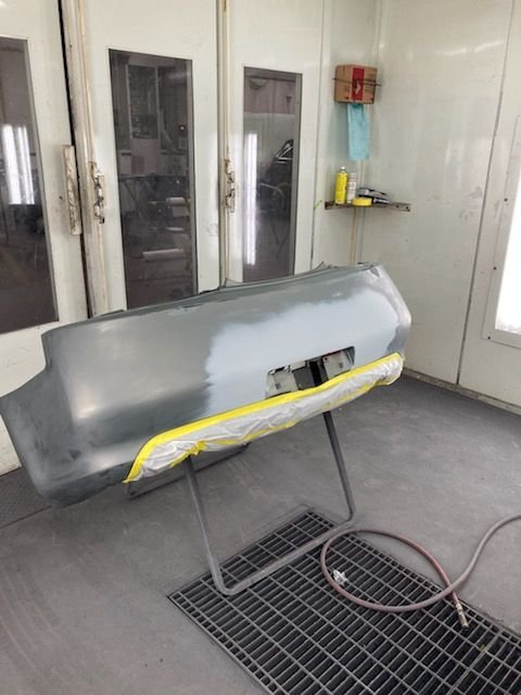

Old Sep 20, 2022 | 08:33 AM
JZ39's Avatar
Joined: Jan 2005
Posts: 936
Likes: 53
A couple of quick pics so far…
Clean!
Will post full pics once the work is done. Unfortunately I wasn’t able to drop her off before I left for travel, so it’ll be two weeks now before everything is done.
