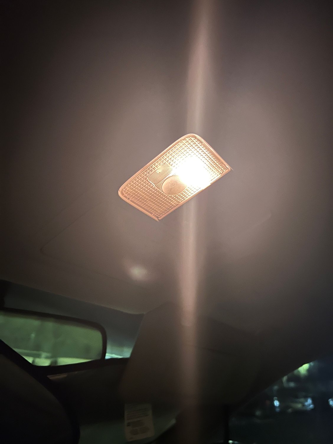

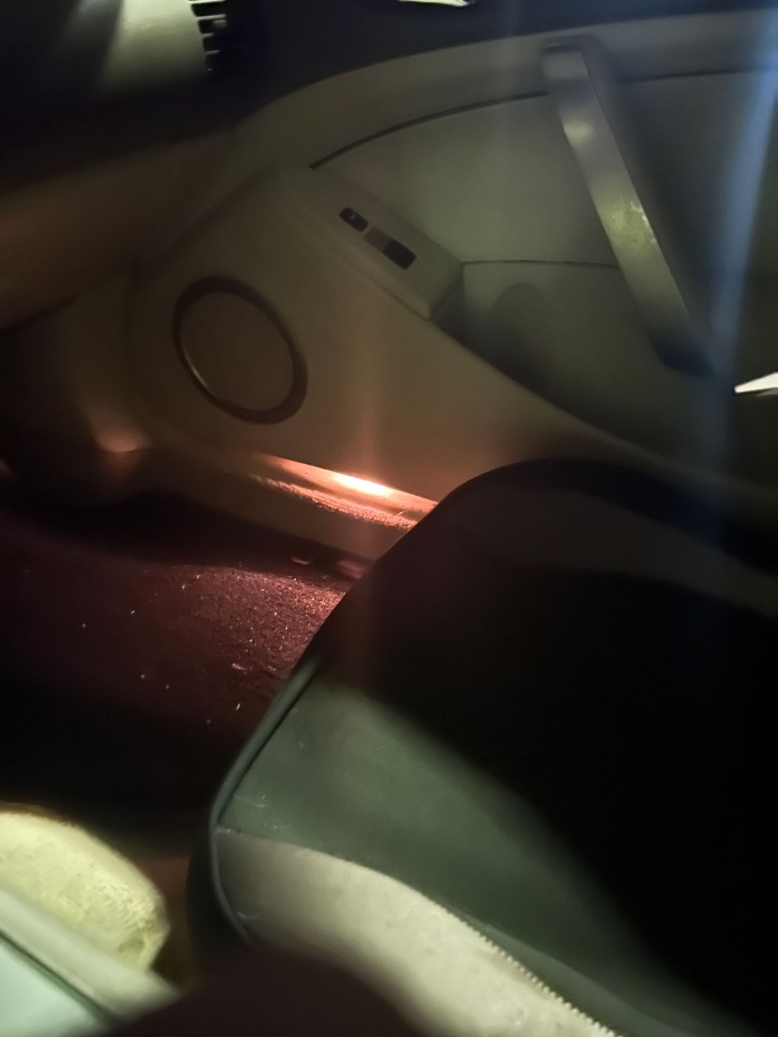

Good evening g community, I’d love some feedback. My2005 g35 coupe died on me recently and I jumped it and it worked, however when I turned it off it died again. I suspect it could be alternator or circuit relay cuz I changed the battery a couple months ago and put new spark plugs in like 2-3 weeks ago and installed a a new fuel pump little after spark plugs. It’ll jump but not hold a charge it seems.
Battery isn’t completely dead I can still turn on lights
