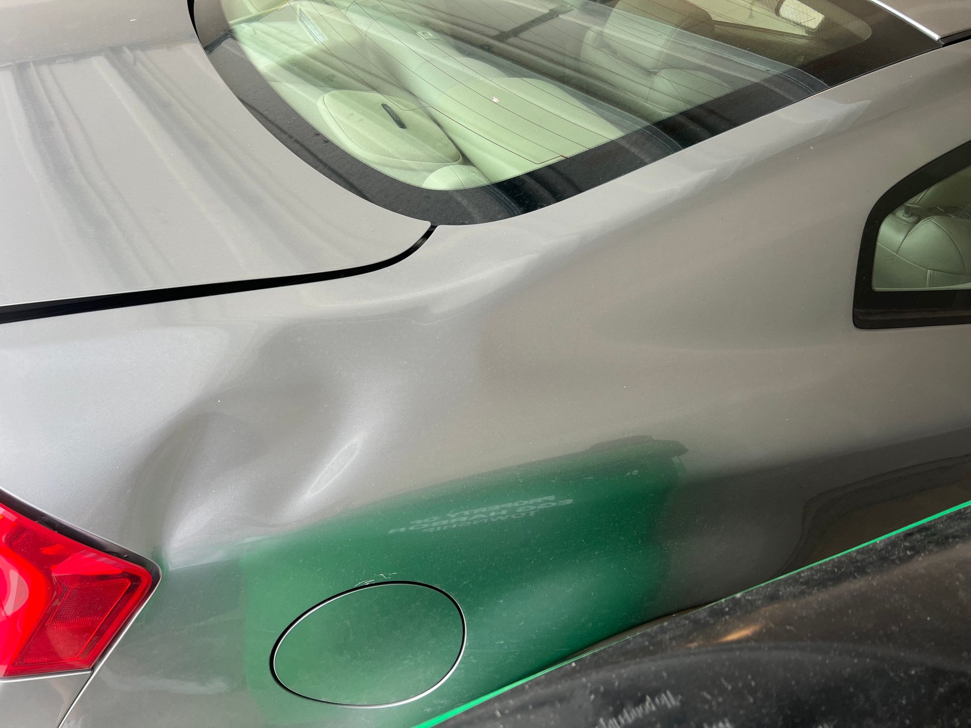

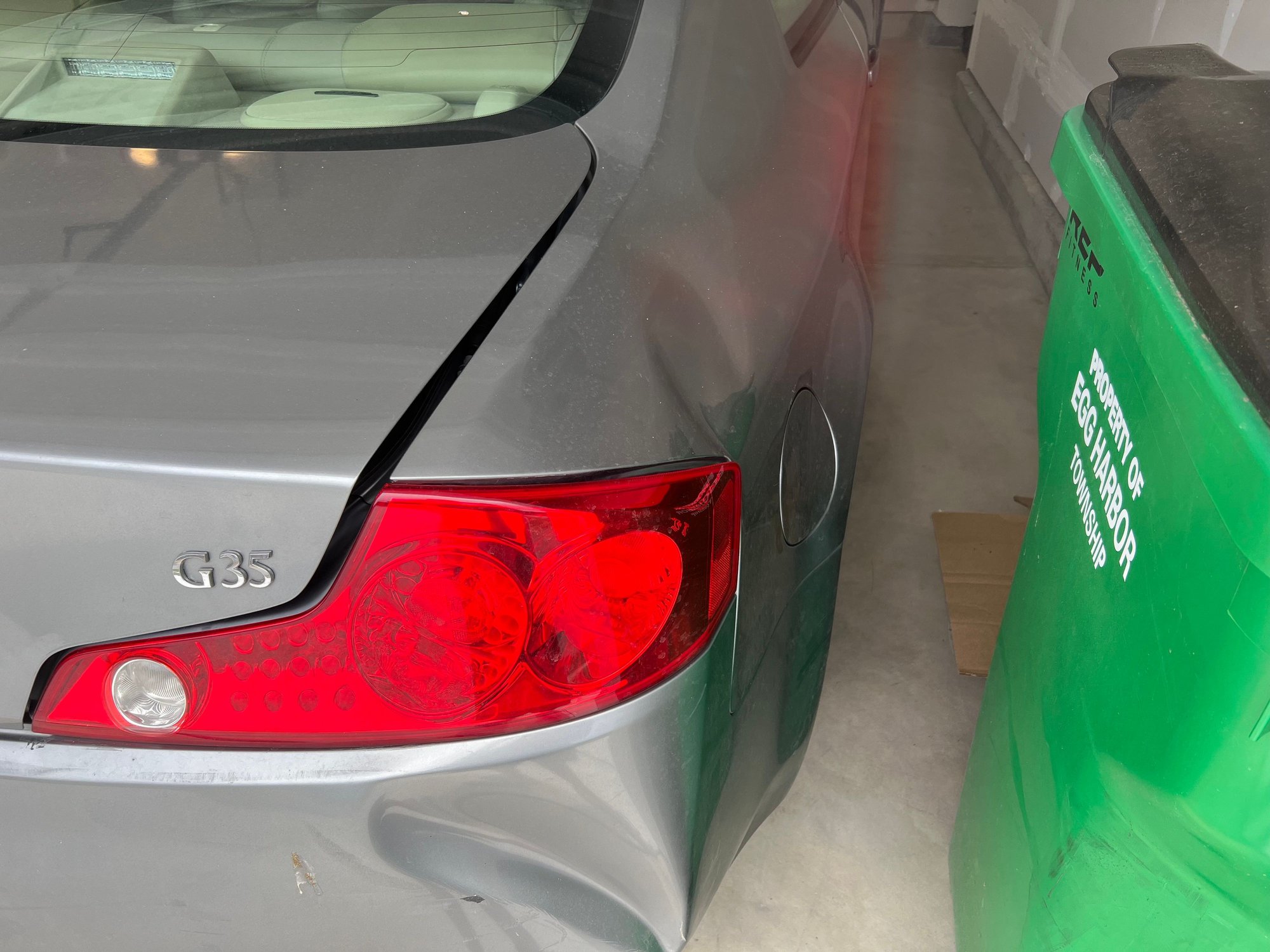

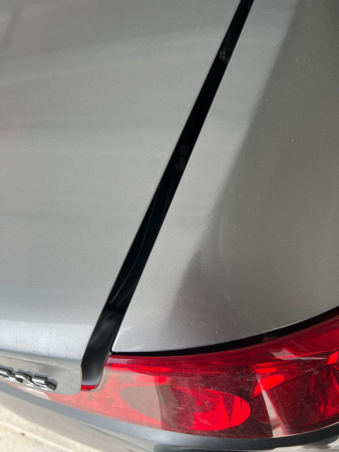

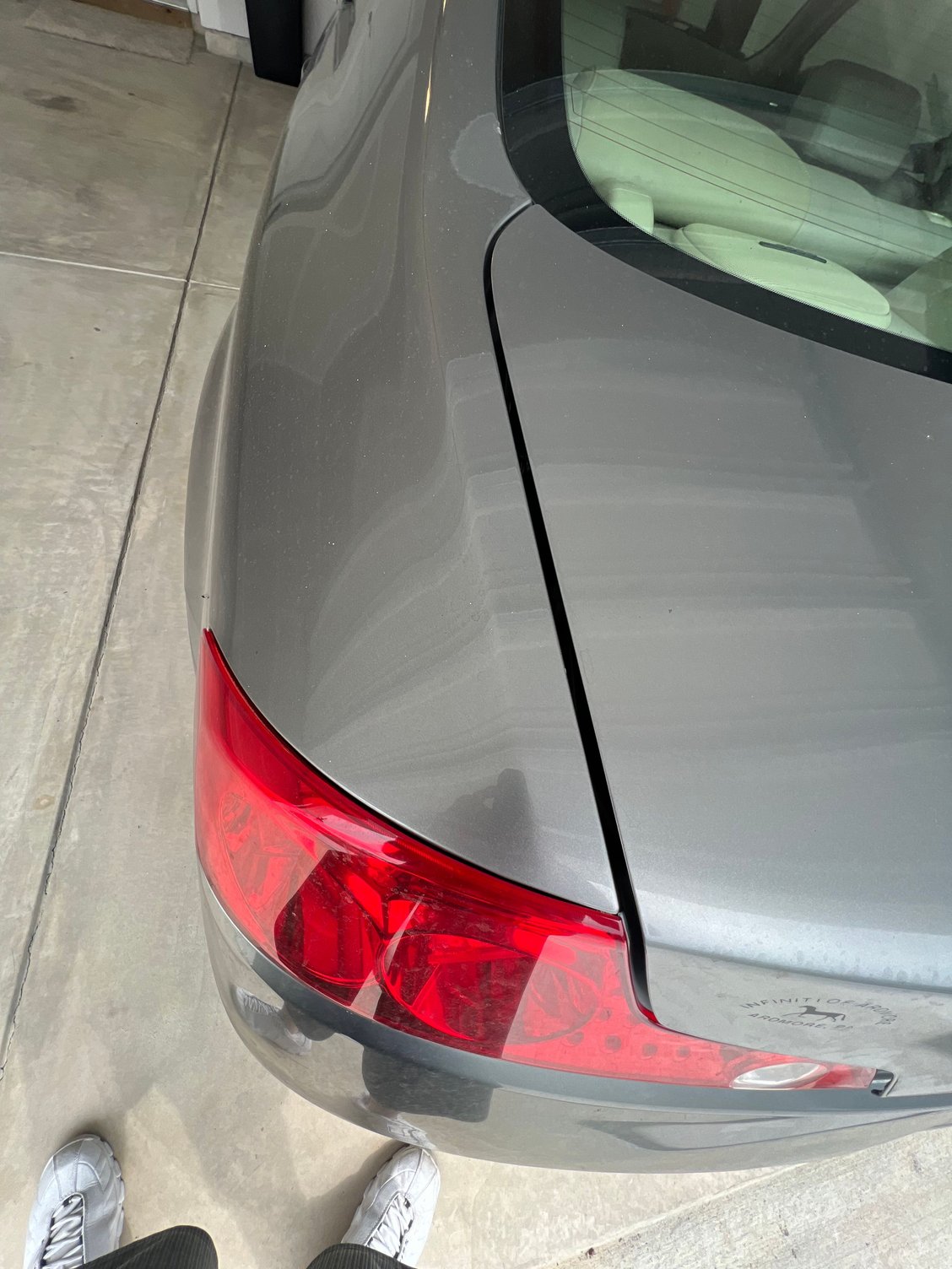

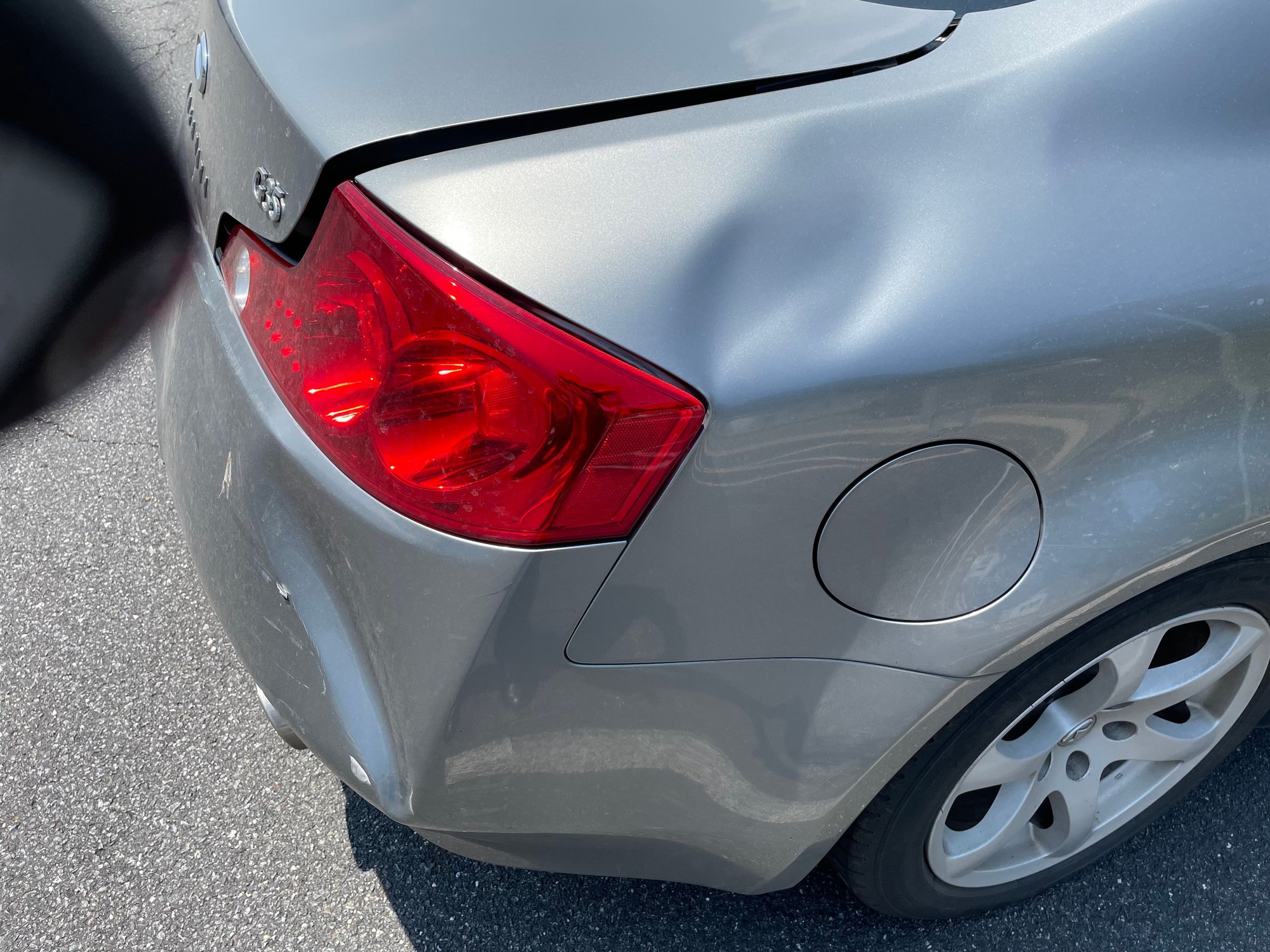

So…. My Baby 2003 G35 coupe was rear ended by some little punks a few days ago. I was stopped in traffic but I guess they figured they didn’t have to stop? Because of her age and mileage (almost 210,000) my fear is they will total her. I can drive her but the bumper is screwed and rear quarter panel pushed in so trunk is screwed and if it rains well it will be a mess. She sounds off too so I don’t know if he messed up my Borla or if the rear is pushed in or maybe driveshaft. My heart is broken because I am her original owner….. I drove her brand new off the lot February 14, 2003 and she is my best friend. A few people told me to sell her as is instead of fixing or making a claim. My insurance company is aware of the accident but no official claim is filed because I need the police report which isn’t available yet. I think I will die if they total her and I don’t know about getting a salvage title. I was thinking of stopping driving her daily and putting classic tags on her but now that’s out the window. Any suggestions?

Damage is probably more than her blue book value at 20 years old and over 200K. I know I will never get money out of the kids even if I tried

this is not much. i have used a Craigslist body shop guy to fix dents like these for reasonable prices. a fully licensed body shop paid by insurance will not do it.
You just need to reach out to those who advertise body work on Craigslist and send them a photo. some of those folks are real artists and will come and pull the dent out, use some bondo and fix up the shape and all that for a few hundred bucks.
You can then respray with some paint or have them respray if necessary.
Here is a link that will give you more confidence. I got it done for my Boxster about 2 years ago.

+1 to what vkmotorsports says.
​​mobile guys can pull the dents out and bondo from there.
Paintscratch.com has paint kits or you can have someone do it. The work will still be a chunk of change, but you will keep your car. Insurance companies are evil.
Make sure the complete bondo-paint job gets done, rather than hiring just a dent guy.
if you do paint her yourself, this is your chance to learn some new skills..
You can always get a one stage paint job done later..

There's nothing legally obligating you to get insurance involved, I can practically guarantee they will total the vehicle out. 90% of that damage can be pulled out via paintless dent removal, your rear crash bar probably needs to be replaced but that's just a bolt-on piece. A come-along, some straps, and a good tree can make a lot of frame corrections but the hardest part will be getting the trunk to latch and have an even reveal all around it. It won't leak because water doesn't need to be sealed out of the trunk, there's a channel all around the trunk opening that diverts water, open the trunk, put a hose on the rear window, watch how the water cascades off around the trunk opening and you'll see what I mean.
You can also take it to a local body shop and have them give some advice on how to correct/straighten it. Just offer to pay for an hour of labor for them to look at it and give you suggestions on how to do it yourself if you want to fix it, usually worth the $125 to get a professional's advice before jumping into a project like that anyways.
If it's your baby then fix it back up, it's just metal, you can bend it back.
