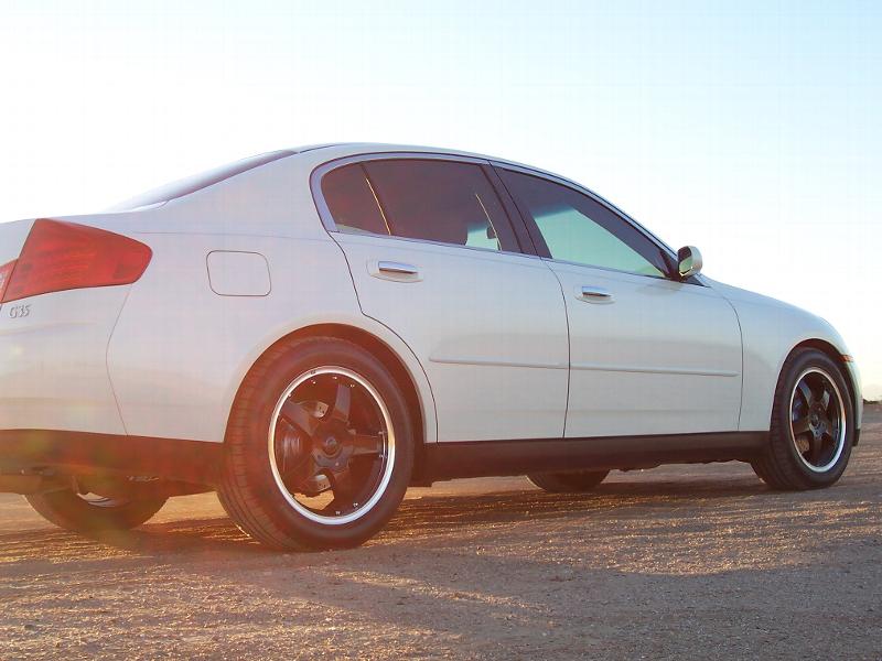

Any pics of upsized tires instead of a drop?

Just put in 255/45/18 on the rear. Ride seems quieter on my '04 5AT. May go with 235/45/18" on the fronts.
