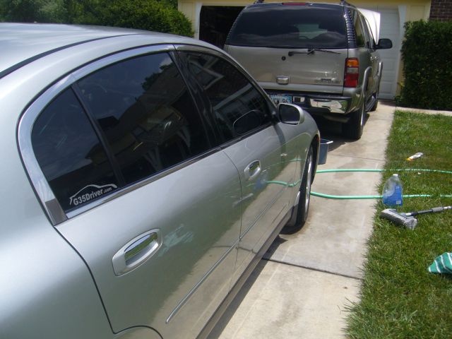

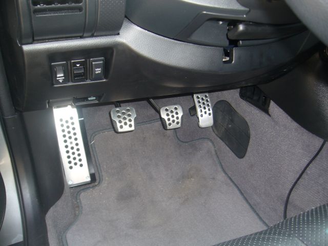

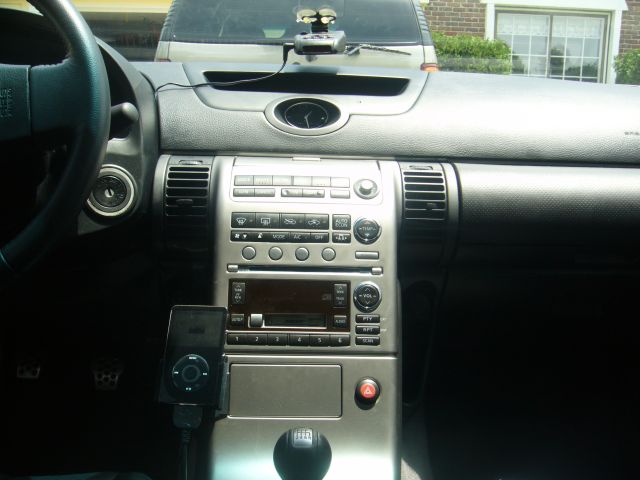

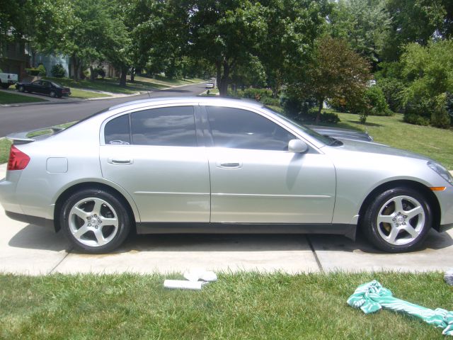

I have finished up my first batch of mods that includes aluminum sport pedals, a 20% tint, clear corners (not installed but on order) and the PA11-NIS.. What do you think?

looks good. How is the sound quality with the ipod adapter?

indeed. curious about the sound quality as well.
will the unit you have installed work with an '06 non-bose system too?

I think its great, the volume is a little diminished so you need it to be around 15 or so but I think it sounds great and controlling the ipod through the stereo controls is so handy. I am pretty sure it will work on a non bose, I dont think the speakers should mattter

Compatibility & Notes:[These requirements must be met for this part to work]
1. Compatible with listed 1999-06 Nissan/Infiniti factory radios with external Changer controls.
2. The PA11-NIS does NOT interfere with the in-dash 6-CD Changer radio.
3. The Nissan/Infiniti radio MUST have a 12-pin Changer connector on the back of the radio AND the correct button on the radio face [see footnotes for more details]
4. Vehicle cannot be equipped with an external CD Changer or factory Satellite Radio (your must disconnect them to use this interface).
5. Text and display information remain with the iPod (in Direct mode). The Nissan/Infiniti radio will NOT display Text. You will see playlist and track numbers only.
6. Click to enlarge picture detail
Footnotes:
Radio requirements [please check your radio before ordering---if the radio does not meet these requirements the PA11-NIS will not work]
¹ Must have "CD" button on radio face
² For double-DIN radio with CD/CHG button only
³ Must have "CDC" button on radio face.
Compatible with Navigation radios but not compatible with factory installed Sirius or XM.

so im guessing that based on the info provided, this would not plug into the cable usually found behind the carpet in the trunk, but behind the radio itself?

Yea, it plugs into the AUX input in the back of the stereo
