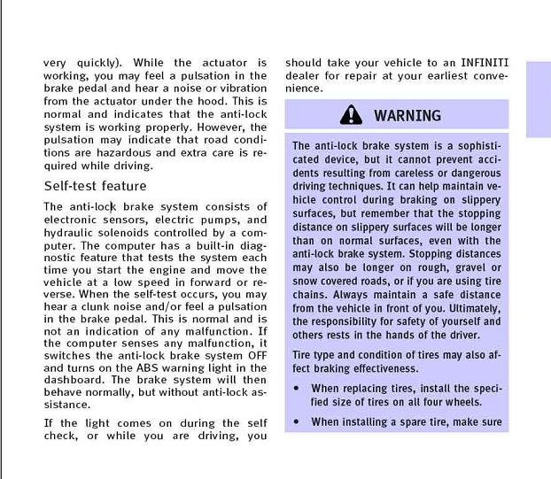

Are you perhaps taking about the ABS self test? When you first start the car, shift into Drive and accelerate, when you get to 10 mph the ABS system does a pressure check that sounds like a "click" from the engine compartment. The following paragraph is from the FX35 manual, but its the same thing in the G35.

If the click only happens once when you first start out, then I would bet its the ABS self test. If it happens more than once during your drive, its something else...get it checked.

the abs makes kind of a thud and only does it once
