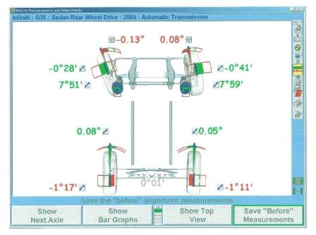

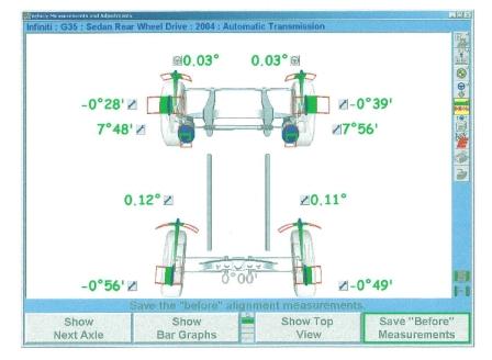

Old Aug 27, 2007 | 01:59 PM
clinthammer's Avatar
Joined: Aug 2006
Posts: 1,171
From: Dubai, UAE
these were my alignment scans - before and after
Attached Thumbnails Car veers to the right-beforealignment.jpg   Car veers to the right-afteralignment.jpg
Old Sep 10, 2007 | 08:24 PM
MrPutzy's Avatar
Posts: 127
From: Cocoa Beach, FL
Cool scans. Where did you go to get those done? never had an alignment shop ever offer such a thing to me.
