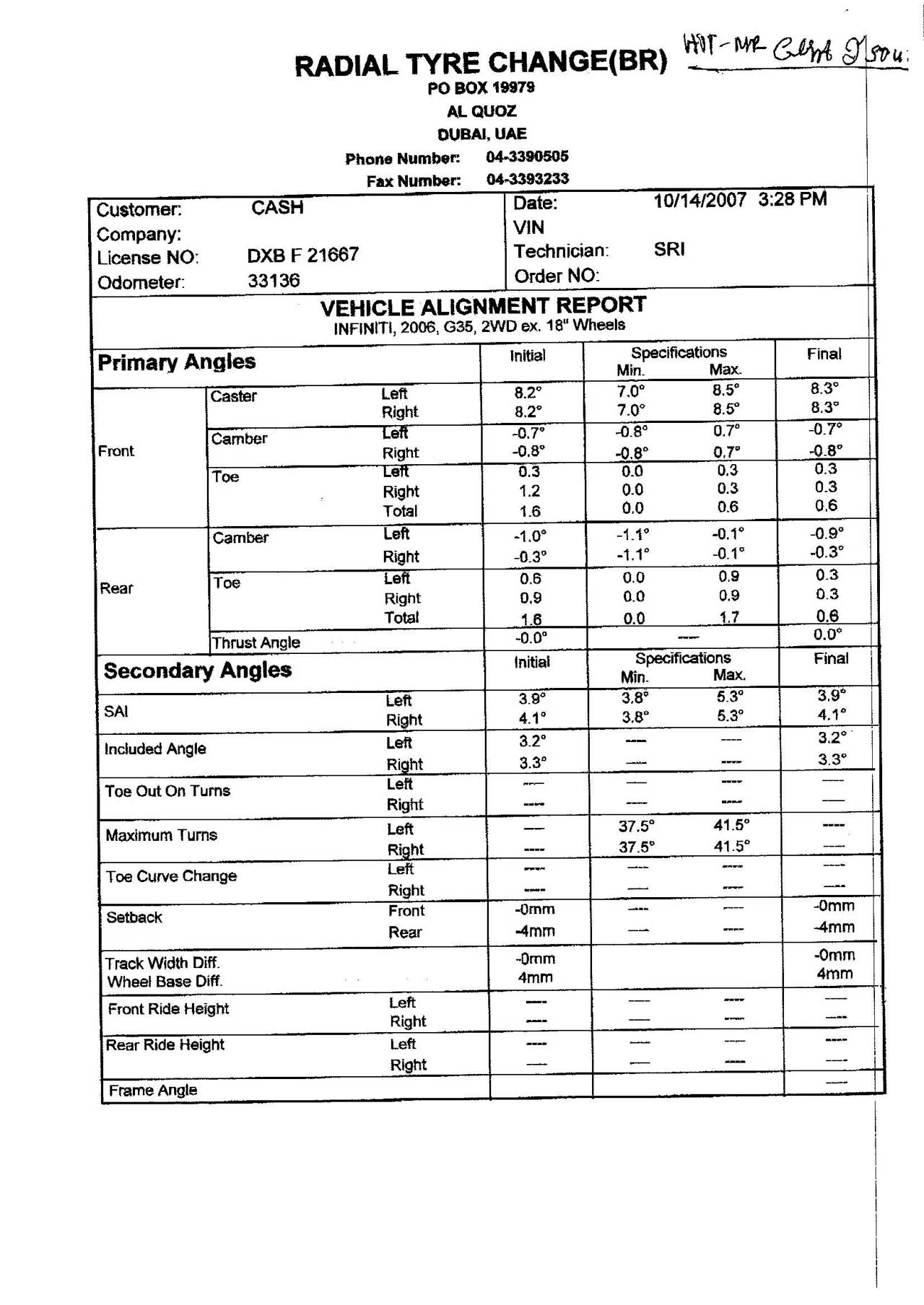

can someone look at this report:

the report above is from the alignment yesterday. they said they cant do anything more to correct it ( i dont want to force them too) and these guys are reputed.
I have given the report to Infiniti dealer here today so lets see if they can point out any errors.
I did. Questions or comments?

Your alignment looks ok, not great. The toe is very even... remember that when you get in your car, the wheels will toe out, and camber out a bit too (on your side specifically). You do want the SAI to be as even as possible or your car can drift, but I don't think that's adjustable, so that shouldn't be the problem. My guess is it's the camber...
