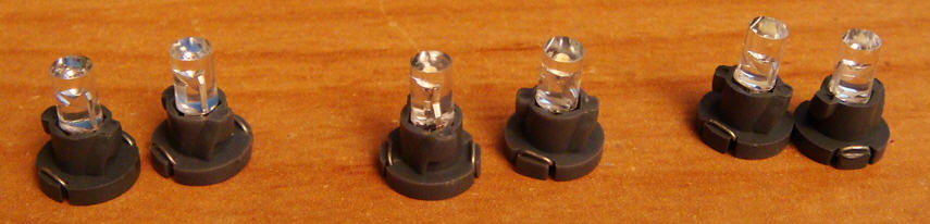

I got these LED replacements - 2 Blue, 2 Amber and 2 white. I figured since I was going to order them over the Internet, I might as well keep some options. I haven't installed them yet so I'm still not sure what colour to go with.
Where did you order these from?

I got mine from Autolumination.com, this page: http://autolumination.com/74.htm They don't have wires one them. I don't know what the lights from Digital1986 are for, but they won't go in an 03 clock?!?!
They are grain of the wheat and they worked fine for me. They are installed my clock has light and is working!
The ones you have might be brighter though, did you get type A, B, or C?
