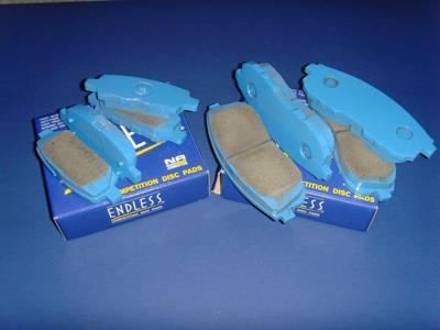

Originally Posted by Offdahiizzy
Just got my Hawk pads from Tire Rack and found an installer. Anything I should tell them that they might neglect to do?
I saw this thread too late...I was going to tell you to go with the Endless Vita Nuova pads. I ran the Hawk pads and I was very unhappy with them. The pads squealed a lot when hot (after regular street driving). This occurred even after I bedded them properly. Also, the initial cold bite sucked major! I felt more confident using OEM pads than I did the Hawks.
I would recommend that you get the Endless pads if you have the extra money to spare. I've had them on for about three weeks now and I can tell you they are leaps and bounds over the Hawks, but you get what you pay for.
If you decide to keep the Hawks, make sure you take the shims off of your old pads and tuck them away b/c you will need them later when you want different pads than the Hawks
If you decide to go with the Endless pads, talk to Eddie Takahasi from www.mynismo.com. He is a good guy to work with and shipped my pads out fast!
