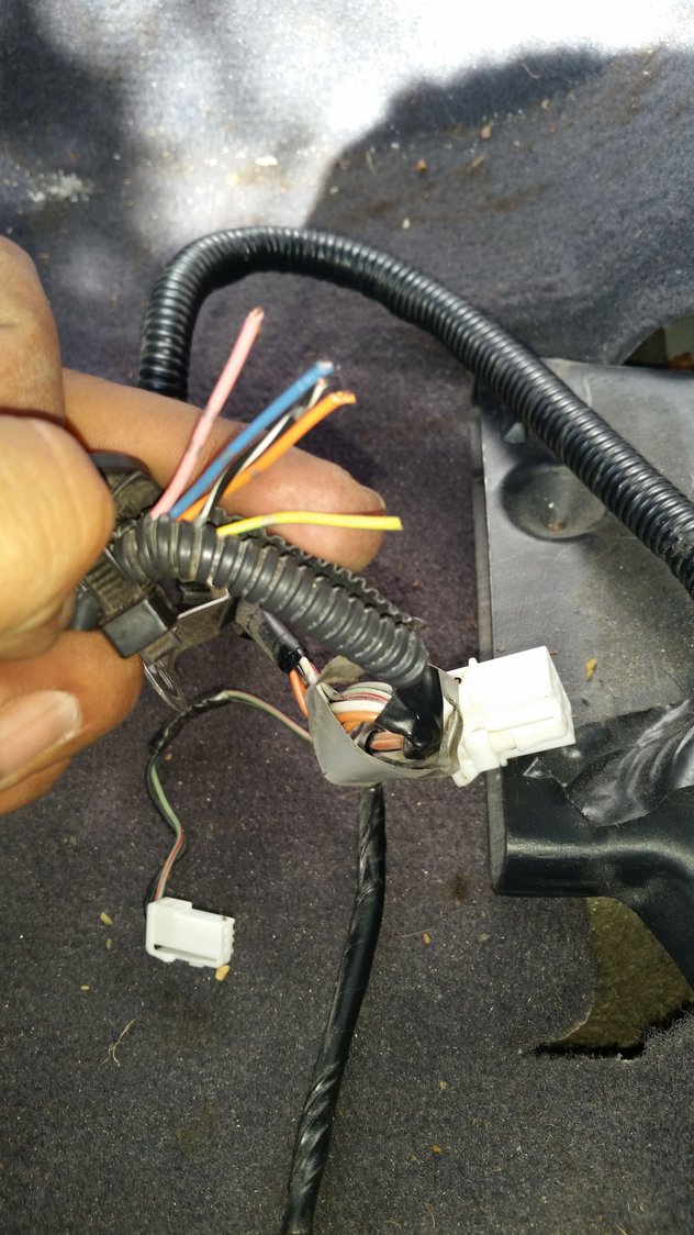

g35perez's Avatar
Joined: Jan 2016
Posts: 15
Ok i took this pic under the passenger seat , i hope u can see it and know what is that white plug for and the wires they cut

Good news: the white plug is power seat harness, just use a voltage meter to confirm it provides power; if it does then you can get power passenger seat.
Not so good news: looks like those cut wires are for something else. See if you can trace it and see where it goes. There might be some functions disabled by the cut wires.

Ok, dont quote me but im pretty sure on these. White plug is power seat, there is a 2 wire plug in front of white plug that is probably seat heater, your cut wires are probably for seat airbags and active headrest. Or i have it backwards and your cut wires are seat heaters and 2 wire plug is airbag/active headrest

Yeah that bunch of wires look like my cut wires, but there are only 5 wires and on yours looks like there are 3 more wires, now i just need to know what are those wires for? ... thanks for reply frostbite, soon as i can am going to pull that seat and take a pic to post it here , thank u

Some points need to be cleared about your information. From the car there are 3 harnesses go to the seat: one for power seat motors and heater (big white one), a 2nd one goes to the seat belt buckle (small white, 3-wire), then the 3rd one is yellow (2-wire), which goes to airbag. AFAIK the active headrest is mechanical not electrical, so there's no wire for it.

Ok, finally today i had some time to pull my passenger seat and this is what i found, the harness coming fron under carpet has 3 plugs ,one yellow and 2 whites ... one with 4 pins and the other ha
s only 2 pins, but also i found some wires with a plug , the question is what are those wires for?. . Are they part of the seat harness or its for something else?
