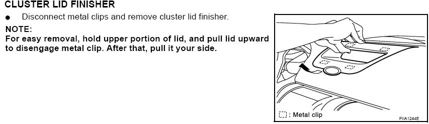

does the clock pull out directly or is it screwed from the inside .??
Old Dec 8, 2007 | 01:54 PM
EM3RGY's Avatar
Posts: 4,172
From: Laurel, MD
on the 03/04 you have to pull out that plastic shroud around the clock and climate control display. then there are just just two screws holding the clock in place.

The actual clock is screwed in on the back. You need to remove the entire climate control/compass trim to access the back of the clock. Grab the top ledge of the trim and pull up and towards you. It is held in by two clips on the top and some on the bottom. Then you can unscrew the clock.

Originally Posted by GixxerSteve
^^ beat me.
thnx gixx and diablo ..

pull the trim piece out towards the back of the car. not up. you have to pull REALLY hard and its hard to get a good grip on it.

It help to push something flat (and covered with cloth) in just below the bottom on both sides.
